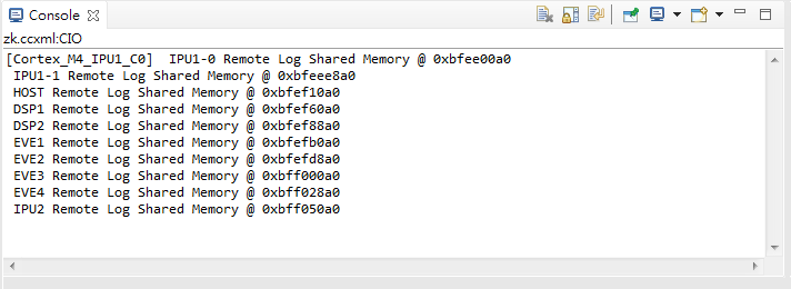

I'm running PROCESSOR SDK VISION v03.04.00 rtos on tda3x custom board.
Enabled DCAN_INCLUDE in cfg.mk.
Tda3x load using CCS, the console logs is correct at run the core.

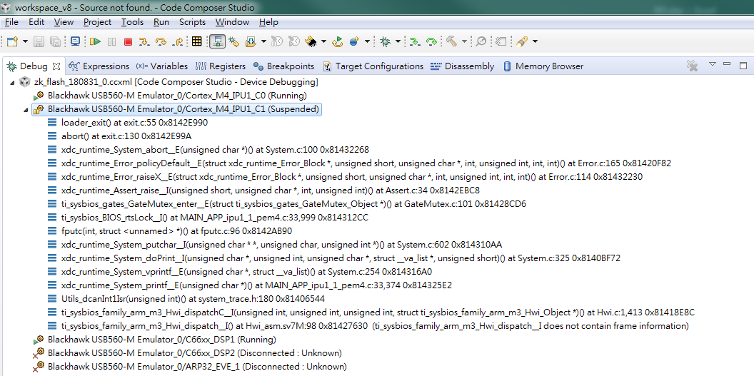

But Sending dcan to tda3x continuously at startup will cause an error.
(PC tx → tda3x rx)
See below:
