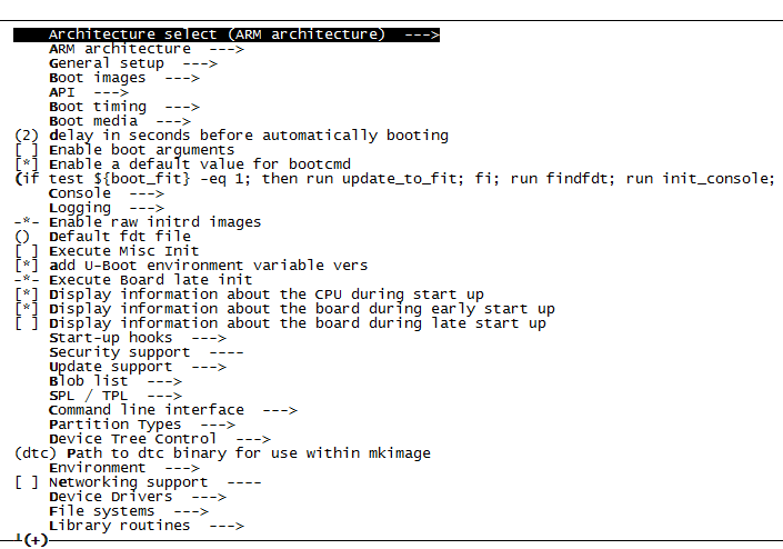

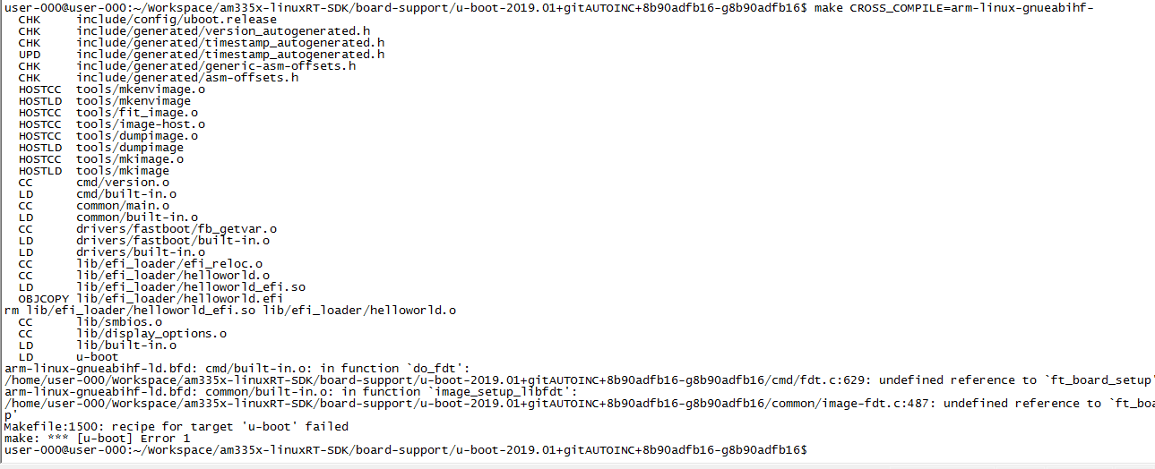

The customer remove networking support in menuconfig and then rebuild uboot failed.

  • Only remove networking support from menuconfig.
  • Nancy,
    When you remove network support (with menuconfig or from am335x_evm_defconfig), you are removing ft_board_setup() function from u-boot/board/ti/am335x/board.c file.
    Thus you need to remove ft_board_setup() references from below files:
    u-boot/cmd/fdt.c
    u-boot/common/image-fdt.c
    You need also remove "CPSW platdata" from u-boot/board/ti/am335x/board.c file. Thus you should be able to build u-boot images successful, but note that I did not tested how these u-boot images work on AM335x board.
