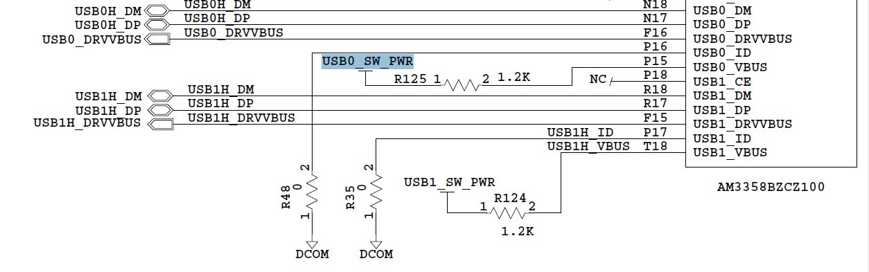

AM3358: USB Host without DRVVUS
Part Number: AM3358
This issue is similar to the previous thread https://e2e.ti.com/support/processors/f/791/t/472060
On our circuit board, the VBUS is connected to 5V always. We tried the instruction described in the thread mentioned above, still could not make the host work----VBUS_ERROR is reported.
The SDK is 5.02. The log is listed below.  Should we make additional changes?  Thanks,

[   29.194511] musb-hdrc musb-hdrc.0: VBUS_ERROR in a_wait_vrise (80, <SessEnd), retry #3, port1 0008010c
    Is AM3358 USBx_VBUS pin connected to the 5V as well? Please share the USB portion of the schematics.
  • Hi, Liu Bin,
    AM3358 USBx_VBUS is switched on to 5V (e.g. USB0_SW_PWR in the attached schematic) before the USB ports initialization.
  • Hi, Liu Bin,
    USB0_DRVVBUS is configured as GPIO, not the control signal as DRVVBUS.
  • Hi Peng,
    It seems the schematic has no issue.
    Did you set USB0 dr_mode to 'host' in your board device tree file?
  • Hi, Liu Bin,
    We set the dr_mode to host.
  • Hi Peng,
    Please apply the kernel patch attached below and let me know if it solves the issue.

  • Hi, Liu Bin,
    Our SDK is Rev 5.2. So are there any patches applied to SDK 5.2?
  • Hi Peng,
    Yes, the kernel attached above is for the kernel in SDK v5.2. Do you run into any issue when applying this patch?
  • Have you checked the mentioned 3 patches are already in the SDK v5.2 kernel.
