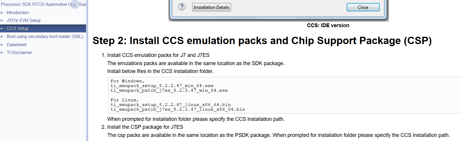

    I've already read the guide.
    Does PSDK means PSDKRA?
    I want to know the csp package's file name or path.
    install the CSP package for J7ES
    The csp packs are available in the same location as the PSDK package. When prompted for installation folder please specify the CCS installation path.

    PSDK here implies PSDKRA. Please see below instructions:
    Rishabh
    I have already read the guide before asking questions.
    The point of my question is that csp pack cannot be found in PSDK installation path.
    instruction
    Step 2: Install CCS emulation packs and Chip Support Package (CSP)
    1. Install CCS emulation packs for J7 and J7ES  (already installed, done)
      The emulations packs are available in the same location as the SDK package.
      Install below files in the CCS installation folder.
      For Windows,
      ti_emupack_setup_8.2.2.47_win_64.exe
      ti_emupack_patch_j7es_8.2.2.47_win_64.exe
      For Linux,
      ti_emupack_setup_8.2.2.47_linux_x86_64.bin
      ti_emupack_patch_j7es_8.2.2.47_linux_x86_64.bin
    2. Install the CSP package for J7ES
      The csp packs are available in the same location as the PSDK package. -> what is the file name? I can't find it.

    CSP package is auto_rvp_rsp_device_support_1.0.5_J7ES_beta.zip.
    Install instructions are given in csp_install_readme.txt.
    Both of these can be downloaded from mySecure page.
    Hope this helps.
    Rishabh
    self-response
    I confirmed that the CSP package was not included in the psdk v0.9.
    The CSP package has been released as a separate package to account "MySecureSoftware". (2 days after the release of psdk v0.9)
    filename : auto_rvp_rsp_device_support_1.0.5_J7ES_beta.zip
