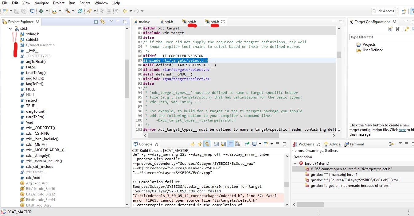

can u please help me out for solving the errors. thanks in advance.
regards
Hi Rock, no sure which version of acontis are you trying. But search in acontis documenation which Processor SDK version are you using. PSDK version will defying under which TI tools version this EC-Master was developed (SYSBIOS, XDC, PDK, etc). Please use tested versions as other combinations could break your building.
Also check your path to INC folder is correct inside Project Properties -> Directories
thank you,
Paula
Hi Rock, Industrial SDK 1.1.0.8, was released in Mid 2015. I would follow TI design EC-Master AM335x Software versions, as newer XDC and SYSBIOS have change quite a bit since them

Another option, is to use latest acontis EC-Master v3.0.0.19 release (you can download it from acontis-ti processors webpage) which uses a newer Processor SDK version
thank you,
Paula
Hi Rock, just to confirm, now you are testing EC-Master V3.0.0.19 SYSBIOS AM335x, right? And you installed PSDK4.2 (as I can see from your snapshot).
If so, please check both libraries (EcMaster and emllICSS) paths are correct in CCS project properties -> GNU Linker -> Libraries
If you want, for a quick test you can use the explicit path, instead of a relative path.
For example changing from ../../../../SDK/LIB/SYSBIOS/AM335x/Release/ --> to something like C:Acontis_EC_master\EC-Master-V3.0.0.19-SYSBIOS_AM335x-SDK\SDK\LIB\SYSBIOS\AM335x\Release\

Hi Paula.thanks for reply.
problem has been resolved, as in my project folder there were 2 sdk folder there.
