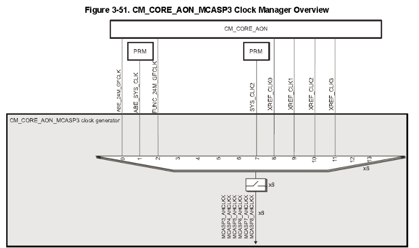

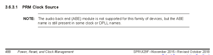

    Also, from TRM it appears, ABE is not supported in TDA2SX.
    Also, with above diagram, it appears, we have to configure the McASP clock to be derived from sys_clkin2. Is this understanding correct?
    We do not have crystal connected on sys_clkin2, however can get it mounted.
