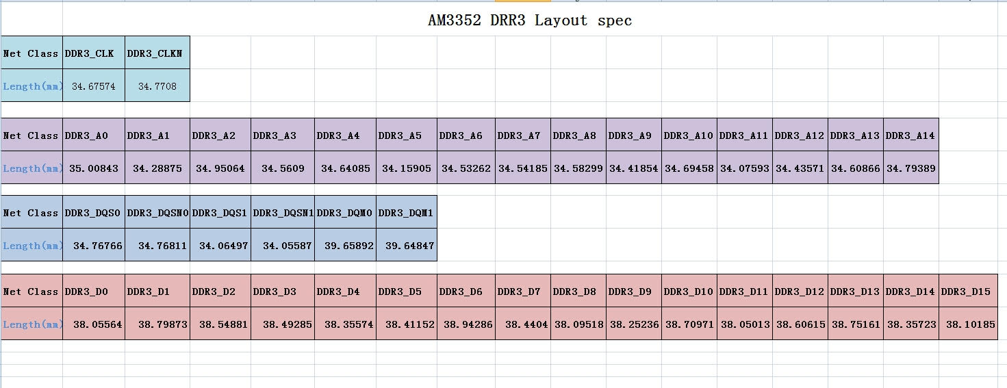

We're in now in a process of bringing u board on AM3352 processor.
Of a 3 boards that can boot into U-Boot only one is able to boot kernel reliable - two others are stuck at "Starting kernel" and can start only once in a while.
To boot device into kernel, some U-Boom ddr-deffs were changed. We're using one bank M15T1G1664A (www.esmt.com.tw/.../M15T1G1664A(2C).pdf). Current DDR defs are:

 EMIF parameters was calculated by means of excel spreadsheets that can be found here.
As we didn't have JTAG to run Software leveling from CCS we've used one that can be found via this lin
IOCTRL_VALUE vas found by trial and error method.
With this parameters u-boot mtest runs without errors on all 3 boards. command we were using: mtest 0x80200000 0x87000000

We have no clues on why it can happen with identical hardware and software.
Maybe there is some parameters we're missing in our setup? Now we have JTAG so we can test something more if possible.
  • Can you make a couple of  changes and try your test again:
    1. Change INVERT_CLKOUT=1 in the Ratio Seed Spreadsheet.  Make the appropriate changes in the GEL from the resulting spreadsheet.  Be sure to change all the values, including PHY_CTRL_SLAVE_RATIO
    2. Change IOCTRL_VALUE back to 0x18B
    Also, since you now have JTAG, can you run the debug script am335x-ddr-analysis.dss from this link:  http://git.ti.com/sitara-dss-files/am335x-dss-files/trees/master
    Instructions to run the scripts can be found in the README file found at the same link.  Post the results here.
    James
  • Hi James,
    At first, when I started debugging this issue I  tried both INVERT_CLK and  IOCTRL_VALUE  0x18B.
    With invert CLK were set  u-Boot(MLO) hangs just after DDR configuration.
    WIth IOCTRL_VALUE  set to 0x18B u-boot mtest fails with a lot of errors. This was the initial value I used.
    After running debug scripts for a couple of time we achieved different results.  You can find them via this link - drive.google.com/.../view
  • Hi James,
    I work with Bohdan who has been posting in this thread. I ran the JTAG debug scripts on two of the boards that were printed in the same batch. Attaching the differences we found between the output from them below for your reference.
    Board 1, we ran the test twice and these are the differences found in register dumps.

  • Hi James,
    Thanks so much for assisting my team. We have revised the routing values to the following:
    Full list of routing specs:
    Does this make more sense now?
    Appreciate your help a lot!
    Anik
  • Hi Anik, the trace length do look better, but i think you need to tighten up the skews a little more to meet spec (25mils = 0.635mm) .  For example:
    Shortest and longest in CK/ADDR net class is:  35.00843 - 34.07593 = 0.9325mm > 0.635
    Shortest and longest in DQ byte0 net class:  38.94286-38.05564 = 0.88722mm > 0.635
    There are others as well which i didn't detail here.  Also, don't forget DM signals are in the DQS net class, so those should follow the skew spec per byte.
    Aside from trace length, parameters like number of vias and center to center spacing is also important.  Please be sure to follow all the guidelines in the datasheet.  If you have questions, let me know.
    James
