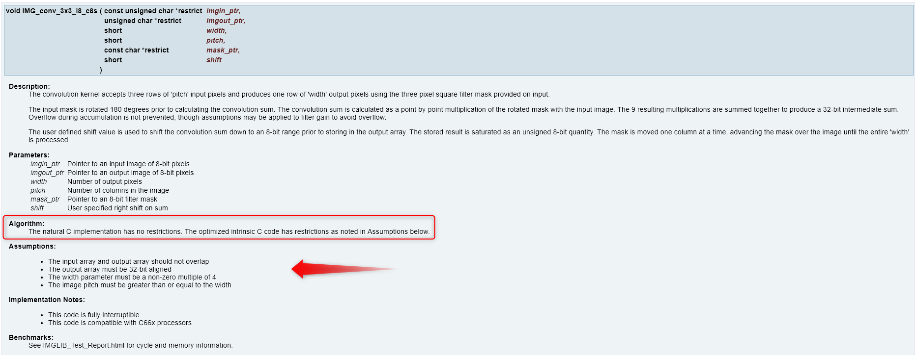

    HAve you tried to run the test vectors that are provided as part of the IMGLIB for IMG_conv_3x3_i8_c8s function. This will indicate how the mask needs to applied on the image and also if there are special alignment and input/oytput vector size restrictions for the function or also indicate how the images need to be padded to handle edge pixels. I hope you have check the API guide for these details:
    If the optimized version doesn`t work as expected, I would switch to the _cn (Natural C) implementation of the function, This will not have the same restriction for size and alignment as the optimized version. Also indicate what memory is the image stored.

    I have read the documentation and ti examples and I know how it works, I also tried to add two columns of zero  to my original image so that the width parameter could be multiple of 4:
        unsigned char  resultImage[(254)*(256)];
        int iter0=0,iter1=0;
         for(iter0=0,iter1=0; iter0<(256*258-3*258); iter0+=258,iter1+=256){
             IMG_conv_3x3_i8_c8s(&myImage[iter0], &resultImage[iter1], 256, 258, myMask, 3);
    0027.IMGLIBReport.zip
    but still, I'm getting the same output, I have traced my code, it's working correctly for first iterations, but after some point ( around 12th iteration) it starts to generate zero, I also tried natural C implementation, the output was the same. after that, I tried to store the result of each individual iteration in an unsigned char [256]:
    unsigned char  resultImage2[256];
             IMG_conv_3x3_i8_c8s(&myImage[iter0], resultImage2, 256, 258, myMask, 3); // resultImage is correct for all iterations
    and it is working correctly for all iterations!!! but, again, whenever I try to store those values in a bigger array, IMG_conv_3x3_i8_c8s starts to generate zeros after some iterations:
             IMG_conv_3x3_i8_c8s(&myImage[iter0], resultImage2, 256, 258, myMask, 3); // resultImage2 is zero after some iterations
             memcpy(&resultImage[iter1], resultImage2, 256);
    maybe there is some sort of leak in my memory, but I can't find it.
