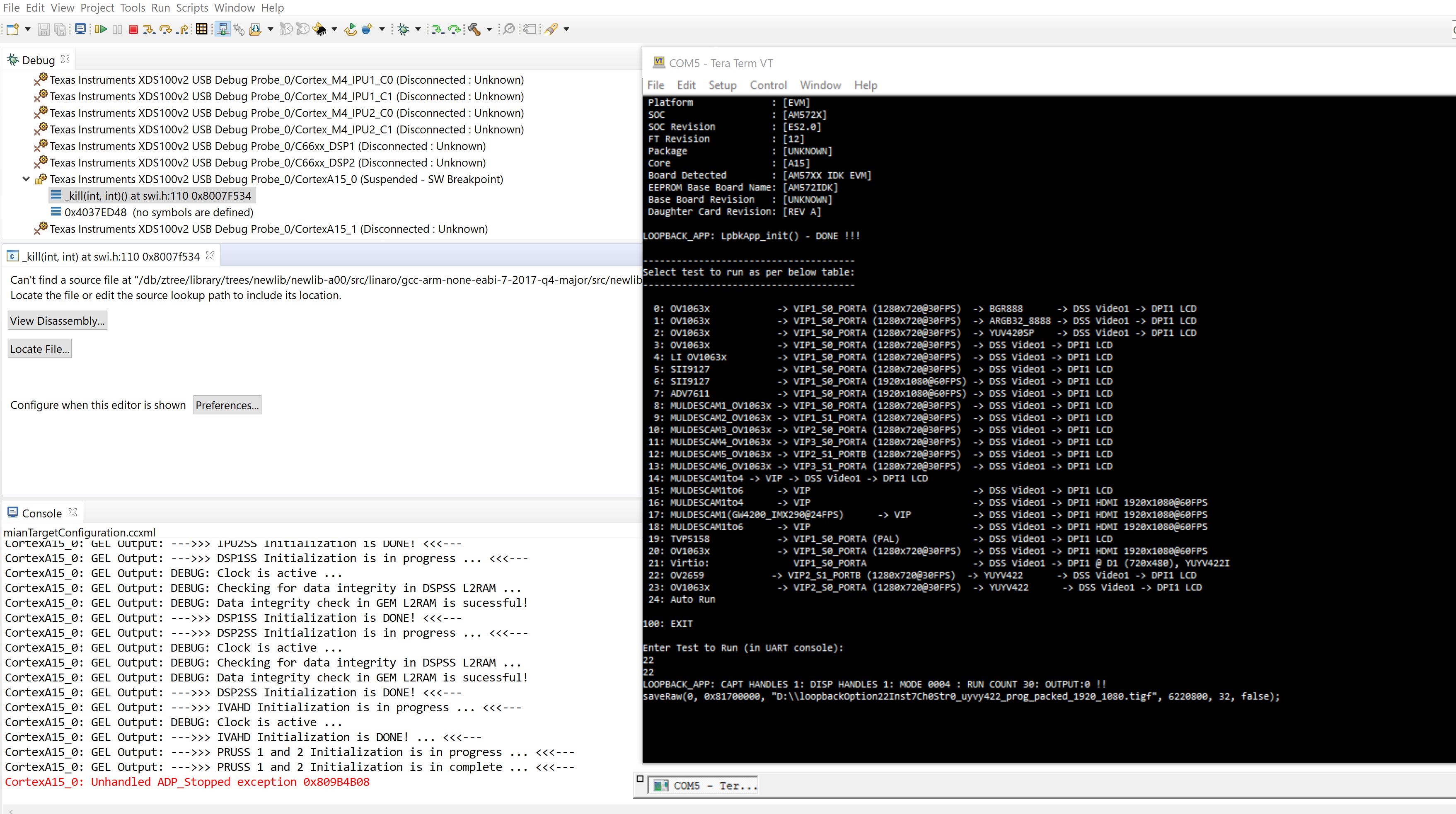

Hello every one,
I have an AM5728 IDK and a camera, my final goal is to capture an image and do some processing using imglib in ti-rtos, but for now, I'm just trying to run ti example on my IDK. These were my steps to run the VPS loopback example:
I compiled the loopback example successfully and there is a file, named vps_examples_loopback_a15_0_release.xa15fg  in C:\ti\pdk_am57xx_1_0_15\packages\ti\binary\vps_examples_loopback\bin\idkAM572x  directory. this is my camera (that I can't see 2659 label on it! that's why I put its picture here):
I have an empty microSD Card in fat32 format in my IDK. after I lunch my *.xa15fg file on my IDK, it gives me this:
and it stops there. then I tried to use *.xa15fg file provided by  ,here , and it gives me this:

which seems to be correct, but I can't see anything on my LCD, the moment I press 22, my LCD blinks once, but nothing appears on it. Does any one have any idea?
P.S: I don't know whether the example stores the images on the sd card or not, but when I exit the sd card, it's still empty.

  • Dear ,

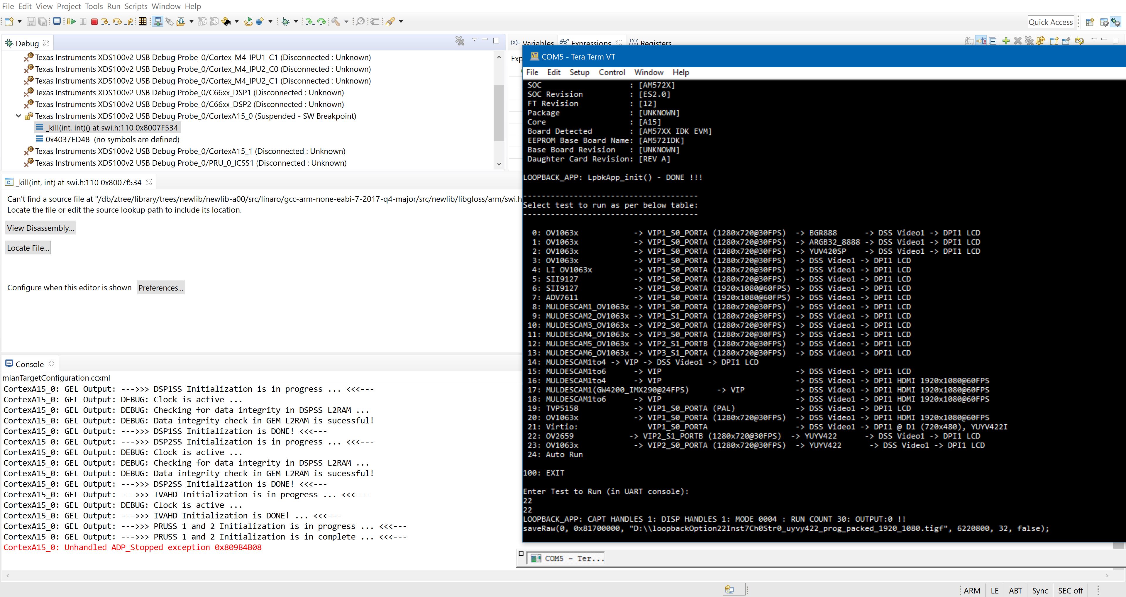

    Thank you for your response, I tried to run the binary you attached, but the result was the same as mine:
    I also tried to run the related binary on C66x core, again, the program goes to the end but no picture appears on the LCD, only this time a fullscreen green color appears for some seconds. Am I supposed to do any extra step? like putting any jumper ...
    this is my hardware setup:
    B.R,
    Alex.
  • P.S:
    There are other files in the directory that I'm not using:
    all I could guess was to use *.xa15fg for the Cortex-A15 core and *.xe66 for DSP core, for example, I don't know what *.map files are and what I am supposed to do with them.
    I am not aware of any jumper setting for this, but you need a micro SD card formatted with FAT32 and inserted into the EVM. Also, you need the GEL file setup for the EVM (I thought you have this already).
    The .xa15fg is for A15 core, xe66 is for C66x core, both expected to work. xem4 is for M4 core, there may be some problem. *.map is the memory map file. *rov,xs is used for ROV view. You can ignore them.

  • Dear Eric,
    As I know, when I select my board in the target configuration file, it automatically detects related gel files for each core (which is C:\ti\ccs910\ccs\ccs_base\emulation\boards\am572x\gel\ directory), If I need to change any of these files please let me know. But now, I came up with this result that there is a hardware problem in my camera, because I failed to run it in Linux SDK (matrix GUI), it was functional in Linux two month ago, but now it's not working!!
    I will keep this question open until I find the final answer and I will post it here. Thank you very much for your help.
    B.R,
    Alex.
  • Alex,
    You are using AM572x IDK EVM, in the CCS target configuration, please select below, it will automatically add all the correct GELs for all the cores.
    Please fix the camera issue then let me know the RTOS VPS test results.
    Regards, Eric
  • Hi Eric,
    Since I am sure its a hardware issue and I don't know when I can have another camera, I close this, thank you for your help.
    Alex
