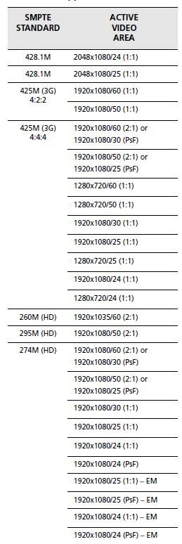

Thanks Steve,
I have one more question. In our application we are planing to use the GS2972 SDI serializer. Below are some standards supported apart from SMPTE 296M. I just want to know as BT1120 is a 1080 capable standard, Is there any 1080 standard(SMPTE 295M / 274M) below supported by DM6467?
Satya.
Satya,
For the 295 & 274 standards below, you can use the following rule.
If the overall number of pixels per second is less than 75MHz / 1.2, you can use the regular DM6467 part; if more, you might need to consider the DM6467T part.
Could you please explain to me what 1:1, 2:1, PsF, and EM mean?
