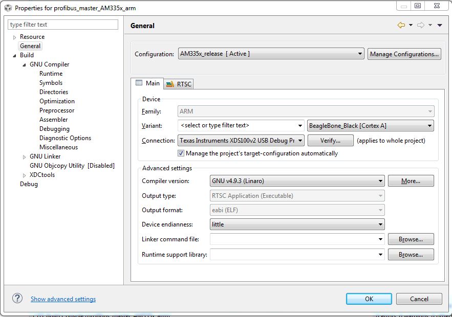

3) I built profibus master application with the following properties:

As you can see, the booting prusedure stopped at "Jumping to StarterWare Application ..."
I searched about the above error and I found some solutions, but unfortunately those solutions did not work for me.
What should I do? What are my misstakes?
