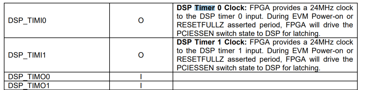

1. About Timer with TMS320C6657 EVM
Q1-1 : When we look at the TMS320C6657 EVM, It seems to me that DSP_TIMI[0:1] take input 24Mhz clock from the FPGA. Is it reference clock for DSP Timer?
Q1-2 : What is mandatory input clock to use DSP Internal Timer? Is it possible to use of external OSC instead of FPGA?
Q1-3 : What is the purpose of DSP_TIMO[0:1] in the EVM ?

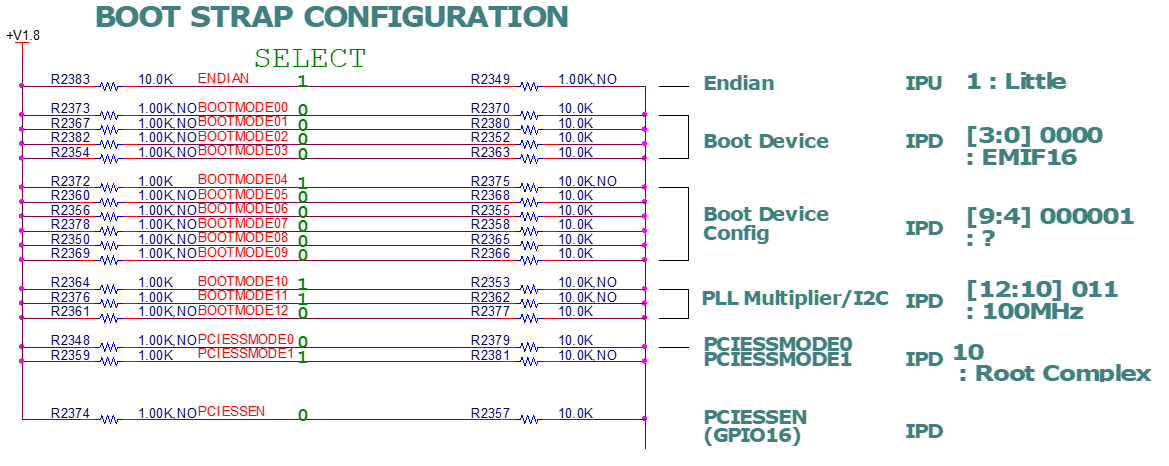

4. About Configuration bootmode with TMS320C6657 EVM
Q4-1 : We have designed our customized board based on TMS320C6657 EVM as can be seen attached schematic. Boot Device configuration pin is BOOTMODE[3:0], right?

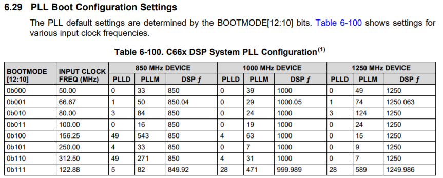

Q4-2 : What does PLL Multiplier signify? Does that mean CORECLK?
5. About Boot Strap Configuration.
Q5-1: When using EMIF16 NAND Flash for booting, how do I set the Boot Strap Configuration for above schematic.
(Coreclk : 50MHz, DDRCLK : 50MHz, PCIE Unused)
Q5-2 : When using EMIF16 NOR Flash(32MB) for booting, how do I set the Boot Strap Configuration for above schematic?
    That is correct.
    The multiplier bit setting specifies the clock speed presented to the CORECLK pin. This allows the device to program the main PLL to generate the fastest speed SYSCLK supported by the device you have installed. This is described in section 6.29. If you have a CORECLK of 100MHz the bits are set to 0b011. This will set up the PLL to provide a SYSCLK of 850MHz, 1GHz or 1.25GHz depending on which speed grade part is installed in your system.
    I checked the FPGA code and I don't see that the FPGA is generating a 24MHz clock. I'm not sure what you are asking with this question.
    There is not mandatory input clock frequency. The minimum pulse width on the timer inputs are shown in 5.7.14 of the data manual.  Pulses that are shorter will not be detected reliably.
    The timer pins were connected to the FPGA in case we needed to use the internal timer circuit but I don't think it is currently used on the EVM.
    Yes, this detail is called out in the C6657 EVM TRM document as you can see here :
    https://www.einfochips.com/wp-content/uploads/2016/04/C6657-Lite-EVM_TechnicalReferenceManual.pdf
    The timing supported by this pin is found in the C6657 datasheet#mce_temp_url# in Timer Electrical Data and timing section 5.7.14
    An external OSC can`t be used in place of FPGA like timing controller for this pin. Please note that the Pin has three functions muxed into it. GPIO, Timer input and BootMODE pins. At the time of boot the pin is used to set boot mode pin and then can be switched to timer input. Putting a OSC on it may cause unstable behavior in the bootROM.
    TIMOx pins are provided to connect timer output from the chip to external components for reference or the pins have secondary functionality to act as GPIO pins. Best way to read the purpose of the pins is to locate the pin name on C665x from Schematic and search in the device data manual for example these pins are AC19 and AE20.

    The description of Boot MODE pins are provided in the DEVSTAT register description in the Device data manual (section 6.28). Boot device setting for this mode is provided in BOOTMODE[5:0]. BOOTMODE[2:0] decides the boot device and the BOOTMODE[5:3] decides the sub module (EMIF16 in this case)
    PLL Config settings is described in detail  in section 6.29 of the Device data manual. These pins indicate to the ROM what in the input clock used in your HW design so that the ROM can read the Device speed setting and configure the multiplier and divider values for the device PLLs when setting up the boot. Here is the table for your reference. Please set BOOTMODE[12:10] accordingly

    The PLL configuration during boot only relates to Main PLL setup. For DDR PLL configuration there is a software structure defined that can be appended to the boot image to configure the DDR PLL. If you are using the secondary bootloader like IBL then you can control all of DDR PLL configuration and the EMIF initialization in the secondary boot code.
    There is a mismatch in the PLL setting in the schematic and what you have posted in your question. Since  BOOTMODE[ 12: 10] =011, I was assuming the SYSCLK used to setup core clock is 100 MHz but you indicated that the coreclk is 50 MHz. Please check that setting. The Switch setting for EMIF NAND is part of the document that shows direct booting from NAND. If your custom board design reuses the C6657 EVM design, then for EMIF NAND as we used on the EVM.
