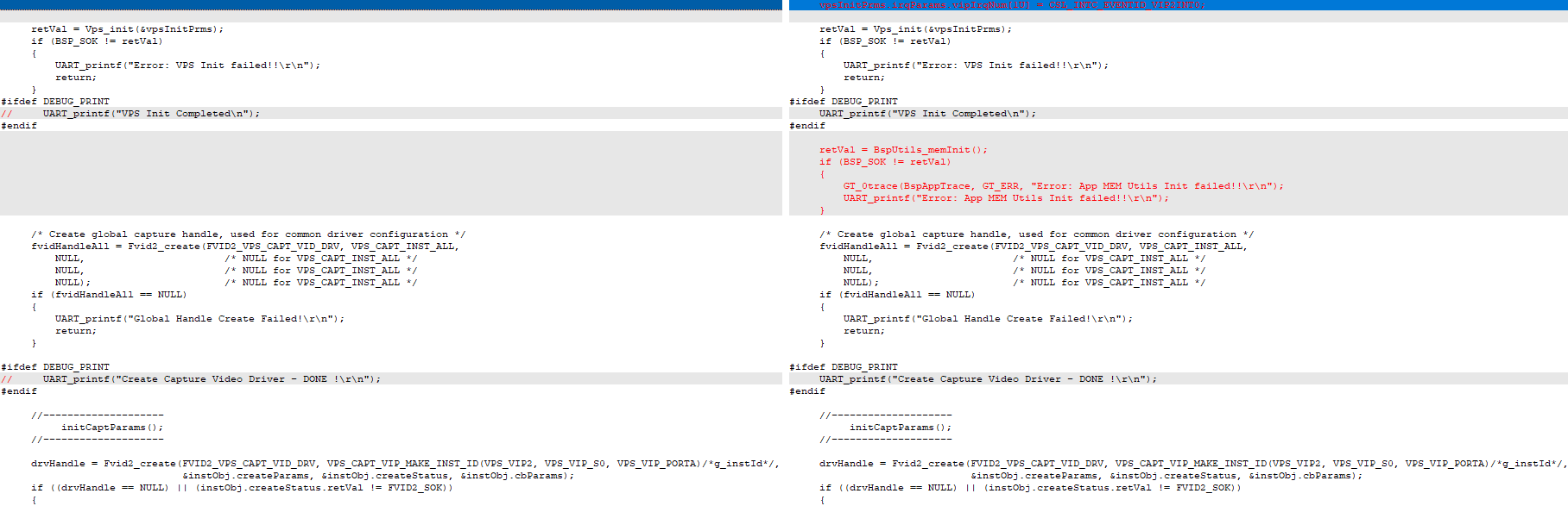

    retVal = BspUtils_memInit();
    if (BSP_SOK != retVal)
    GT_0trace(BspAppTrace, GT_ERR, "Error: App MEM Utils Init failed!!\r\n");
    UART_printf("Error: App MEM Utils Init failed!!\r\n");

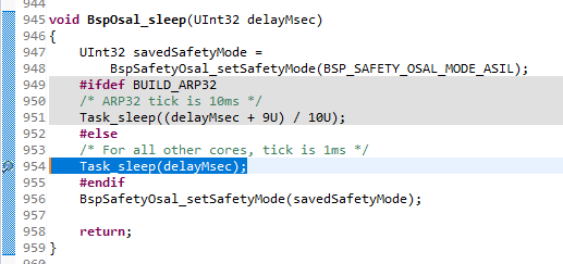

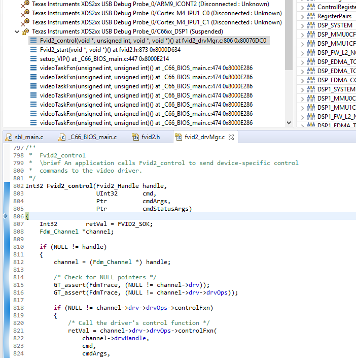

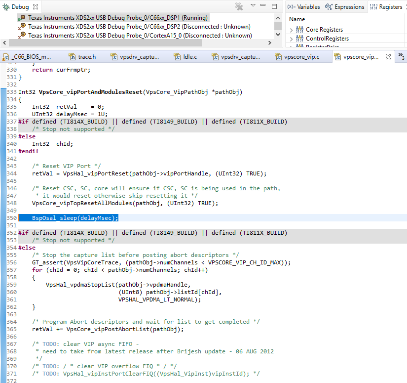

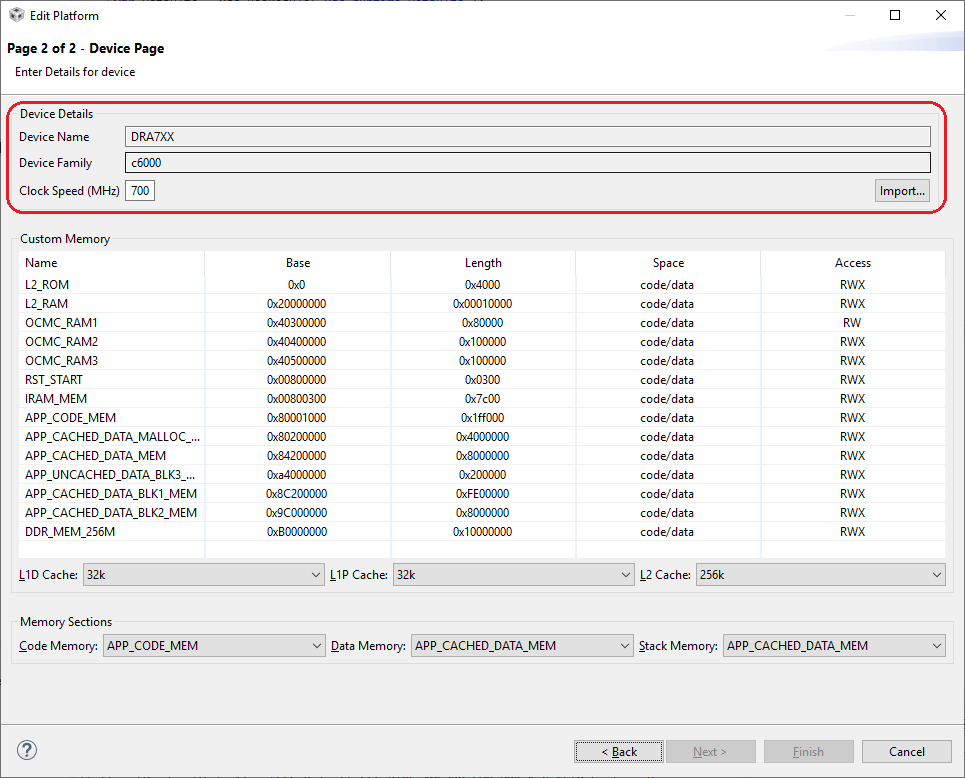

    Actualy, my apps isn't VPS loopback examples. My apps is based on this examples. It's difficult to me to start app without MLO as MLO include initial setup for video sensor and serializer and other peripheral. That is the structure of my app. Setup procedure consists of separate functions of setup of AM5728EVM. In MLO I tried to take only necessary parts of example. So I try to porting software from EVM to my board. In case of JTAG-debugging I have the same result as load from SD card. When using JTAG I don't see what is happening inside FVID2 libs when C66 jumps into FVID2_start()
    From the moment of calling FVID2_start() program counter (PC) doesn't match with highlighted line. Probably it happens because of the compile FVID2 libs with optimization.

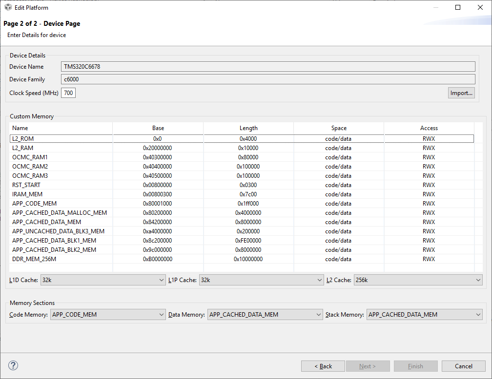

    As for the memory overlapping MLO and app areas I used the same address spaces for baremetal and RTOS versions. It's their map files:
    OUTPUT FILE NAME:   <_C66_BareMetal_AM5728_EVM_PDK_1_0_14.out>
    ENTRY POINT SYMBOL: "_c_int00" address: 8006fac0
    MEMORY CONFIGURATION
              name           origin   length     used     unused   attr   fill
    L2_ROM               00000000   00004000 00000000 00004000 RWIX
    RST_START             00800000   00000300 00000220 000000e0 RWIX
    IRAM_MEM             00800300   00007c00 00000000 00007c00 RWIX
    L2_RAM               20000000   00010000 00000000 00010000 RWIX
    OCMC_RAM1             40300000   00080000 00000000 00080000 RWIX
    OCMC_RAM2             40400000   00100000 00000000 00100000 RWIX
    OCMC_RAM3             40500000   00100000 00000000 00100000 RWIX
    APP_CODE_MEM         80001000   001ff000 00090371 0016ec8f RWIX
    APP_CACHED_DATA_MALLO 80200000   04000000 04000000 00000000 RWIX
    APP_CACHED_DATA_MEM   84200000   08000000 01dd360c 0622c9f4 RWIX
    APP_CACHED_DATA_BLK1_ 8c200000   0fe00000 00000000 0fe00000 RWIX
    APP_CACHED_DATA_BLK2_ 9c000000   08000000 00000000 08000000 RWIX
    APP_UNCACHED_DATA_BLK a4000000   00200000 0001d4c0 001e2b40 RWIX

    I remind that MLO with system's setup is the same for baremetal and RTOS cases. So there was memory overlapping in both cases, right?
    Thanks for the explanation! TI MLO uses OCMC memory, your APP uses DDR or a small portion of L2, I don't see that MLO overlapping with APP. Some questions:
    1. You didn't use any TI VPS test example code, instead you wrote your code called void setup_VIP(void), what TI source code you referred to for this?
    2. Did you establish a working baseline that using TI MLO+APP it worked? At the beginning of this thread, I pointed a link with solution verified by several customers.

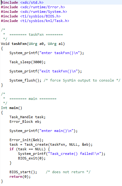

    8. For the SYSBIOS application, you need to re-build the fvid2 library without optimization if you can't step into the library code.
    Regards, Eric
  • 1. I referred to  CaptureVip and loopbackBareMetal examples. I wrote my own initialization of video sensor and SerDes and use it in MLO for A15. For boot speed up I modified original TI's code for using of only one stream.
    2. As for the clock source CM_CAM_VIP2_CLKCTRL = 0x00000001 at the begining of calling FVID2_start().
    3. MLO consists the main system's setup + full video source setup . In the result of loading MLO we have  video stream on VIN3A of AM5728.

    4. Test is failed at FVID2_start() on both AM5728EVM and my own board based on AM5708.
    5. At this time I use PDK_1_0_15. Although PDK_1_0_14 give the same bad result.
    6. The differences are minimal: in BIOS version added one extra function BspUtils_memInit()
    7.  In baremetal configuration the system boot from SD-card without JTAG and it's ok.
    8. I don't have any experience of rebuild parts of PDK and I'm warning of unexpected changes in PDK. Could you provide me with the compiled FVID2 lib files or give me instructions how to compile it?   If I think right I need to use

    I found source of stuck:
    it's function BspOsal_sleep(). Also function Osal_delay() caused system's stop in another parts of RTOS program. In baremetal design these functions works correctly. It's seems like some initializations is absent in RTOS version.
    I can't debug Task_sleep function, because this is part of the optimized RTOS-kernel.
    Thanks for the debug! It looks that the timer is not enabled in the SYSBIOS. In this case, if you add a task_sleep() at the beginning of the main(), it will stuck there as well, correct? I am not sure which timer is used by SYSBIOS as heart beat, one way is to enable all the timer's PRCM domain. This code you can refer to the GEL file at ccs_base\emulation\boards\am572x\gel\AM572x_prcm_config.gel, function AM572x_PRCM_Module_AllEnable_Config(). This may be tedious.
    Are you able to attach the .cfg file for the SYSBIOS application? I also asked the BIOS colleague to check what timer needs to be enabled.
    Regards, Eric
  • Hi Eric,
    Yes, that's right. When I added a task_sleep() in main() the program was stuck. Then I added in my program AM572x_PRCM_Module_AllEnable_Config() from ccs_base\emulation\boards\am572x\gel\AM572x_prcm_config.gel and there was no effect.

    It also caused the system stuck (in debugger -it's infinite idle loop).
    When calling function Task_sleep() from any task, it caused stuck also.
    Regards, Andrei
  • Moreover I created new test project.
     In test project I used my BIOS .cfg file. In this case Task_sleep works. But after I selected my custom platform instead default platform system was stucked on Task_sleep().
    And corresponding part of .cfg file:
    Program.sectMap[".bss:extMemNonCache:vpdma"]             = "APP_UNCACHED_DATA_BLK3_MEM";
    Program.sectMap[".bss:frameBuffer"]                       = new Program.SectionSpec();
    Program.sectMap[".bss:frameBuffer"].loadSegment           = "APP_CACHED_DATA_BLK1_MEM";
    Program.sectMap[".bss:frameBuffer"].type                 = "NOLOAD";
    Program.sectMap[".bss:tilerBuffer"]                       = new Program.SectionSpec();
    Program.sectMap[".bss:tilerBuffer"].loadSegment           = "APP_CACHED_DATA_BLK2_MEM";
    Program.sectMap[".bss:tilerBuffer"].type                 = "NOLOAD";
    Program.sectMap[".bss:taskStackSection"]                 = new Program.SectionSpec();
    Program.sectMap[".bss:taskStackSection"].loadSegment     = "APP_CACHED_DATA_MEM";
    Program.sectMap[".plt"]                                  = "APP_CODE_MEM";
    /* Board data and code sections need to go into OCMC when board is supported */
    Program.sectMap["BOARD_IO_DELAY_DATA"]                   = "OCMC_RAM1";
    Program.sectMap["BOARD_IO_DELAY_CODE"]                   = "OCMC_RAM1";
    My custom board was created based on .cmd file of baremetal version which works fine.
    -stack 0x800                         /* SOFTWARE STACK SIZE           */
    -heap   0x800                          /* HEAP AREA SIZE               */
    /* SPECIFY THE SYSTEM MEMORY MAP */
     MEMORY
       L2_ROM : org = 0x0, len = 0x4000
       L2_RAM : org = 0x20000000, len = 0x10000
       OCMC_RAM1 : org = 0x40300000, len = 0x80000
       OCMC_RAM2 : org = 0x40400000, len = 0x100000
       OCMC_RAM3 : org = 0x40500000, len = 0x100000
       RST_START : org = 0x00800000 len = 0x0300
       IRAM_MEM:   org = 0x00800300 len = 0x7c00
       APP_CODE_MEM : org = 0x80001000, len = 0x1ff000
       // The below memory section is reserved for memory alloc
       APP_CACHED_DATA_MALLOC_MEM : org = 0x80200000, len = 0x4000000
                    APP_CACHED_DATA_MEM : org = 0x84200000, len = 0x8000000
                    APP_UNCACHED_DATA_BLK3_MEM : org = 0xa4000000, len = 0x200000
       APP_CACHED_DATA_BLK1_MEM : org = 0x8C200000, len = 0xFE00000
       APP_CACHED_DATA_BLK2_MEM : org = 0x9C000000, len = 0x8000000
    /* SPECIFY THE SECTIONS ALLOCATION INTO MEMORY */
    SECTIONS
       .bss:mallocSection       : load > APP_CACHED_DATA_MALLOC_MEM, type = NOLOAD
       .bss:extMemNonCache:vpdma: load > APP_UNCACHED_DATA_BLK3_MEM
       .bss:frameBuffer: load > APP_CACHED_DATA_BLK1_MEM, type = NOLOAD
       .bss:tilerBuffer: load > APP_CACHED_DATA_BLK2_MEM, type = NOLOAD
       .text: load >> APP_CODE_MEM
       .csl_vect : load > RST_START
       .vects : load > IRAM_MEM
       .l2_int : load > IRAM_MEM
       .stack: load > APP_CACHED_DATA_MEM
       GROUP: load > APP_CACHED_DATA_MEM
           .bss:
           .neardata:
           .rodata:
       .binit: load > APP_CODE_MEM
       .cinit: load > APP_CODE_MEM
       .init_array: load > APP_CODE_MEM
       .const: load >> APP_CODE_MEM
       .data: load >> APP_CACHED_DATA_MEM
       .fardata: load >> APP_CACHED_DATA_MEM
       .switch: load >> APP_CACHED_DATA_MEM
       .sysmem: load > APP_CACHED_DATA_MEM
       .far: load >> APP_CACHED_DATA_MEM
       .args: load > APP_CACHED_DATA_MEM align = 0x4, fill = 0 {_argsize = 0x0; }
       .cio: load >> APP_CACHED_DATA_MEM
       .bootVecs: type = DSECT
       .resetVecs: load > 0x400
       .vecs: load > 0x400, type = DSECT
       .plt: load > APP_CODE_MEM
    Regards, Andrei
  • The solution of the problem was found:
    I created the similar platform but the diference is that I selected as a base chip DRA7XX instead of TMS320C6678. After the video capture began.
    Thanks a lot for your help, Eric!
    Kind regards, Andrei
