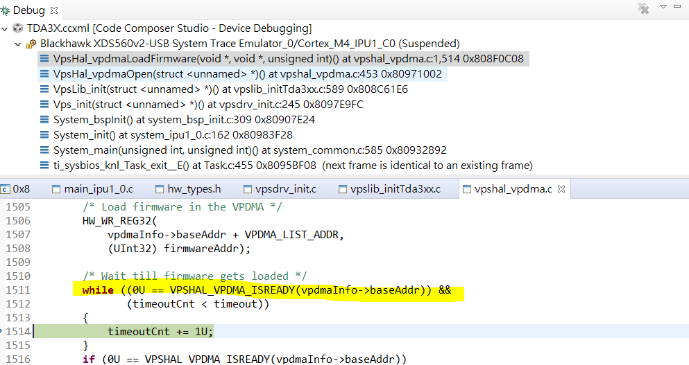

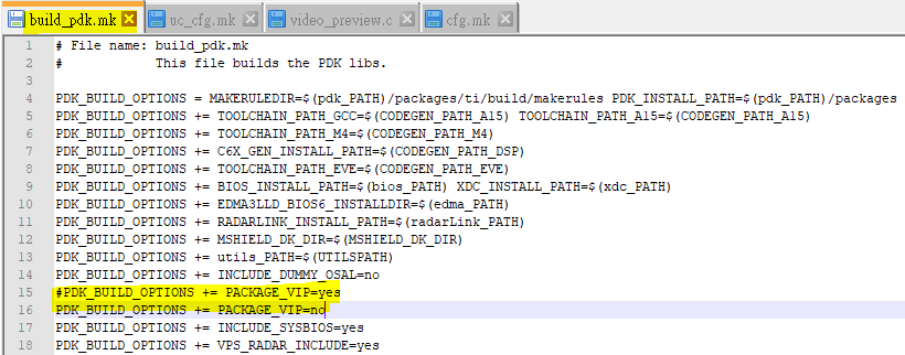

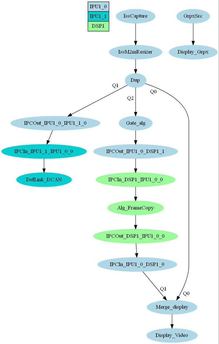

I am having problems modifying the fastboot usecase,
If I open IPU1_1 in  "cfg.mk", the program will hang on the app ,
else work well.
My SDK version : PROCESSOR_SDK_VISION_03_04_00_00
Modified use case :
Debug with CCS :

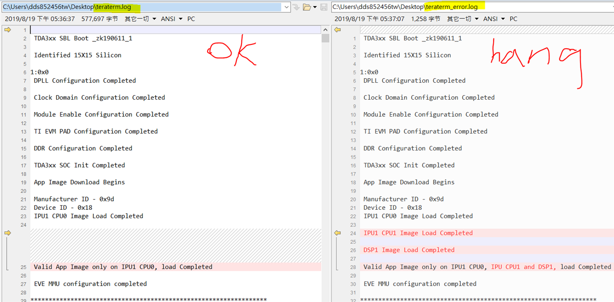

Uart Log compare :

# ERROR: EVE1 MUST be included in application
    can you try to change "PROC_EVE1_INCLUDE=no" to "PROC_EVE1_INCLUDE=yes" and see it it works?
    Also try a clean build (including deleting vision_sdk/binaries folder)
    Yordan
  • Hi.
    I fixed the problem with EVE error because I didn't turn off other usecase, and then I tested it again but didn't helpful.
    After that I tried changing "PROC_EVE1_INCLUDE = yes and gmake clean" to clean up the build and remove the vision_sdk / binaries folder,
    but didn't helpful too.
    Please give me some advice

    After that I running program will still hang on the app.
    Uart printing stops at "Jumping to IPU1_0 App" .
     TDA3xx SBL Boot
     Identified 15X15 Silicon
     DPLL Configuration Completed
     Clock Domain Configuration Completed
     Module Enable Configuration Completed
     TI EVM PAD Configuration Completed
     DDR Configuration Completed
     TDA3xx SOC Init Completed
     App Image Download Begins
     Manufacturer ID - 0x9d
     Device ID - 0x18
     IPU1 CPU0 Image Load Completed
     IPU1 CPU1 Image Load Completed
     App Image Download Completed
     EVE MMU configuration completed
     32K Timer is used to measure cycles, divide by 32K to get time in seconds
     Reset to SBL Init Cycles - 342  (10.43 ms)
     SBL Initial Config Cycles - 178  (5.43 ms)
     SOC Init Cycles - 468  (14.28 ms)
     DDR Config Clock Cycles - 229  (6.98 ms)
     App Image Load Cycles - 5827  (177.82 ms)
     Slave Core Bootup Cycles - 113  (3.44 ms)
     SBL Boot-up Cycles - 6818  (208.06 ms)
     Time at which SBL started IPU1_0 - 7160  (218.50 ms)
     Jumping to IPU1 CPU1 App
     Jumping to IPU1 CPU0 App
    CCS debugs as shown below :
    I have tried everything I thought.
    Can you give me a suggestion?
    Are you trying this demo with default configuration? Have you done any changes in the configuration?
    It seems to be handing in the VPDMA. Do you require VIP or VPE driver? Can we disable the try it out?

    AN : I do not require VIP but I need VPE driver , beacause I need issm2mresizer link.
    Q1 : Can I add IPU1_1 if I use the fastboot use case?
    Beacause I restore original sdk and only cange below  but still hang .
    Q2: How can I disable VIP_VPE_BUILD ?? I could not find it.
    1."C:\PROCESSOR_SDK_VISION_03_04_00_00\ti_components\drivers\pdk_01_10_00_08\packages\ti\boot\sbl_auto\sbl_app\src\tda3xx\sbl_tda3xx_main.c"
    2."C:\PROCESSOR_SDK_VISION_03_04_00_00ti_components\drivers\pdk_01_10_00_08\packages\ti\boot\sbl_auto\sbl_utils\src\tda3xx\
    sbl_utils_tda3xx_ddr_config.c"
    3."C:\PROCESSOR_SDK_VISION_03_04_00_00\ti_components\drivers\pdk_01_10_00_08\packages\ti\build\
    Rules.make"
     Device ID - 0x18
     Valid App Image only on IPU1 CPU0 and IPU CPU1, load Completed
     SBL Initial Config Cycles - 209  (6.37 ms)
     SOC Init Cycles - 469  (14.31 ms)
     App Image Load Cycles - 7820  (238.64 ms)
     SBL Boot-up Cycles - 8843  (269.86 ms)
     Time at which SBL started IPU1_0 - 9185  (280.30 ms)

    Iss Resizer link does not require VPE link. You could disable VPE and VIP links to bypass VPDMA loading. Please try bypassing these links..
    Rgds,
    Brijesh
    Thank you for your reply.
    Give me some time to clarify this issue.
    Best Regard
    YI TING
    I found out how to disable VPE , but could not find VIP disable.
    The VPE disable :
    C:\PROCESSOR_SDK_VISION_03_04_00_00\vision_sdk\apps\configs\tda3xx_evm_bios_all\cfg.mk
    VPE_INCLUDE=no
    Can I disable VIP by this way?
  • Yes, you could disable VIP in the same way.
