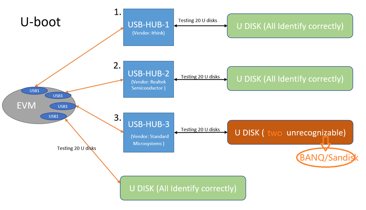

Detailed description of the problem:
In U-boot, the EVM board connects a certain type of USB HUB and inserts the U disk, some of which can not be recognized.
The test topology is as follows. The EVM board has tested three different manufacturers'USB-HUB.
The first and second types of USB-HUB can be recognized normally,   while the third type of USB-HUB(Standard microsystems  chip:  USB2514) has two types of USB-HUB that can not be recognized.But these two U disks can be correctly identified under Linux.   The two U disks are BANQ (F30/64G)  and Sandisk (SDCZ33/32G).

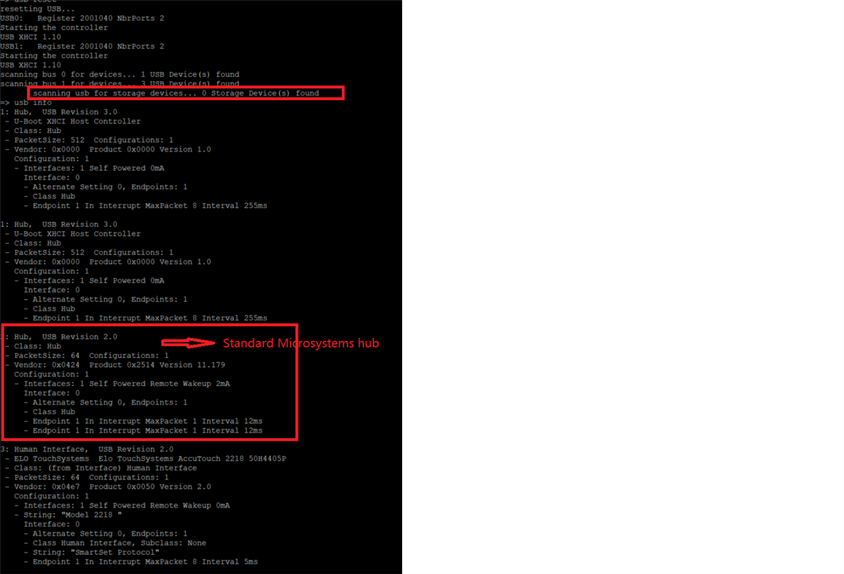

    Can you please provide the uboot log of the following command in the failure case?
    => usb reset
    => usb info
    In your opinion, this is my insertion of unrecognizable U-disk print information.
    In the log above, where is the Human Interface device connected to? It is not shown in the diagram in your first post.
    Is this as indicated in your first post that you tested 20 thumb drives with this USB-HUB-3 and only two of the thumb drives are failed to numerate? If so, what are the brands of the working thumb drives? I'd like to collect more information to see if I can reproduce the problem on my evm.
    Is the USB-HUB-3 self-powered or bus powered? If bus-powered, is it possible to use an external power supply to the hub?
    Human Interface Device is another device that you can ignore.
    1. I give some examples of U disks device that can be normally recognized: DTSE9, HP (x5000m), Patriot U330, Sandisk (CZ73), Kingston Data Traveler 100, aigo(NEX3.1), Sandisk (CZ880).
    2. my hubs used powered externally also not ok.

    req=1 (0x1), type=35 (0x23), value=20 (0x14), index=1
    EP STATE RUNNING.
    start_trb 00000000bdef94a0, start_cycle 1
    req->requesttype = 35, req->request = 1,le16_to_cpu(req->value) = 20,le16_to_cpu(req->index) = 1,le16_to_cpu(req->length) = 0
    length_field = 0, length = 0,xhci_td_remainder(length) = 0 , TRB_INTR_TARGET(0) = 0
    xhci_alloc_device: dev='usb@10000', udev=00000000bdecc680
    EP STATE RUNNING.
    set address 3
    usb_control_msg: request: 0x5, requesttype: 0x0, value 0x3 index 0x0 length 0x0
    xhci_submit_control_msg: dev='usb@10000', udev=00000000bdecc680, udev->dev='usb_hub', portnr=1
    Setting up addressable devices 00000000bdefdb00
    route string 1
    port_num = 1
    SPEED = 3
    Setting Packet size = 64bytes
    EP STATE RUNNING.
    Successful Address Device command
    xHC internal address is: 2
    usb_control_msg: request: 0x6, requesttype: 0x80, value 0x100 index 0x0 length 0x12
    req=6 (0x6), type=128 (0x80), value=256 (0x100), index=0
    EP STATE RUNNING.
    start_trb 00000000bdefa480, start_cycle 1
    req->requesttype = 128, req->request = 6,le16_to_cpu(req->value) = 256,le16_to_cpu(req->index) = 0,le16_to_cpu(req->length) = 18
    length_field = 18, length = 18,xhci_td_remainder(length) = 0 , TRB_INTR_TARGET(0) = 0
    usb_control_msg: request: 0x6, requesttype: 0x80, value 0x200 index 0x0 length 0x9
    req=6 (0x6), type=128 (0x80), value=512 (0x200), index=0
    EP STATE RUNNING.
    start_trb 00000000bdefa4b0, start_cycle 1
    req->requesttype = 128, req->request = 6,le16_to_cpu(req->value) = 512,le16_to_cpu(req->index) = 0,le16_to_cpu(req->length) = 9
    length_field = 9, length = 9,xhci_td_remainder(length) = 0 , TRB_INTR_TARGET(0) = 0
    usb_control_msg: request: 0x6, requesttype: 0x80, value 0x200 index 0x0 length 0x20
    EP STATE RUNNING.
    start_trb 00000000bdefa4e0, start_cycle 1
    req->requesttype = 128, req->request = 6,le16_to_cpu(req->value) = 512,le16_to_cpu(req->index) = 0,le16_to_cpu(req->length) = 32
    length_field = 32, length = 32,xhci_td_remainder(length) = 0 , TRB_INTR_TARGET(0) = 0
    get_conf_no 0 Result 32, wLength 32
    if 0, ep 0
    if 0, ep 1
    ##EP epmaxpacketout[1] = 512
    ##EP epmaxpacketin[2] = 512
    set configuration 1
    usb_control_msg: request: 0x9, requesttype: 0x0, value 0x1 index 0x0 length 0x0
    EP STATE RUNNING.
    Successful Configure Endpoint command
    req=9 (0x9), type=0 (0x0), value=1 (0x1), index=0
    EP STATE RUNNING.
    start_trb 00000000bdefa510, start_cycle 1
    req->requesttype = 0, req->request = 9,le16_to_cpu(req->value) = 1,le16_to_cpu(req->index) = 0,le16_to_cpu(req->length) = 0
    new device strings: Mfr=1, Product=2, SerialNumber=3
    usb_control_msg: request: 0x6, requesttype: 0x80, value 0x300 index 0x0 length 0xFF
    req=6 (0x6), type=128 (0x80), value=768 (0x300), index=0
    EP STATE RUNNING.
    start_trb 00000000bdefa530, start_cycle 1
    req->requesttype = 128, req->request = 6,le16_to_cpu(req->value) = 768,le16_to_cpu(req->index) = 0,le16_to_cpu(req->length) = 255
    length_field = 255, length = 255,xhci_td_remainder(length) = 0 , TRB_INTR_TARGET(0) = 0
    USB device number 3 default language ID 0x409
    usb_control_msg: request: 0x6, requesttype: 0x80, value 0x301 index 0x409 length 0xFF
    req=6 (0x6), type=128 (0x80), value=769 (0x301), index=1033
    EP STATE RUNNING.
    start_trb 00000000bdefa560, start_cycle 1
    req->requesttype = 128, req->request = 6,le16_to_cpu(req->value) = 769,le16_to_cpu(req->index) = 1033,le16_to_cpu(req->length) = 255
    usb_control_msg: request: 0x6, requesttype: 0x80, value 0x302 index 0x409 length 0xFF
    req=6 (0x6), type=128 (0x80), value=770 (0x302), index=1033
    EP STATE RUNNING.
    start_trb 00000000bdefa590, start_cycle 1
    req->requesttype = 128, req->request = 6,le16_to_cpu(req->value) = 770,le16_to_cpu(req->index) = 1033,le16_to_cpu(req->length) = 255
    usb_control_msg: request: 0x6, requesttype: 0x80, value 0x303 index 0x409 length 0xFF
    req=6 (0x6), type=128 (0x80), value=771 (0x303), index=1033
    EP STATE RUNNING.
    start_trb 00000000bdefa5c0, start_cycle 1
    req->requesttype = 128, req->request = 6,le16_to_cpu(req->value) = 771,le16_to_cpu(req->index) = 1033,le16_to_cpu(req->length) = 255
    Manufacturer Samsung
    Product      Flash Drive FIT
    SerialNumber 0340118020001324
    usb_control_msg: request: 0xFE, requesttype: 0xA1, value 0x0 index 0x0 length 0x1
    xhci_submit_control_msg: dev='usb@10000', udev=00000000bdef5620, udev->dev='usb_mass_storage', portnr=1
    req=254 (0xfe), type=161 (0xa1), value=0 (0x0), index=0
    EP STATE RUNNING.
    start_trb 00000000bdefa5f0, start_cycle 1
    req->requesttype = 161, req->request = 254,le16_to_cpu(req->value) = 0,le16_to_cpu(req->index) = 0,le16_to_cpu(req->length) = 1
    length_field = 1, length = 1,xhci_td_remainder(length) = 0 , TRB_INTR_TARGET(0) = 0
    xhci_submit_bulk_msg: dev='usb@10000', udev=00000000bdef5620
    dev=00000000bdef5620, pipe=c0008303, buffer=00000000bdecc300, length=31
    EP STATE RUNNING.
    dev=00000000bdef5620, pipe=c0010383, buffer=00000000bdecc440, length=36
    EP STATE RUNNING.
    dev=00000000bdef5620, pipe=c0010383, buffer=00000000bdecc280, length=13
    EP STATE RUNNING.
    EP STATE RUNNING.
    EP STATE RUNNING.
    EP STATE RUNNING.
    dev=00000000bdef5620, pipe=c0010383, buffer=00000000bdecc3c0, length=8
    EP STATE RUNNING.
    EP STATE RUNNING.
    usb_control_msg: request: 0x0, requesttype: 0xA3, value 0x0 index 0x2 length 0x4
    xhci_submit_control_msg: dev='usb@10000', udev=00000000bdee7e80, udev->dev='usb_hub', portnr=1
    req=0 (0x0), type=163 (0xa3), value=0 (0x0), index=2
    EP STATE RUNNING.
    start_trb 00000000bdef94c0, start_cycle 1
    req->requesttype = 163, req->request = 0,le16_to_cpu(req->value) = 0,le16_to_cpu(req->index) = 2,le16_to_cpu(req->length) = 4
    length_field = 4, length = 4,xhci_td_remainder(length) = 0 , TRB_INTR_TARGET(0) = 0
    Port 2 Status 100 Change 0
    devnum=2 port=2: timeout
    usb_control_msg: request: 0x0, requesttype: 0xA3, value 0x0 index 0x3 length 0x4
    req=0 (0x0), type=163 (0xa3), value=0 (0x0), index=3
    EP STATE RUNNING.
    start_trb 00000000bdef94f0, start_cycle 1
    req->requesttype = 163, req->request = 0,le16_to_cpu(req->value) = 0,le16_to_cpu(req->index) = 3,le16_to_cpu(req->length) = 4
    Port 3 Status 100 Change 0
    devnum=2 port=3: timeout
    usb_control_msg: request: 0x0, requesttype: 0xA3, value 0x0 index 0x4 length 0x4
    req=0 (0x0), type=163 (0xa3), value=0 (0x0), index=4
    EP STATE RUNNING.
    start_trb 00000000bdef9520, start_cycle 1
    req->requesttype = 163, req->request = 0,le16_to_cpu(req->value) = 0,le16_to_cpu(req->index) = 4,le16_to_cpu(req->length) = 4
    Port 4 Status 100 Change 0
    devnum=2 port=4: timeout
    3 USB Device(s) found
    scanning bus 1 for devices... xhci_alloc_device: dev='usb@10000', udev=00000000bdecd600
    set address 1
    usb_control_msg: request: 0x5, requesttype: 0x0, value 0x1 index 0x0 length 0x0
    xhci_submit_control_msg: dev='usb@10000', udev=00000000bdecd600, udev->dev='usb@10000', portnr=0
    USB_REQ_SET_ADDRESS
    scrlen = 0
     req->length = 0
    Len is 0
    USB_DT_DEVICE request
    scrlen = 18
     req->length = 18
    USB_DT_CONFIG config
    scrlen = 25
     req->length = 9
    usb_control_msg: request: 0x6, requesttype: 0x80, value 0x200 index 0x0 length 0x1F
    scrlen = 25
     req->length = 31
    get_conf_no 0 Result 25, wLength 31
    if 0, ep 0
    ##EP epmaxpacketin[1] = 8
    set configuration 1
    scrlen = 0
     req->length = 0
    Len is 0
    new device strings: Mfr=1, Product=2, SerialNumber=0
    USB_DT_STRING config
    scrlen = 4
     req->length = 255
    USB device number 1 default language ID 0x409
    scrlen = 14
     req->length = 255
    scrlen = 42
     req->length = 255
    Manufacturer U-Boot
    Product      XHCI Host Controller
    SerialNumber
    usb_hub_post_probe
    usb_control_msg: request: 0x6, requesttype: 0xA0, value 0x2A00 index 0x0 length 0x4
    xhci_submit_control_msg: dev='usb@10000', udev=00000000bdef6280, udev->dev='usb_hub', portnr=0
    USB_DT_HUB config
    scrlen = 8
     req->length = 4
    usb_control_msg: request: 0x6, requesttype: 0xA0, value 0x2A00 index 0x0 length 0xC
    USB_DT_HUB config
    scrlen = 8
     req->length = 12
    2 ports detected
    individual port power switching
    standalone hub
    individual port over-current protection
    TT requires at most 8 FS bit times (666 ns)
    power on to power good time: 20ms
    hub controller current requirement: 0mA
    port 1 is removable
    port 2 is removable
    usb_control_msg: request: 0x0, requesttype: 0xA0, value 0x0 index 0x0 length 0x4
    scrlen = 2
     req->length = 4
    get_hub_status returned status 1, change 902
    local power source is lost (inactive)
    no over-current condition exists
    xhci_update_hub_device: dev='usb@10000', udev=00000000bdef6280
    enabling power on all ports
    usb_control_msg: request: 0x3, requesttype: 0x23, value 0x8 index 0x1 length 0x0
    scrlen = 0
     req->length = 0
    Len is 0
    port 1 returns 0
    usb_control_msg: request: 0x3, requesttype: 0x23, value 0x8 index 0x2 length 0x0
    scrlen = 0
     req->length = 0
    Len is 0
    port 2 returns 0
    pgood_delay=20ms
    devnum=1 poweron: query_delay=100 connect_timeout=1100
    scrlen = 4
     req->length = 4
    usb_control_msg: request: 0x0, requesttype: 0xA3, value 0x0 index 0x1 length 0x4
    scrlen = 4
     req->length = 4
    Port 1 Status 100 Change 0
    scrlen = 4
     req->length = 4
    scrlen = 4
     req->length = 4
    scrlen = 4
     req->length = 4
    scrlen = 4
     req->length = 4
    scrlen = 4
     req->length = 4
    scrlen = 4
     req->length = 4
    scrlen = 4
     req->length = 4
    scrlen = 4
     req->length = 4
    scrlen = 4
     req->length = 4
    scrlen = 4
     req->length = 4
    scrlen = 4
     req->length = 4
    scrlen = 4
     req->length = 4
    scrlen = 4
     req->length = 4
    scrlen = 4
     req->length = 4
    scrlen = 4
     req->length = 4
    scrlen = 4
     req->length = 4
    scrlen = 4
     req->length = 4
    scrlen = 4
     req->length = 4
    scrlen = 4
     req->length = 4
    scrlen = 4
     req->length = 4
    scrlen = 4
     req->length = 4
    scrlen = 4
     req->length = 4
    scrlen = 4
     req->length = 4
    scrlen = 4
     req->length = 4
    scrlen = 4
     req->length = 4
    scrlen = 4
     req->length = 4
    scrlen = 4
     req->length = 4
    scrlen = 4
     req->length = 4
    scrlen = 4
     req->length = 4
    scrlen = 4
     req->length = 4
    scrlen = 4
     req->length = 4
    scrlen = 4
     req->length = 4
    scrlen = 4
     req->length = 4
    scrlen = 4
     req->length = 4
    scrlen = 4
     req->length = 4
    scrlen = 4
     req->length = 4
    scrlen = 4
     req->length = 4
    scrlen = 4
     req->length = 4
    scrlen = 4
     req->length = 4
    scrlen = 4
     req->length = 4
    scrlen = 4
     req->length = 4
    scrlen = 4
     req->length = 4
    scrlen = 4
     req->length = 4
    scrlen = 4
     req->length = 4
    scrlen = 4
     req->length = 4
    scrlen = 4
     req->length = 4
    scrlen = 4
     req->length = 4
    devnum=1 port=2: timeout
    scrlen = 4
     req->length = 4
    devnum=1 port=1: timeout
    1 USB Device(s) found
           scanning usb for storage devices... 1 Storage Device(s) found
    => usb reset
    resetting USB...
    // Halt the HC: 0000000004010020
    // Reset the HC
    // Disabling event ring interrupts
    // Halt the HC: 0000000004030020
    // Reset the HC
    USB0:   xhci_register: dev='usb@10000', ctrl=00000000bdef88c0, hccr=0000000004010000, hcor=0000000004010020
    // Reset the HC
    Register 2001040 NbrPorts 2
    Starting the controller
    USB XHCI 1.10
    USB1:   xhci_register: dev='usb@10000', ctrl=00000000bdf1f040, hccr=0000000004030000, hcor=0000000004030020
    // Reset the HC
    USB XHCI 1.10
    scanning bus 0 for devices... xhci_alloc_device: dev='usb@10000', udev=00000000bdecd600
    set address 1
    USB_REQ_SET_ADDRESS
    scrlen = 0
     req->length = 0
    Len is 0
    scrlen = 18
     req->length = 18
    scrlen = 25
     req->length = 9
    scrlen = 25
     req->length = 31
    if 0, ep 0
    set configuration 1
    scrlen = 0
     req->length = 0
    Len is 0
    scrlen = 4
     req->length = 255
    scrlen = 14
     req->length = 255
    scrlen = 42
     req->length = 255
    Manufacturer U-Boot
    SerialNumber
    usb_hub_post_probe
    xhci_submit_control_msg: dev='usb@10000', udev=00000000bdf06080, udev->dev='usb_hub', portnr=0
    USB_DT_HUB config
    scrlen = 8
     req->length = 4
    USB_DT_HUB config
    scrlen = 8
     req->length = 12
    2 ports detected
    standalone hub
    port 1 is removable
    port 2 is removable
    scrlen = 2
     req->length = 4
    xhci_update_hub_device: dev='usb@10000', udev=00000000bdf06080
    scrlen = 0
     req->length = 0
    Len is 0
    port 1 returns 0
    scrlen = 0
     req->length = 0
    Len is 0
    port 2 returns 0
    pgood_delay=20ms
    scrlen = 4
     req->length = 4
    SPEED = FULLSPEED
    scrlen = 4
     req->length = 4
    Port 1 Status 101 Change 1
    devnum=1 port=1: USB dev found
    SPEED = FULLSPEED
    scrlen = 4
     req->length = 4
    portstatus 101, change 1, 12 Mb/s
    usb_control_msg: request: 0x1, requesttype: 0x23, value 0x10 index 0x1 length 0x0
    clear port connect change, actual port 1 status  = 0x6e1
    scrlen = 0
     req->length = 0
    Len is 0
    usb_hub_port_reset: resetting 'usb_hub' port 1...
    usb_control_msg: request: 0x3, requesttype: 0x23, value 0x4 index 0x1 length 0x0
    scrlen = 0
     req->length = 0
    Len is 0
    SPEED = FULLSPEED
    scrlen = 4
     req->length = 4
    portstatus 111, change 0, 12 Mb/s
    STAT_C_CONNECTION = 0 STAT_CONNECTION = 1  USB_PORT_STAT_ENABLE 0
    scrlen = 0
     req->length = 0
    Len is 0
    SPEED = HIGHSPEED
    scrlen = 4
     req->length = 4
    portstatus 503, change 10, 480 Mb/s
    STAT_C_CONNECTION = 0 STAT_CONNECTION = 1  USB_PORT_STAT_ENABLE 1
    usb_control_msg: request: 0x1, requesttype: 0x23, value 0x14 index 0x1 length 0x0
    clear port reset change, actual port 1 status  = 0xe03
    scrlen = 0
     req->length = 0
    Len is 0
    EP STATE RUNNING.
    set address 2
    usb_control_msg: request: 0x5, requesttype: 0x0, value 0x2 index 0x0 length 0x0
    Setting up addressable devices 00000000bdf1ae40
    route string 0
    port_num = 1
    SPEED = 3
    EP STATE RUNNING.
    xHC internal address is: 1
    EP STATE RUNNING.
    start_trb 00000000bdf074c0, start_cycle 1
    EP STATE RUNNING.
    start_trb 00000000bdf074f0, start_cycle 1
    usb_control_msg: request: 0x6, requesttype: 0x80, value 0x200 index 0x0 length 0x29
    EP STATE RUNNING.
    start_trb 00000000bdf07520, start_cycle 1
    req->requesttype = 128, req->request = 6,le16_to_cpu(req->value) = 512,le16_to_cpu(req->index) = 0,le16_to_cpu(req->length) = 41
    length_field = 41, length = 41,xhci_td_remainder(length) = 0 , TRB_INTR_TARGET(0) = 0
    get_conf_no 0 Result 41, wLength 41
    if 0, ep 0
    if 0, ep 1
    ##EP epmaxpacketin[1] = 1
    set configuration 1
    EP STATE RUNNING.
    EP STATE RUNNING.
    start_trb 00000000bdf07550, start_cycle 1
    new device strings: Mfr=0, Product=0, SerialNumber=0
    Manufacturer
    Product
    SerialNumber
    usb_hub_post_probe
    usb_control_msg: request: 0x6, requesttype: 0xA0, value 0x2900 index 0x0 length 0x4
    xhci_submit_control_msg: dev='usb@10000', udev=00000000bdefd9c0, udev->dev='usb_hub', portnr=1
    req=6 (0x6), type=160 (0xa0), value=10496 (0x2900), index=0
    EP STATE RUNNING.
    start_trb 00000000bdf07570, start_cycle 1
    req->requesttype = 160, req->request = 6,le16_to_cpu(req->value) = 10496,le16_to_cpu(req->index) = 0,le16_to_cpu(req->length) = 4
    usb_control_msg: request: 0x6, requesttype: 0xA0, value 0x2900 index 0x0 length 0x9
    EP STATE RUNNING.
    start_trb 00000000bdf075a0, start_cycle 1
    req->requesttype = 160, req->request = 6,le16_to_cpu(req->value) = 10496,le16_to_cpu(req->index) = 0,le16_to_cpu(req->length) = 9
    4 ports detected
    standalone hub
    usb_control_msg: request: 0xB, requesttype: 0x1, value 0x1 index 0x0 length 0x0
    req=11 (0xb), type=1 (0x1), value=1 (0x1), index=0
    EP STATE RUNNING.
    start_trb 00000000bdf075d0, start_cycle 1
    req->requesttype = 1, req->request = 11,le16_to_cpu(req->value) = 1,le16_to_cpu(req->index) = 0,le16_to_cpu(req->length) = 0
    TT per port
    power on to power good time: 100ms
    hub controller current requirement: 1mA
    port 1 is removable
    port 2 is removable
    port 3 is removable
    port 4 is removable
    req=0 (0x0), type=160 (0xa0), value=0 (0x0), index=0
    EP STATE RUNNING.
    start_trb 00000000bdf075f0, start_cycle 1
    req->requesttype = 160, req->request = 0,le16_to_cpu(req->value) = 0,le16_to_cpu(req->index) = 0,le16_to_cpu(req->length) = 4
    get_hub_status returned status 0, change 0
    local power source is good
    xhci_update_hub_device: dev='usb@10000', udev=00000000bdefd9c0
    EP STATE RUNNING.
    req=3 (0x3), type=35 (0x23), value=8 (0x8), index=1
    EP STATE RUNNING.
    start_trb 00000000bdf07620, start_cycle 1
    req->requesttype = 35, req->request = 3,le16_to_cpu(req->value) = 8,le16_to_cpu(req->index) = 1,le16_to_cpu(req->length) = 0
    port 1 returns 0
    req=3 (0x3), type=35 (0x23), value=8 (0x8), index=2
    EP STATE RUNNING.
    start_trb 00000000bdf07640, start_cycle 1
    req->requesttype = 35, req->request = 3,le16_to_cpu(req->value) = 8,le16_to_cpu(req->index) = 2,le16_to_cpu(req->length) = 0
    port 2 returns 0
    usb_control_msg: request: 0x3, requesttype: 0x23, value 0x8 index 0x3 length 0x0
    req=3 (0x3), type=35 (0x23), value=8 (0x8), index=3
    EP STATE RUNNING.
    start_trb 00000000bdf07660, start_cycle 1
    req->requesttype = 35, req->request = 3,le16_to_cpu(req->value) = 8,le16_to_cpu(req->index) = 3,le16_to_cpu(req->length) = 0
    port 3 returns 0
    usb_control_msg: request: 0x3, requesttype: 0x23, value 0x8 index 0x4 length 0x0
    req=3 (0x3), type=35 (0x23), value=8 (0x8), index=4
    EP STATE RUNNING.
    start_trb 00000000bdf07680, start_cycle 1
    req->requesttype = 35, req->request = 3,le16_to_cpu(req->value) = 8,le16_to_cpu(req->index) = 4,le16_to_cpu(req->length) = 0
    port 4 returns 0
    pgood_delay=100ms
    devnum=2 poweron: query_delay=100 connect_timeout=1100
    scrlen = 4
     req->length = 4
    EP STATE RUNNING.
    start_trb 00000000bdf076a0, start_cycle 1
    req=0 (0x0), type=163 (0xa3), value=0 (0x0), index=1
    EP STATE RUNNING.
    start_trb 00000000bdf076d0, start_cycle 1
    req->requesttype = 163, req->request = 0,le16_to_cpu(req->value) = 0,le16_to_cpu(req->index) = 1,le16_to_cpu(req->length) = 4
    EP STATE RUNNING.
    start_trb 00000000bdf07700, start_cycle 1
    EP STATE RUNNING.
    start_trb 00000000bdf07730, start_cycle 1
    EP STATE RUNNING.
    start_trb 00000000bdf07760, start_cycle 1
    EP STATE RUNNING.
    start_trb 00000000bdf07790, start_cycle 1
    EP STATE RUNNING.
    start_trb 00000000bdf077c0, start_cycle 1
    EP STATE RUNNING.
    start_trb 00000000bdf077f0, start_cycle 1
    EP STATE RUNNING.
    start_trb 00000000bdf07820, start_cycle 1
    EP STATE RUNNING.
    start_trb 00000000bdf07850, start_cycle 1
    EP STATE RUNNING.
    start_trb 00000000bdf07880, start_cycle 1
    EP STATE RUNNING.
    start_trb 00000000bdf074c0, start_cycle 0
    EP STATE RUNNING.
    start_trb 00000000bdf074f0, start_cycle 0
    EP STATE RUNNING.
    start_trb 00000000bdf07520, start_cycle 0
    EP STATE RUNNING.
    start_trb 00000000bdf07550, start_cycle 0
    EP STATE RUNNING.
    start_trb 00000000bdf07580, start_cycle 0
    EP STATE RUNNING.
    start_trb 00000000bdf075b0, start_cycle 0
    EP STATE RUNNING.
    start_trb 00000000bdf075e0, start_cycle 0
    EP STATE RUNNING.
    start_trb 00000000bdf07610, start_cycle 0
    EP STATE RUNNING.
    start_trb 00000000bdf07640, start_cycle 0
    EP STATE RUNNING.
    start_trb 00000000bdf07670, start_cycle 0
    EP STATE RUNNING.
    start_trb 00000000bdf076a0, start_cycle 0
    devnum=2 port=1: USB dev found
    EP STATE RUNNING.
    start_trb 00000000bdf076d0, start_cycle 0
    req=1 (0x1), type=35 (0x23), value=16 (0x10), index=1
    EP STATE RUNNING.
    start_trb 00000000bdf07700, start_cycle 0
    req->requesttype = 35, req->request = 1,le16_to_cpu(req->value) = 16,le16_to_cpu(req->index) = 1,le16_to_cpu(req->length) = 0
    req=3 (0x3), type=35 (0x23), value=4 (0x4), index=1
    EP STATE RUNNING.
    start_trb 00000000bdf07720, start_cycle 0
    req->requesttype = 35, req->request = 3,le16_to_cpu(req->value) = 4,le16_to_cpu(req->index) = 1,le16_to_cpu(req->length) = 0
    EP STATE RUNNING.
    start_trb 00000000bdf07740, start_cycle 0
    EP STATE RUNNING.
    start_trb 00000000bdf07770, start_cycle 0
    EP STATE RUNNING.
    set address 3
    route string 1
    port_num = 1
    SPEED = 3
    EP STATE RUNNING.
    EP STATE RUNNING.
    start_trb 00000000bdee8e80, start_cycle 1

    Due to the nature of this issue, it is difficult to debug it remotely. As discussed offline, please send me the SMSC2514 hub and the thumb drive, so that I can debug the issue locally. The TI local FAE can help for the shipment.
    Since this issue is at low priority. I will close this thread for now. We will re-visit it once I received the USB devices for debugging.
    Thanks for providing me the USB hub and thumb drives. It helped me quickly locating the root cause of the issue.
    In your U-Boot env, before 'usb start' or 'usb reset' command, please set 'usb_pgood_delay' which is a delay (in ms) waiting for the hub port power to be stable. I have to set it to 600ms in my setup to get all three thumb drives enumerated properly.
    => setenv usb_pgood_delay 600
  • First of all, thank you very much for your support,
    There is also a question about how to determine the delay time? For the USB hub port, we test more U-disks. We found that some U-disks have a delay time of 600ms which can be recognized successfully, but some of them need a longer time.(example 900ms or 1200ms),So, How to determine the set delay time? Is there any explanation?
    Thank you
    184         /*
    185          * Wait for power to become stable,
    186          * plus spec-defined max time for device to connect
    187          * but allow this time to be increased via env variable as some
    188          * devices break the spec and require longer warm-up times
    189          */
    190         env = env_get("usb_pgood_delay");
    As mentioned in the comments in the U-Boot code above in common/usb_hub.c, adding the delay is due to some USB devices are out of the Specs. So I am not sure if there is a way to determine the delay if you want to support all the USB devices on the market.
    But if you search for 'usb_pgood_delay' in the U-Boot source code, you can find there are a few platforms which set the delay default value to 2000ms.
