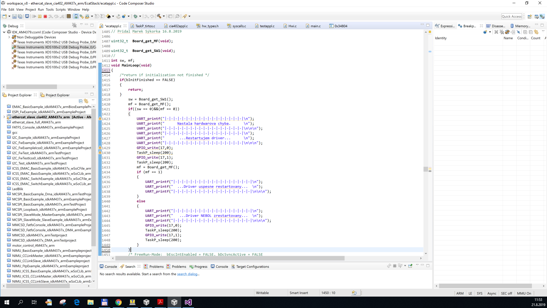

I have a problem with motor control through EtherCat(TwinCat) in example project cia402. I downloaded SSC from Beckhoff and patched it with Option#1 so i can use it with cia402 example. I moved "ESI" files into Twincat folders.
Then I was following instructions described in this PDF http://www.ti.com/lit/ug/tidu800b/tidu800b.pdf. As I do not have encoder ROQ 437 Heidenhein I used encoder ROC 413 Heidenhein. I recalculated "Scaling Factor Numerator" and "Output Scaling Factor (Velocity)", becouse mine Encoder has Encoder resolution of 13. With that I changed Code in CCS :
#define TWINCAT_SINGLE_TURN_RES pow(2, [20 I changed this to 13 as described in the PDF])
#define TWINCAT_VELOCITY_RES pow(2, [20 I changed this to 13 as described in the PDF])
If i am lucky that TwinCat does not show error messages like (17245 (0x435d)- which I do not understand really)
and I can press F5(motor start), but after pressing it (when Controller, Feed FW, Feed BW Override 100 and Target Position as well as speed is set) nothing happens motor does not turn. Motor does some funny noises but its very rare its normally quiet. When I press motor stop it slightly moves to one side really fast(some 1° - 5°) its choppy motion. In the most cases the hardware motor fault of the board turns on after DRV8313 notices something wrong. Thats the only place where we modified the main CCS code, we are reading if the motor fault had happend and if the User Switch is pressed and then we send impulse to reset DRV8313 so we do not need to restart the whole program while testing. We did not find any reseting of this motor fault  in the program so we created ours.

  • Marek,
    Please double check if you have the device variables linked to the axis variables correctly as shown in Table 1 of the TI design http://www.ti.com/lit/ug/tidu800b/tidu800b.pdf
    Also, you may set a large value, e.g. 10000 to Maximum Position Lag Value, to address the error 17245 (0x435d) issue, see attached snapshot.
    Garrett

  • We figured out that Encoder is giving us position, but in a very specific way. It shows only 90° and 270°.and the position is not processed elsewhere. The program motor control is running but only in open speed loop becouse if we run it in closed speed loop mode the code returns -1 while verifying some endat things.
