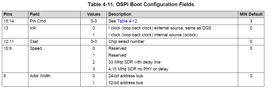

    We have solved this problem. the root cause is that boot mode pins settings are incorrect.
    The main difference is we are not using min config pin but manually setup the boot configures.
    But we still have question, the only difference is the min bit, all the other configuration is exactly the same to the default value(min config enabled) .
    I'm not sure why we must enable this min bit for the new SDK 6.0.
    More info, on the u-boot code side, if we are not using the minimal configuration, the processor will hang at sysfw-loader.c when trying to load sysfw from SPI flash. It seems that the device was not fully initialized before accessing. I suggest that the SPI interface should be reinitialize using DTS and keep independent with the ROM code stage. If not, for pure SPI flash boot will just fail with current u-boot design.
    Thank you.
    The min config pin is required on Uboot 2018.01+Uboot 2019.01 and on my setup, I was not able to boot without it. If the pin is not set, the following default configurations will not be setup:

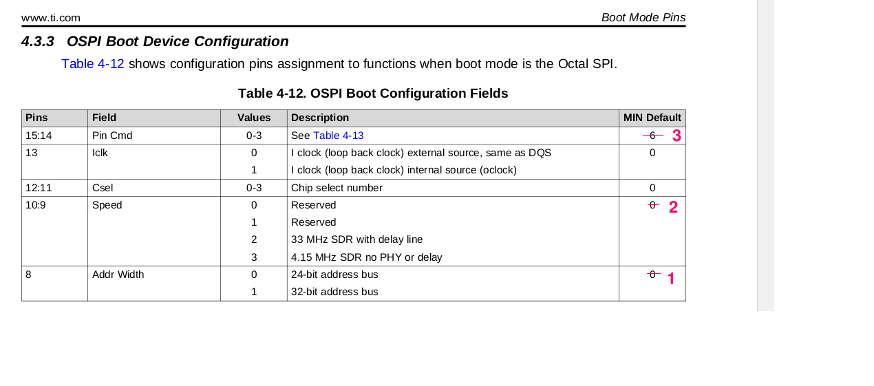

    My idea is even the reset of the configs is exactly the same with what the min config pin does, the board could not boot.
    Also, most importantly, seems that the current u-boot won't support pure SPI flash boot( bus width = 2 )
    Best Regards
    I was able to replicate your error with the min pin bit. We have filed an internal ticket to update the TRM but the boot pins [15:8] should be configured as follows:
