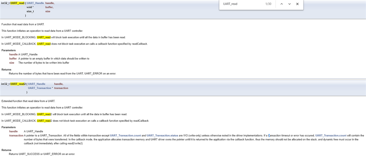

UART_read vs UART_read2 and UART_write vs UART_write2 pros and cons. how to use them? Thanks

Hi Biser
It come from your document.
Read/Write APIs
Interrupt:
UART_read(handle,scanPrompt, sizeof(scanPrompt));/* Read API */
UART_write(handle, bufferPrompt, sizeof(bufferPrompt));/* Write API */
Or
UART_transactionInit(&transaction);
transaction.buf = (void *)scanPrompt;
transaction.count = sizeof(scanPrompt);
UART_read2(uart, &transaction);
transaction.buf = (void *)bufferPrompt;
transaction.count = sizeof(bufferPrompt);
UART_write2(uart, &transaction);

Hi Biser
These functions come from software-dl.ti.com/.../index_device_drv.html

Anping,
The API documentation for the UART driver provides explanation for all the available APIs provided in the LLD including usage and arguments. Please use the API documentation collateral included in Processor SDK RTOS:
pdk_am335x_1_0_xx/packages/API_Documentation.html (click on the header file under files tab and select UART.h)
For this time, I am posting a screenshot for your reference :
If you still have questions, please post further questions here.
