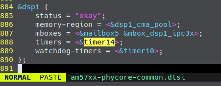

I am getting super frustrated by not being able to run the OS Clock module run properly on the DSP1 of a AM5728.
I am trying to use GPTimer14 (Id:13) that is configured in the Linux Device Tree as belonging to DSP1.
Therefore I made a simple project that replicates the problem which contains the .cfg, a makefile and one .c file.
Basically, I launch a task that should sleep for 1000ms and print something every time sleep expires.
Additionally, I defined the Clock as USER type and I am calling Clock_tick() myself from a custom function but this is never called because the Clock tick is stuck at zero.

I should add that I confirm that my GPTimer14 is properly working (base: 0x4882A000, TCLR=0x3, TCRR-increments when debugger stepping).

  • Hi Eric,
    Loading from CCS over JTAG never worked for me, and this thread has more info about this. I only load via remoteproc.
    Besides, the linux device tree simply says that my timer, GPTimer14 is handled by DSP. It is SYSBIOS configuration file that gets translated to C code which sets those Timer registers. I don't think Linux has any influence here.
    I also don't think the Timer itself is the culprit because I checked the registers, it counts to exactly 1ms (19200000 Hz, 19200 counts, from 0xffffb500 to 0xffffffff).
    I think the culprit is the BIOS Clock configuration or the interface between it and the working Timer.

  • Hi Eric,
    I assumed your project to be working as-is (using GPTimer6).
    I tried it onto my board and of course Linux started showing kernel dumps and access to L4_PER3, because DSP1 was accessing a Timer not marked as assigned to it in linux device tree.
    Then I simply changed the timer id to 13 (GPTimer14) in your project's .cfg. The dumps disapeared but for some reason the application wouldn't work as you described.
    I then recompiled the Linux device tree after instructing it to use GPTimer5 (traditionally used with DSP1).
    This worked, BIOS Clock is now counting normally.
