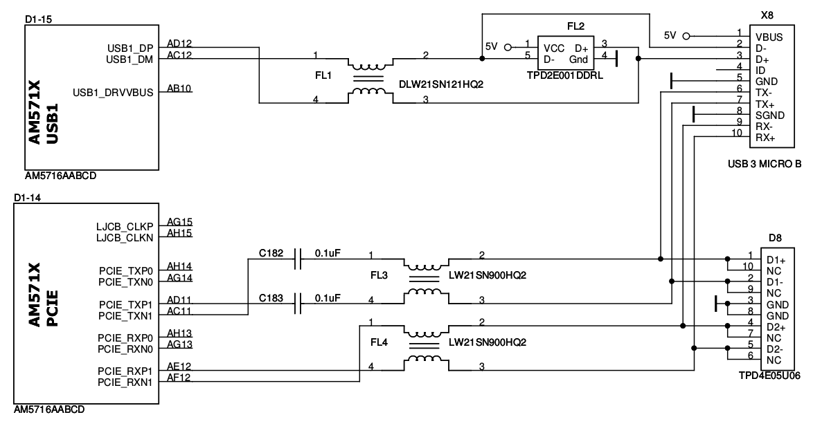

I'm facing in issue related to AM5716 USB3 controller in peripheral mode. My device is a bus powered USB gadget (ACM + MTP). It always works correctly when connected to USB2 port. USB3 also operates correctly with most PCs and laptops. But some hosts (mostly Intel H97 based) do not detect my device. I tried to debug link state on device side using DebugFS in SDK documentation. I found that link gets stuck in Compliance state (in rare cases in RX.Detect state). I tried to restart gadget, to force different link states, but it doesn't help at all. I also found very similar (and unresolved) issue described in linux-usb list: https://www.spinics.net/lists/linux-usb/msg182579.html
Please help me to resolve link issues. I have access to Beagle 5000 USB analyzer if it could help. Guys from linux-usb also have it, they figured out that issue is caused by LFPS timeout.

    Can you please share the USB portion of the schematics?

    Yes, it is pretty simple:

    Is X8 pin 1 (VBUS) directly connected to 5V power rail? This USB1 port is in device mode, VBUS power comes from the USB host. So this VBUS pin should be fed into AM571x instead. You can refer to the design on AM571x IDK evm, in which VBUS pin from the USB receptacle goes into PMIC, then PMIC outputs it to a GPIO on AM57x. Kernel device tree has to be adjusted accordingly for the picked GPIO pin.
    I am not sure if this hw mistake causes this compliance mode problem, but I am sure the host won't enumerate the gadget in super-speed every the other time even if you didn't have this compliance mode problem. And feeding 5V on VBUS from the gadget could potentially damage the USB host.
  • X8 pin powers the device, so VBUS feeds 5V. AFAIK it is common practice for bus powered devices.
    On kernel side VBUS detection is managed via "linux,extcon-usb-gpio" node and dr_mode is set to peripheral.
    I think that investigation made by Felipe Balbi should be elaborated to resolve this issue.
  • Okay, understood. The '5V' label for the X8 pin 1 is confusing, as I read it as a 5V power source.
