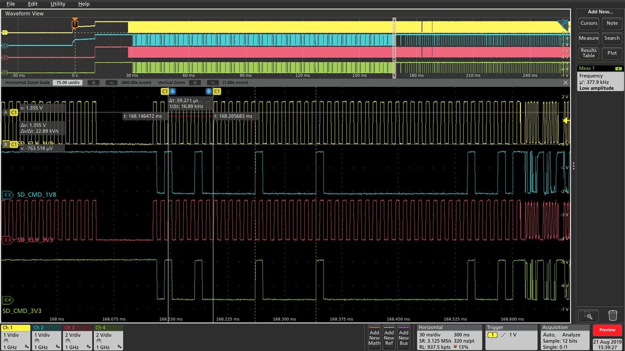

We connects TF card to the AM3358 MMC0 port.
During the TF card initialization, the CMD16 command always fails.

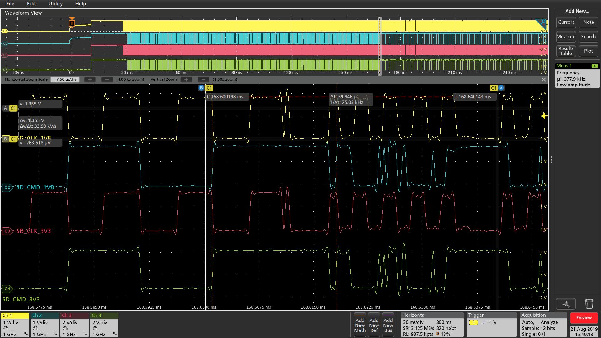

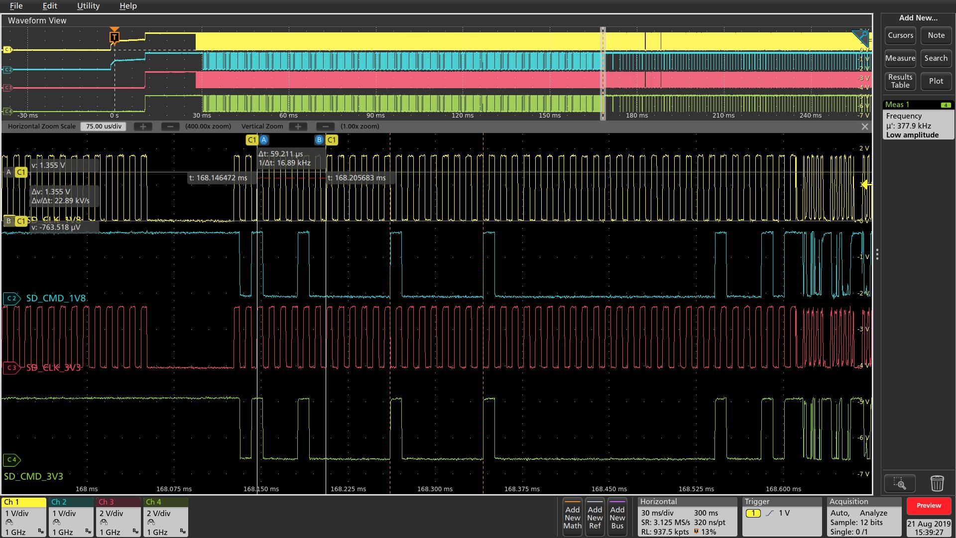

And using oscilloscope, we noticed that after the processor executes CMD4 command, the CMD signal line becomes distorted as you can see from the attached captured waveforms below.
What is the possible cause of this issue? should CMD4 be removed during card initialization?
1) the waveform of CMD4 command.
2) the CMD signal distortion after CMD4 command.
