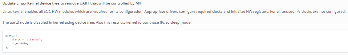

  • Hi Sahin,
      Tried with UART example for IPU with remoteproc & IPC support mention in below link:
    http://software-dl.ti.com/processor-sdk-rtos/esd/docs/latest/rtos/How_to_Guides.html#create-dsp-and-ipu-firmware-using-pdk-drivers-and-ipc-to-load-from-arm-linux-on-am57xx-devices
    But problem is same  giving following error:

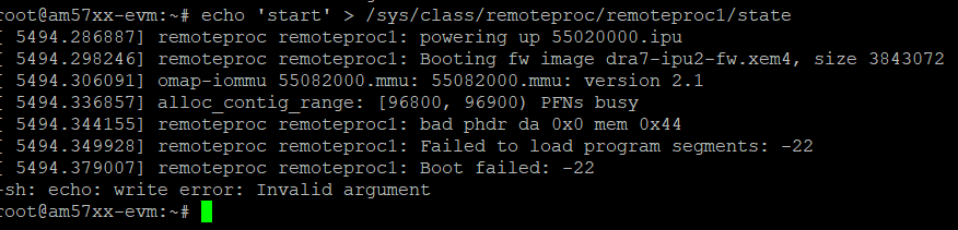

  • HI Sahin,
    Yeah I include resource table in IPU project, that I tried out with ethernet as well as for USB application on M4 core.
    But am able to run my both applications using debugger, not with remoteproc.
    kindly find files am using in the attachment  that am using in case of USB bulk generic device mode on M4 core.
    Also am attaching an log what am getting while loading my USB application on IPU2 core

  • Hello Sahin,
    Any further update on this. Actually I tried couple of things like use same resource table and cfg file used for UART application on  M4 core, with that application not giving any error while loading via remoteproc but application not start.
    USB not able to detect neither on windows nor on Linux.
    Below is my log am getting on terminal.
    [ 175.738790] remoteproc remoteproc1: powering up 55020000.ipu
    [ 175.949371] remoteproc remoteproc1: Booting fw image dra7-ipu2-fw.xem4, size 4476304
    [ 175.957259] omap-iommu 55082000.mmu: 55082000.mmu: version 2.1
    [ 175.991533] virtio_rpmsg_bus virtio0: rpmsg host is online
    [ 175.997217] remoteproc remoteproc1: registered virtio0 (type 7)
    [ 176.003399] remoteproc remoteproc1: remote processor 55020000.ipu is now up
     When I run this application using debugger the am getting USB message on terminal, application run successfully.

    I take it you are now trying to apply the same method used for the UART application for your USB application - is my understanding correct?
    When you run the application via debugger, is Linux running on the A15?
    You may need to disable the USB instance in the Linux device tree. Similar to what was done for UART in the guide:
    There are some other careabouts that need to be taken care of for the USB application to play nicely with Linux. For example, you will need to disable board_init() in the USB application since this is handled by Linux.
    Additionally, Linux expects the IPU application at a certain address so make sure this matches the location specified in the resource table and CMA carveout in the Linux dts (you can place the USB application in the same location as the UART application if you've already verified it works)
    Furthermore, standalone IPU applications use addresses (0x4X000000) to peripheral registers and use following MMU settings:
    • L2 MMU uses default 1:1 Mapping
    • AMMU configuration translates physical 0x4X000000 access to logical 0x4X000000
    When integrating IPC/RemoteProc + IPU application, IPC requires that the IPU application uses the logical address instead. This is due to the bit-banding feature of the M4 core (I've attached slides below for more explanation on this). Therefore, the L2 MMU is configured such that MMU translates 0x6X000000 access to addresss 0x4X000000. The consequence of this is that you will need to append 0x20000000 to peripheral addresses, for example:
    (CSL_IPU_UART3_REGS + 0x20000000),    //Base Addr = 0x48000000 + 0x20000000 = 0x68000000
    https://training.ti.com/sites/default/files/docs/Running_RTOS_on_Cortex_M4_SLIDES.pdf
    This is explained in the section titled "Update Linux Kernel device tree to remove UART that will be controlled by M4" in the following guide.

    Thanks for your reply, Kindly find my findings below:
    1. Yeah am applying similar process to run my USB application as describe in shared link for UART.
    2. When I run my application through debugger, target EVM is under u-boot mode.
    3. Current status of my UART3 on device tree file am57xx-beagle-x15-common.dtsi is
       &uart3 {
       status = "okay";
       interrupts-extended = <&crossbar_mpu GIC_SPI 69 IRQ_TYPE_LEVEL_HIGH>,<&dra7_pmx_core 0x3f8>;
       I never change status of UART3 as described in provided link.
    4. For USB disable under Linux device tree, I need to check once then I let you know.
    5. Board_init() I already disabled.
    6. CMA carveout in dts are properly aligned.
    7. L2MMU config need to check as per M4 bit banding.
    8. One important observation in UART application for M4 there is one file with name IpuAmmu.cfg.
