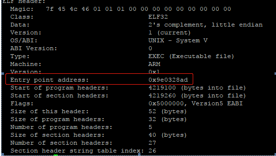

Dear Team,
My customer use VSDK0305(linux), They need to boot IPU1-0 from uboot. (IPU1 firmware is theirs.). I already request them to add .resource table. Now they already can  download the image from uboot,.but they can not boot. I let customer to try. modified the PC point to 0x9e in CCS and can run to Main.
uboot log as below:
This picture's IPU1 address is not correct, because we download the image to 0x9e000000. Our image:

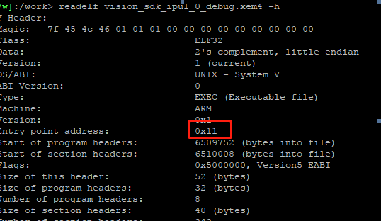

Customer image:
Please help to give some comments or suggestions about the issue? and how to configure the entry point address.
