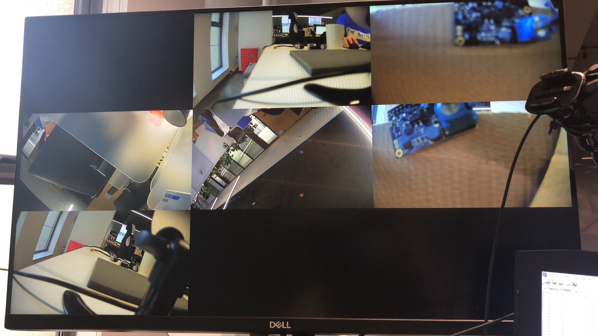

TDA2EVM5777: All 6 cameras have data output, but they cannot be displayed
Part Number: TDA2EVM5777
HI
What caused the state of the camera? All 6 cameras have data output, but they cannot be displayed.

956.173974] PVR_K:(Error): PVRSRVMapDmaBufKM: Failed to get dma-buf phys addr
[  956.226672] PVR_K:(Error): PVRSRVMapDmaBufBW: Failed to map dma-buf handle
E GL: after eglCreateImageKHR() eglError (0x3003)
ASSERT (syste_gl_egl_utils.c|System_eglWindowGetTexYuv|803)
 [HOST] [HOST  ]    966.998383 s:  EGL: ERROR: eglCreateImageKHR failed !!!
 [HOST] [HOST  ]    966.998444 s:  EGL: ERROR: Unable to bind texture[6] to dmabuf fd [0] !!!

    Most of the frames are dropped due to erroneous signal. Frame size is varying a lot. Please check your input signal.
    Rgds,
    Brijesh
    What causes the captured frames to be discarded?  I haven't had a similar problem with my 4-way camera, and now I have a problem with a 6-way camera.  I pulled the SEL_ENET_MUX_S0 signal directly on the board and added the VIN4B signal control in mux_data.h.

  • Please check if the pinmux is setup correctly for all 6 input camera.. Please check if hysnc and vsync signals are correctly toggling.
    Brijesh
    Press "p" and then send a command unrecognized on the console to display the 6-way camera output.
    3.478141] PVR_K:(Error): PVRSRVMapDmaBufBW: Failed to map dma-buf handle
     [HOST] [HOST  ]    734.357652 s:  EGL: ERROR: eglCreateImageKHR failed !!!
     [HOST] [HOST  ]    734.357683 s:  EGL: ERROR: Unable to bind texture[6] to dmabuf fd [0] !!!

  • Hi
    I think SGX implementation supports upto 4 cameras only.  You will require to change it to support 6 cameras.
    Rgds,
    Brijesh
  • You need just to change the support for 6 camera, try it because i have tha same problem, and solved :)
