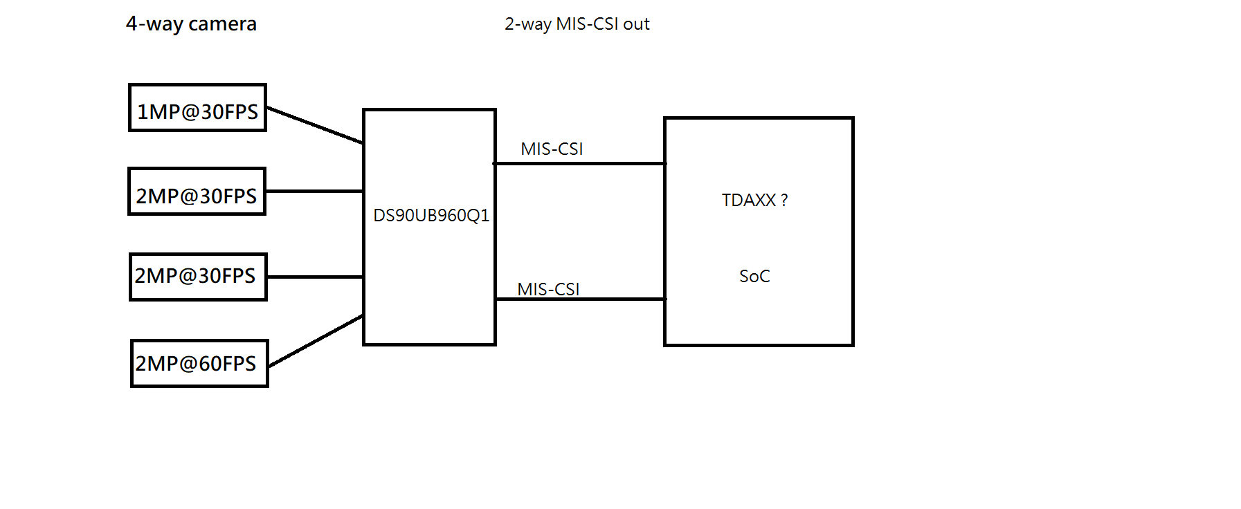

     I have some question on TDA2E's application.
    function block as below:
1. In this way, 960 has two CSI outputs, each of which is 4lane, but the input of my 960's 4-way camera is different. Now SOC has only 6lane. How to do it?
2. What's more, whether TDA2E can satisfy the video processing ability of four cameras alone?
thanks.
  • I think only one of the MIPI CSI input is used. The other interface is not currently used for 4channel capture..
    Yes, it is able to capture 4 channel 1MP @30fps frames.
    Processing requirement depends on your algorithm requirement..
    Rgds,
    Brijesh
