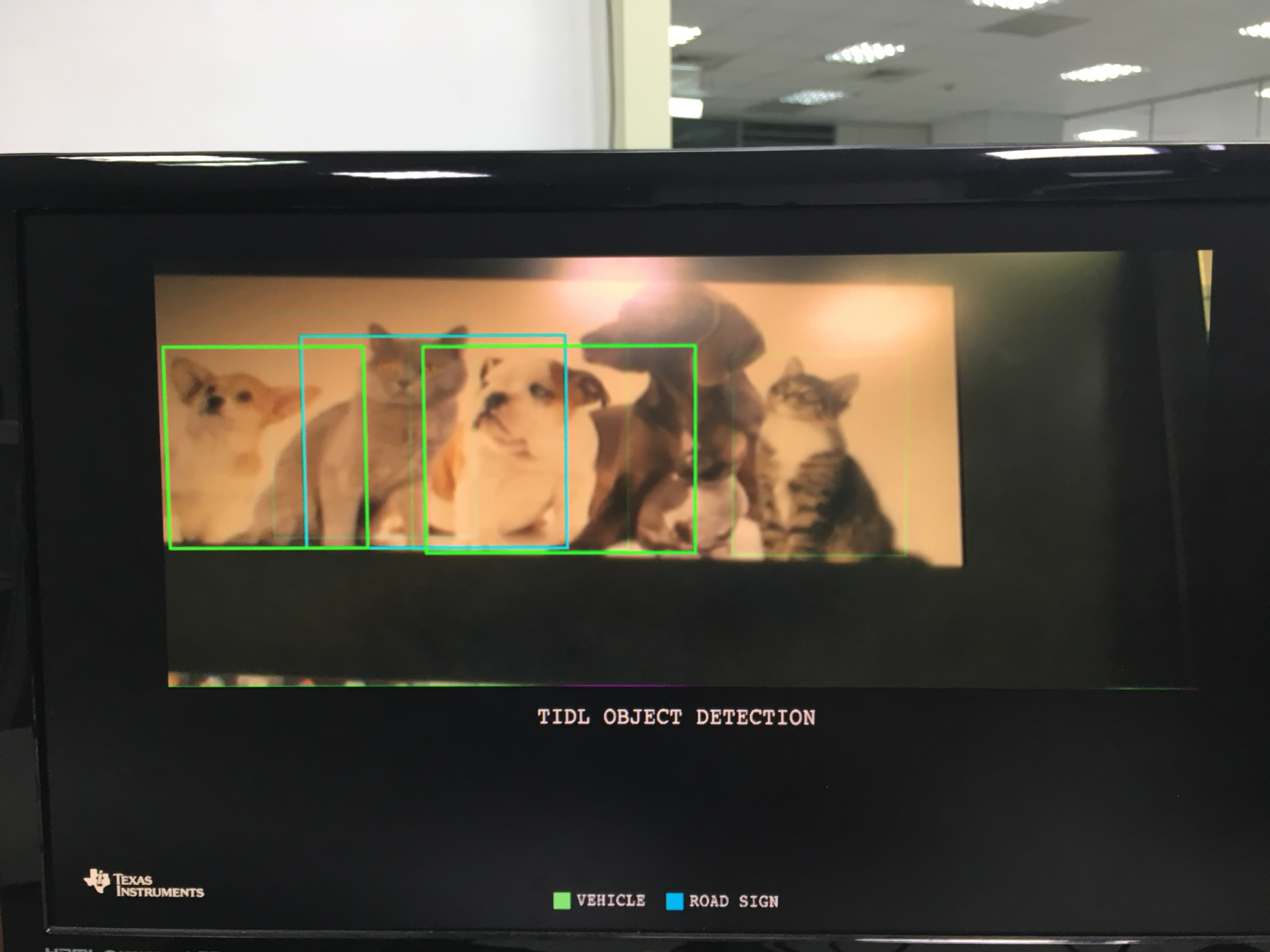

Are there any documents can guide me how / where to modify the visualization for TIDL OD results?
As attachment, I'm going to modify the category labels and the color of detected boxes.

Hi Gary,
you can look at function AlgorithmLink_objectDrawRectangles() in vision_sdk/apps/src/rtos/alg_plugins/objectdetection/objectDrawLink_algPlugin.c and try to modify it according to your needs.
