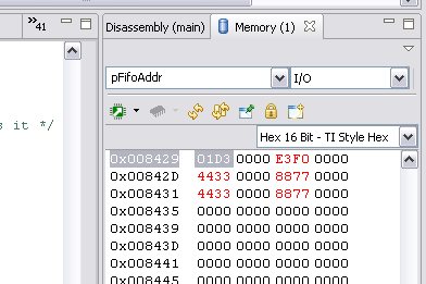

It seams as no matter how I setup and call USB_postTransaction in the csl_usb_intc_example. I never get the data in "usbDataBuffer" buffer that I'm sending from the host. In the FIFO i can see some of the data when breaking right after USB_postTransaction (when looking at "pFifoAddr" in the "USB_handleRx" function in the "csl_usbAux.h" file), but I never get anything in the "usbDataBuffer". I get this in the FIFO when I sent 0x1122334455667788 from the host:
It looks like I get the "4433" and the "8877" in the FIFO somehow but never gets to the usbDataBuffer (unless I modify "USB_handleRx" function to read from *(pFifoAddr+5) for example, which seams very wrong).

    The CCS memory window capture is not the content of the USB EP FIFO. It is the USB EP FIFO registers. for example, 0x8429 is the  FIFO2R1 Transmit and Receive FIFO Register 1 for Endpoint 2. You can read it word by word to get all the contents in the EP FIFO. That is what the USB_handleRx do. What triggers the USB_handleRx is the      (pContext->dwIntSourceL & CSL_USB_RX_INT_EP2)  in usb_isr() via USB_postTransaction(). To make sure you actually get data waiting in the EP2, you can add the following code before USB_postTransaction() in usb_isr():
