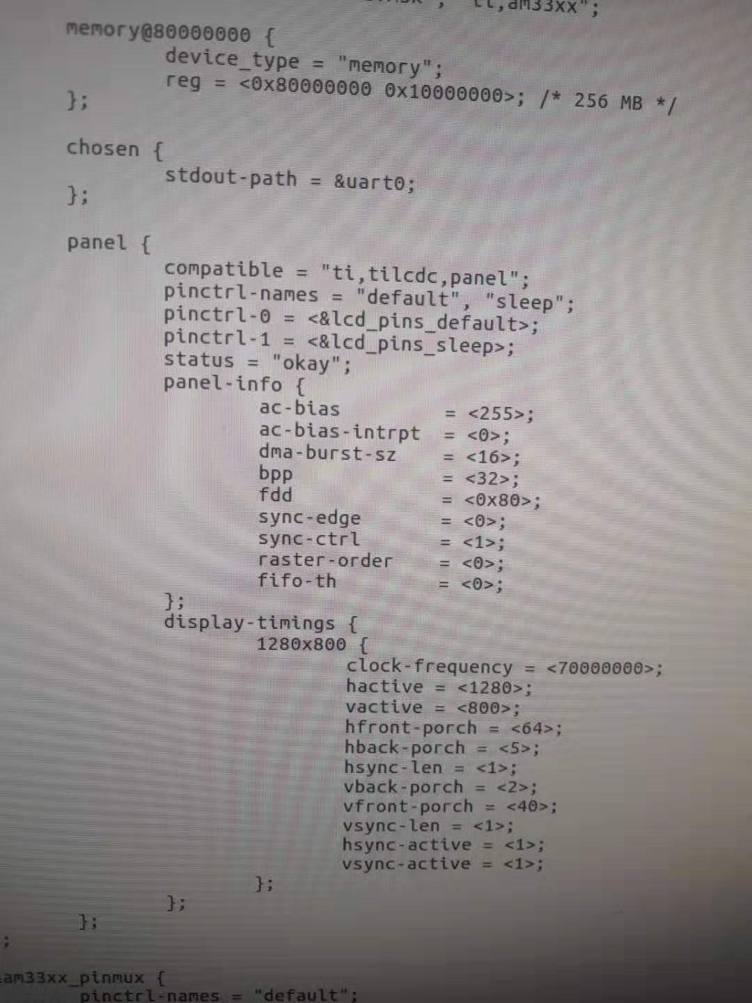

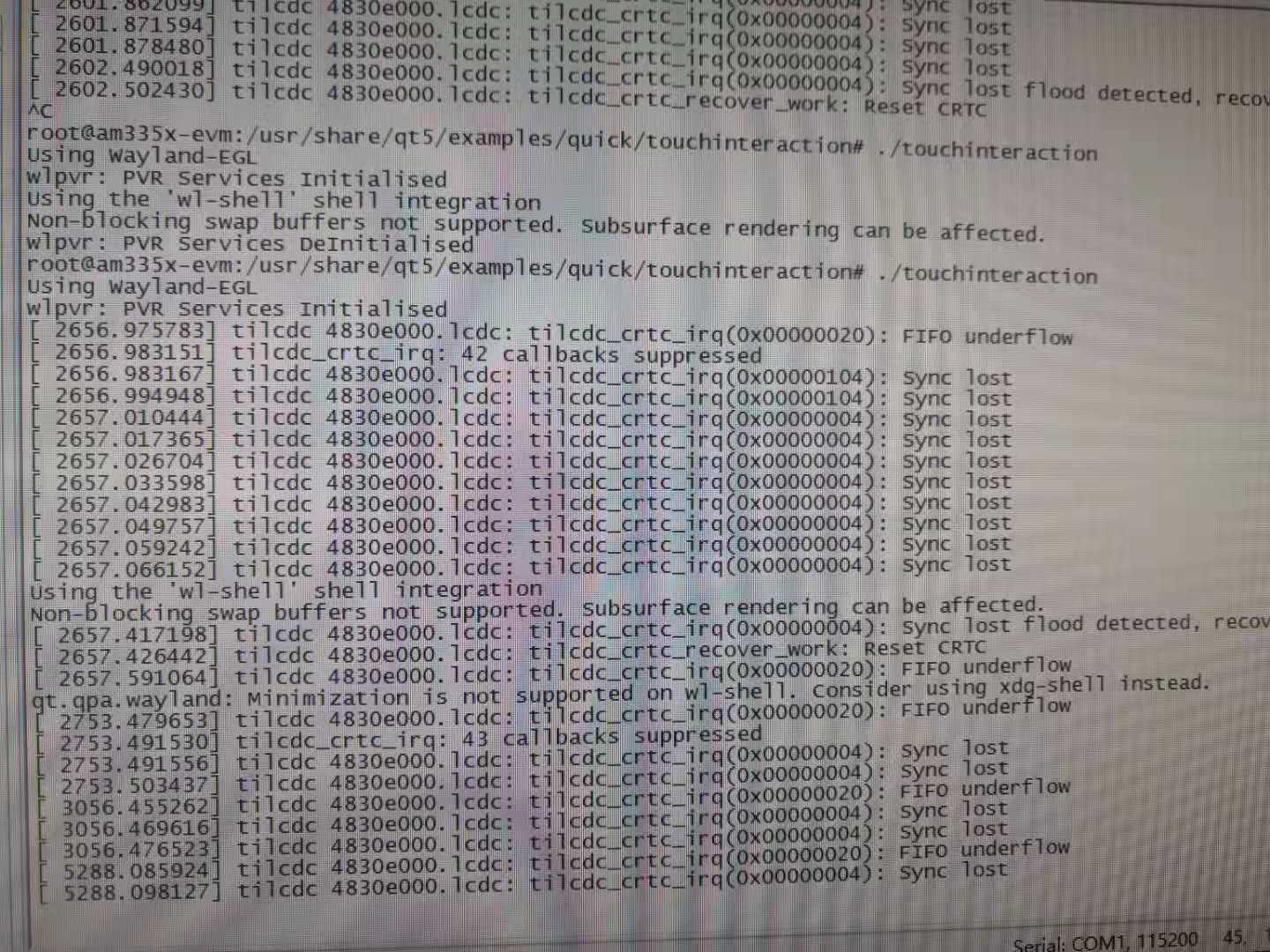

AM3354: LCD error
Part Number: AM3354
we are using process-sdk-linux-am335x-06.00.00.07,how to solve the above problem
  • Hi user4927006,
    Do you use AM335x TI board or custom board?
    Can you put your boot up log in txt file and attach this file here?
    Pavel
  • Hi Pavel Botev,
    We are using custom board

    [  130.387708] tilcdc 4830e000.lcdc: tilcdc_crtc_irq(0x00000020): FIFO underflow
    [  130.396966] tilcdc 4830e000.lcdc: tilcdc_crtc_irq(0x00000004): Sync lost
    [  130.403811] tilcdc 4830e000.lcdc: tilcdc_crtc_irq(0x00000004): Sync lost
    [  221.695429] tilcdc 4830e000.lcdc: tilcdc_crtc_irq(0x00000020): FIFO underflow
    [  221.703649] tilcdc 4830e000.lcdc: tilcdc_crtc_irq(0x00000004): Sync lost
    [  221.710413] tilcdc 4830e000.lcdc: tilcdc_crtc_irq(0x00000004): Sync lost
    [  221.721033] tilcdc 4830e000.lcdc: tilcdc_crtc_irq(0x00000020): FIFO underflow
    [  221.729233] tilcdc 4830e000.lcdc: tilcdc_crtc_irq(0x00000020): FIFO underflow
    [  221.736557] tilcdc 4830e000.lcdc: tilcdc_crtc_irq(0x00000104): Sync lost
    root@am335x-evm:/usr/share/qt5/examples/touch/fingerpaint#
    and the dts is based on am335x-evmsk.dts
     * Copyright (C) 2012 Texas Instruments Incorporated - http://www.ti.com/
     * This program is free software; you can redistribute it and/or modify
     * it under the terms of the GNU General Public License version 2 as
     * published by the Free Software Foundation.
     * AM335x Starter Kit
     * http://www.ti.com/tool/tmdssk3358
    /dts-v1/;
    #include "am33xx.dtsi"
    #include <dt-bindings/pwm/pwm.h>
    #include <dt-bindings/interrupt-controller/irq.h>
    	model = "TI AM335x EVM-SK";
    	compatible = "ti,am335x-evmsk", "ti,am33xx";
    	memory@80000000 {
    		device_type = "memory";
    		reg = <0x80000000 0x10000000>; /* 256 MB */
    	chosen {
    		stdout-path = &uart0;
    	panel {
    		compatible = "ti,tilcdc,panel";
    		pinctrl-names = "default", "sleep";
    		pinctrl-0 = <&lcd_pins_default>;
    		pinctrl-1 = <&lcd_pins_sleep>;
    		status = "okay";
    		panel-info {
    			ac-bias		= <255>;
    			ac-bias-intrpt	= <0>;
    			dma-burst-sz	= <16>;
    			bpp		= <32>;
    			fdd		= <0x80>;
    			sync-edge	= <0>;
    			sync-ctrl	= <1>;
    			raster-order	= <0>;
    			fifo-th		= <0>;
    			invert-pxl-clk  = <1>;
    		display-timings {
    			1280x800 {
    				clock-frequency = <70000000>;
    				hactive = <1280>;
    				vactive = <800>;
    				hfront-porch = <64>;
    				hback-porch = <5>;
    				hsync-len = <1>;
    				vback-porch = <2>;
    				vfront-porch = <40>;
    				vsync-len = <1>;

    &lcdc {
    	status = "okay";
    &sgx {
    	status = "okay";
  • Hi user4927006,
    You might need more LCDC memory bandwidth. Please refer to the below e2e threads for details:
    Pavel
  • Hi,Pavel Botev
    I tried
    #define EMIF_OCP_CONFIG_BEAGLEBONE_BLACK 0x00141414
    #define EMIF_OCP_CONFIG_AM335X_EVM 0x003d3d3d
    but did not resolve my issue.
    My DDR3 is cutom,please let me know how to get a correct .ocp_config value
    For settings AM335x EMIF optimal values, please refer to the below pointers:
    Pavel
