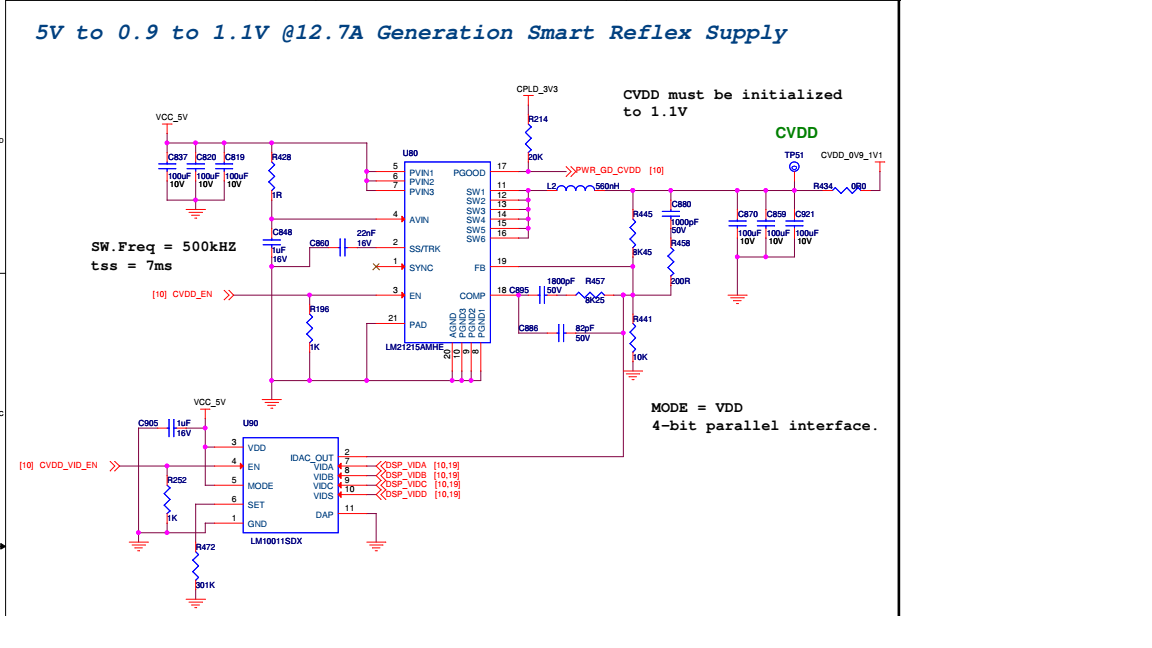

In one of the C6678 based board we delivered to customer, we are facing a peculiar issue as described below,
 Smart Reflex is disabled [VID is disabled]
  • Application is running in 8 different cores (8 different .out files), the same application is been tested in multiple other boards and it runs stable
  • Boot-loader loads Core#0 application, then Core#0 application will kick-start and run cores#1-7
  •  In this one particular board, whenever core#4 comes-up; the Processor is hanged and all the other cores stop running.
  • For experiment, we tried with different core clock frequency (from 100MHz to 1GHz),
    • All 8 cores are running stable for core clock frequency 100MHz to 850MHz
    • Beyond 850 MHz, core#4 issue is observed
    • When we try running remaining 7 cores (except core#4), all 7 cores are running stable even for 1GHz core clock
    • When we try running only core#0 and core#4 (only 2 cores), again the same issue is observed i.e. it is stable only upto 850MHz and beyond that processor is hanged.
As ,mentioned above, we have disabled the VID, because if we enable it, Core#0 itself is not able to boot up.
May I know SRVnom for the device ?
PS: Attaching the smart reflex circuitry.

  • Dear Tom,
    Actually we have an design flaw.
    The MODE pin of LM10011 is been pulled high, which sets the mode to 4bit. But the C6678 support 6 bit VCNTL interface.
    Would this create a problem?

  • Shekhar,
    Yes, 6-bit VID is a requirement.  Yes, having the LM10011 in the wrong VID mode can cause problems and this must be fixed.  Please also post the VCNTLID values for these devices.
    Tom

  • Dear Tom,
    With VID_EN, we have below details
    a) VCNTL reg : 11 0101 b => 1.039V
    b) Measured voltage across decap = 1.028V
    c) LM21215 + LM10011, as per board designed
    Reset=301k, Rfb1=8.45k, Rfb2=10k
    So theoretically calculated CVDD= 1.107 - 0.000507 = 1.106V.

  • Dear Tom,
    CVDD voltage drop was observed immediately after 0R [jumper] resistor kept b/w CVDD regulator source and load.
    So later, the 0R has been replaced by direct short through lead.
    By this implementation, there is only 10mV drop as compared to 65mV earlier.
    This was due to the resistor being "0.01 OHM 1W". Since large amount of current was needed by the DSP core load, more voltage was dropped at the 0R itself.
    Remark:  DSP all cores were now booting on all the 3 boards [18481001, 18481002, 18483002] with the same checksum.

  • Tom,
    We have now enabled AVS 6 bit mode.
    At load, Initial CVDD was 1.1V and  after DSP out of reset CVDD is 1.065V
    (VCNTLID = 11 1001) was read from 0x02350014h address

    One board which is failing is at almost 8 out of 10 trials
    DSP boots from NOR flash through EMIF16 interface.
    Boot Sequence:
    SBL boots from flash with some frequency
    Then it copies each Core content of flash to DDR3
    Then SBL launches Core0 through entry point of DDR3
    SBL makes PLL setting to 1GHz
    Core0 boots up with 1GHz
    Then Core0 launches all other 7 cores from their respective DDR3 entry points
    Failure occurs at high temperature when Core0 executes from DDR3 and fails in that.
    But this occurs only when PLL settings are in 1GHz
    As soon as make PLL settings with lesser frequency it boots even at higher temperature.
    55C is ambient temp, whereas DSP case may be at around 85C
    We are using Hi-Rel DSP.
    Case temperature of SDRAM is unknown.

    You may be surprised to hear that in one of our board, we are facing Core0 booting issue as soon as we enable smart reflex.
    We are totally stuck in finding where the issue is ?
    Our doubt is if with smart reflex disabled in board for few months and the board is used in continuous testing, will the DSP gets degraded??
    Has anyone faced the issue before ??

  • Dear Mukul,
    Does disabling smart reflex for longer period of time and continuing the testing for that period degrade the DSP.
    Because these boards had SR disabled for around 4 months and later with SR disabled chip had core booting issue even at room temperature.
    Now we got to know the importance of SR, so now we enabled SR and checked the DSP behavior, at little high temperature [around 60C] we are facing core booting issue.
    Please confirm whether the chip degradation results in above erratic behavior.
