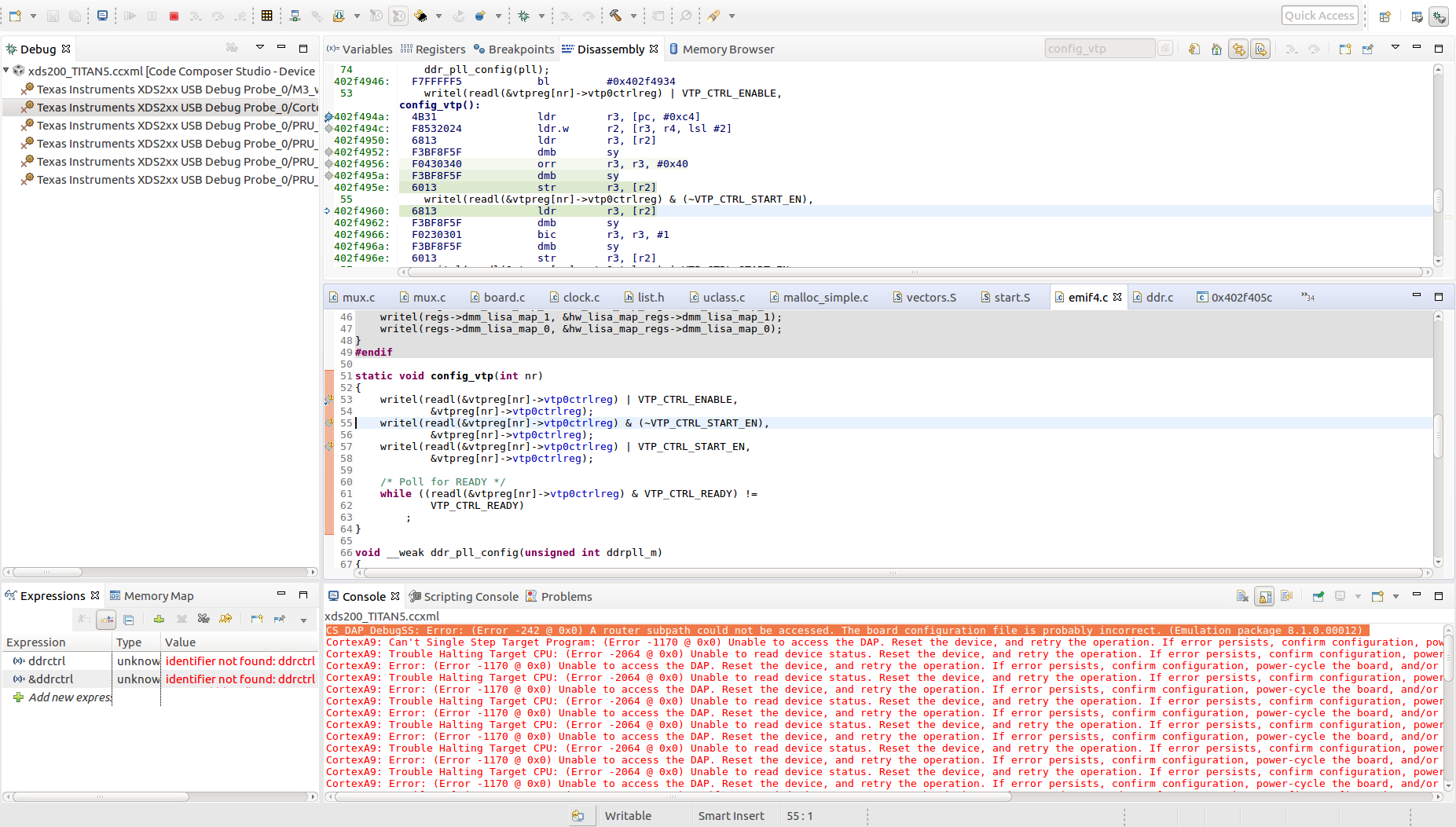

I am trying to boot linux when I power up our custom board.
In order to do that, here is what I did so far :
  • Since our board doesn't have an EEPROM, I hardcoded the name of the board to "AM43_IDK" in board/ti/common/board_detect.c
  • I modified the IDK AM437x pinmux config according the one of our custom board in arch/arm/dts/arm437x-idk-evm.dts
  • I modified the DDR3 configuration of the IDK AM437x in board/ti/am43xx/board.c with the configuration I generated with the AM437x EMIF Configuration Tool (which has been validated through CCS and Gel Files)
Then I generate a new U-boot and MLO by doing the following (in u-boot directory) :
  •     make CROSS-COMPILE=arm-linux-gnueabihf- distclean
  •     make CROSS-COMPILE=arm-linux-gnueabihf- O=My_Uboot am43xx_evm_defconfig
After that, I copy/paste the generated u-boot.img and MLO on the 'boot' partition of an SD card (which has been created using the create-sdcard.sh script)
When I power up the board with the SD card inserted nothing happens on the serial console (The Minicom setup has been verified)
Am I missing something or am I doing something wrong ?
I am using sdk Linux-RT am437x-evm 06.00.00.07.
Gilles

  • Hi Pavel,
    thank you for your answer. Thanks to CCS and JTAG, I could determine that the execution was hanging in the MLO/SPL.
    What I see is that when minicom (or another serial UART console) is active, the SBL crashes at do_lock_dpll(...) (in clock.c l.35 @0x402f42ac) after it recognizes the custom board as an IDK AM437x (it passes that part of the code before).
    The error message is : CortexA9: Can't Single Step Target Program: (Error -2134 @ 0x0) Unable to control device execution state. Reset the device, and retry the operation. If error persists, confirm configuration, power-cycle the board, and/or try more reliable JTAG settings (e.g. lower TCLK). (Emulation package 8.0.903.2)
    And when minicom is not active, the SBL crashes at config_vtp() (in emif4.c l.53 @0x402f495e), which comes after the other one.
    This time, the error message is  : CortexA9: Error connecting to the target : the controller has detected a power loss...
    Do you have any idea on what is causing that to happen ?
    Gilles
  • Gilles,
    Do you use AM437x TI PSDK Linux v6.00?
    Have you made any changes in these two files or you are using the default source code?
    u-boot-2019.01/arch/arm/mach-omap2/am33xx/clock.c
    u-boot-2019.01/arch/arm/mach-omap2/am33xx/emif4.c
    When you switch to UART boot, do you have CCCC stream on your console?
    I can suggest you to enable debug() and early print messages in u-boot, thus you can get more verbose output.
    I would also suggest you to check:
    - EEPROM ID check
    - DDR3 configuration
    Pavel

  • Pavel,
    Thank you for your answer. I guess pinmux was not the issue here. Regarding the errors that I listed above, they both seem to be related with my DDR3 configuration (dpll and vtp).
    When it comes to the DDR3, I have only modified board.c. Is there another file involved ? The configuration has been validated through CCS/Gel files
    Gilles
  • Gilles,
    When minicom is active, does your boot flow hang at do_lock_dpll() that is called by do_setup_dpll(&dpll_ddr_regs, params)? If yes, you need to check your DDR DPLL settings, compare the settings with AM437x TI boards (EVM, SK, IDK).
    Regarding AM437x DDR config, refer to below pointers:
    You might also have HW malfunction of your custom board, check if below doc will be in help:
    You might also run memory diagnostic test (mem_TEST) on your custom board. This test is designed for AM437x TI boards (EVM, SK, IDK) so you might need to adjust it for your custom board.
    I can also provide you below debug hints:
    - AM437x IDK is using UART0 for console. Check which UART instance is used on your custom board
    - pinmux is done in am437x-idk-evm.dts and in u-boot/board/ti/am43xx/mux.c files
    - DDR3 config is done in u-boot/board/ti/am43xx/board.c
    Pavel
  • Pavel,
    Thank you once again for your answer,
    I removed the RTS and CTS on my RS232->USB cable and it (somehow?) solved the issue with dpll.
    I am now left with that issue with vtp :
    Is 'The board configuration file' that is mentioned referring to the DDR configuration in board.c ?
    Gilles
  • Hi Gilles,
    This is below file:
    u-boot-2019.01/board/ti/am43xx/board.c -> sdram_init() -> config_ddr()
    The issue is most probably caused by DDR3 HW malfunction. See also if below e2e threads will be in help:
    Pavel
