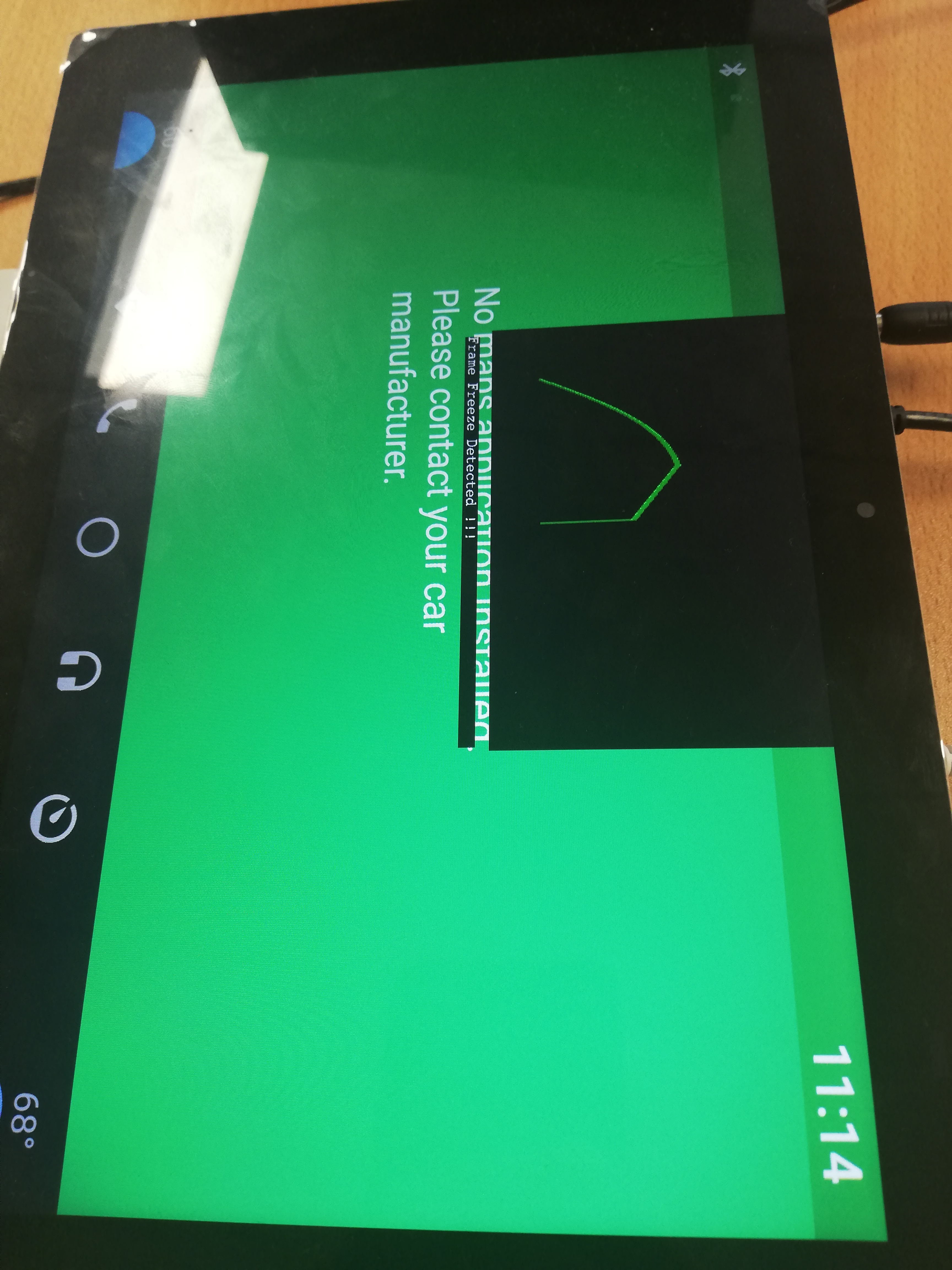

we are developing a SDK_VISION application on   TDA2XX_EVM for rvc and trying to use  these algo ALG_drawRearview ALG_swcrc ALG_rvcDiags  to draw a dynamic Steering_lines  , thanks to to an algorithm called ACKERMANNSTEERTINGMODEL the rvc show two dynamic lines which they are moving from right to left and vis-versa , my question is there any document or wiki to understand how to configure and manipulate this algo for example changing the speed of moving , the angle of deviation and the starting position ?

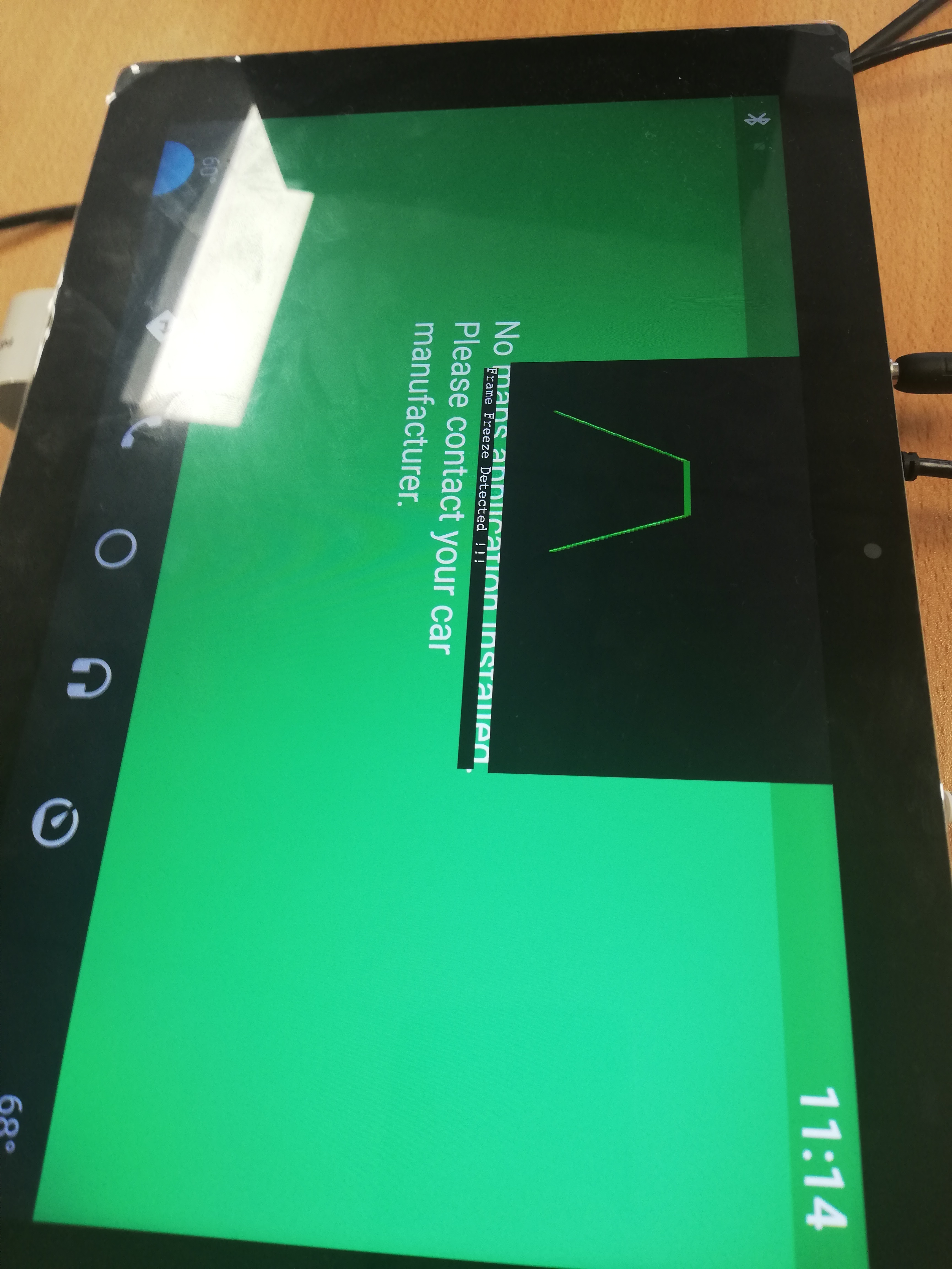

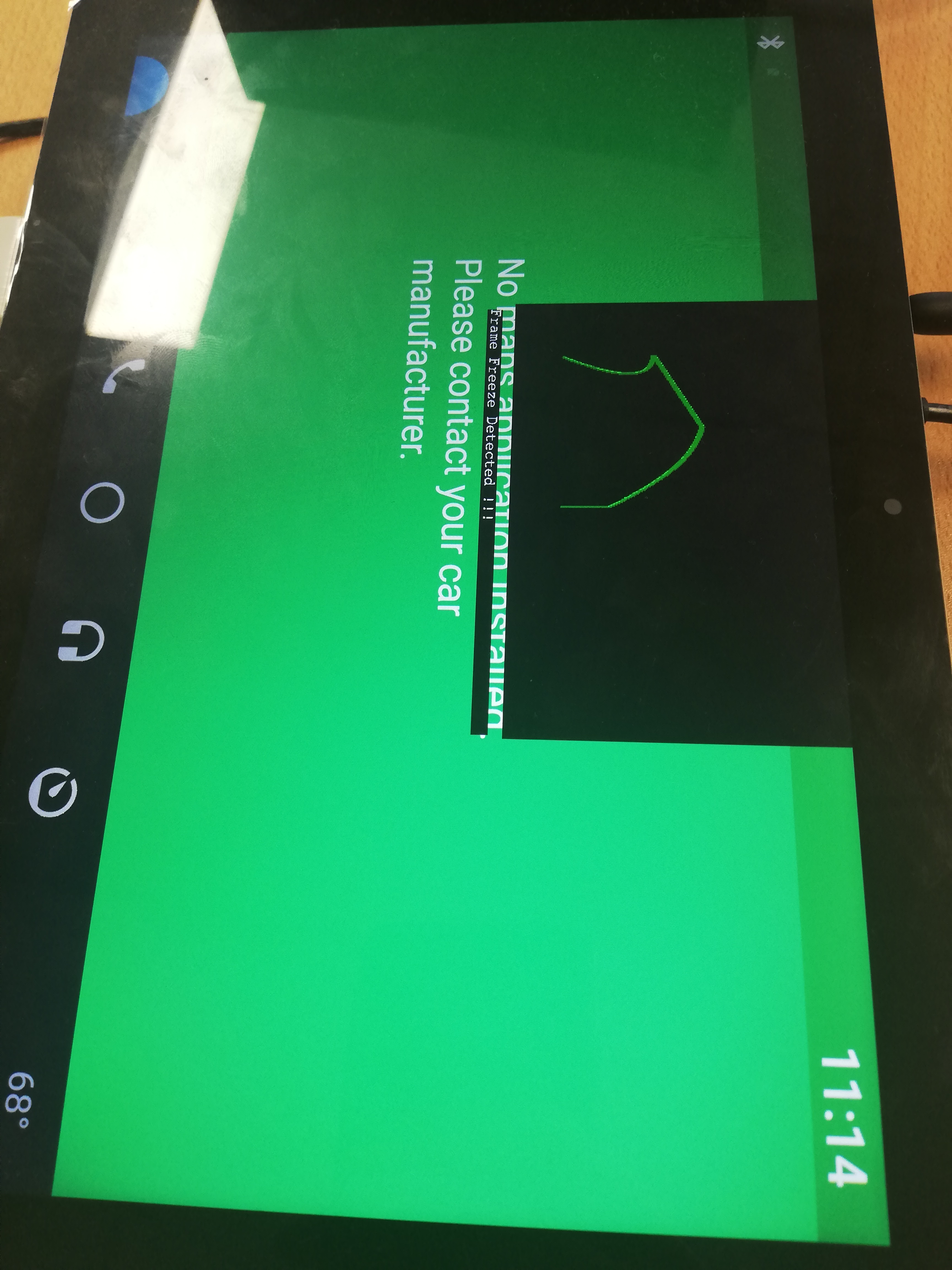

    For now i am able to modify  the parameters of the ALGO  such as the the height the width , position etc ,but what i really worry about is the color of the lines  i tried my format of color system for example SYSTEM_DF_YUV420SP_UV or RGB4444  but i can't print a RED color or an other color just there is the green and pink .
    Best regards
    AHMED
  • Hello DAVID ,
    I still working on the rearview camera using the same usecase , i blocked on an issue with the colors of the lines , i cannot change the color of the lines , using the alg_plugins drawRearview it mentioned that the Supported formats are SYSTEM_DF_YUV422I_YUYV, SYSTEM_DF_YUV420SP_UV , I tried the both , the color are wrong just the there are two color the green and pink can appeared , even with the format rgb no changes in the color! is the any other config i can do ?

    I tried all the defined colors in apps/src/rtos/alg_plugins/drawRearview/drawRearviewLink_priv.h  and stil appears only a green or purple colors  ,I can change the Draw2D_drawLine params but the color  i cannot , I tried also the other format .
    // Draw2D_LinePrm linePrm1;
    linePrm1.lineColorFormat = SYSTEM_DF_YUV420SP_UV;
    linePrm1.lineSize =14;
    linePrm1.lineColor =0x5EA1F3;
    I wondered why i can change the colors from the grpxSrcLink_tsk.c  using the SYSTEM_DF_BGRA16_4444 & SYSTEM_DF_BGR16_565 format  displaying in VOUT2 !

  • Hello Ahmed,
    Could you please confirm which use case you are running?  Are you using the iss_mult_capture_isp_dewarp_3dsv_rearview_tda3xx use case?  I do not see any camera output in the attached pictures, so it appears that this use case may not be running.  Please confirm the colors that are seen when running this use case.
    I ask because this algorithm link was intended to run with this use case.  The input buffer to this link must be of format SYSTEM_DF_YUV420SP_UV or else the colors will not be as expected.  If you have created a new use case, please query the input buffer format to confirm that it is in fact SYSTEM_DF_YUV420SP_UV.  This could explain why you are seeing the correct colors in grpxSrcLink_tsk.c but not in the draw rearview link.

    I am usisng the use case chains_vipSingleRvcCamCrc_Display and the dataformat it configured to support the SYSTEM_DF_YUV420SP_UV , for the camera actually its not connected in those pictures but its works fine .
    You can see my use case below :
    UseCase: chains_vipSingleRvcCamCrc_Display
    Capture -> Alg_RvcDiagnostic -> VPE_dei -> Alg_drawRearview (DSP1) -> Display_Video
    Capture_dsswb -> Alg_SwCrc (DSP1)
    GrpxSrc -> Display_Grpx
    Ahmed
  • Hi Ahmed,
    Can you check in "chains_vipSingleRvcCamCrc_Display.c" chains_vipSingleRvcCamCrc_Display_SetVpePrms() what dataFormat is being set for VPE output? We're expecting that you need to match that color format for the drawing to work correctly.
    Does the Alg_drawRearview output look basically the same with the camera connected as well?
    David
  • Hello David
    You helped me a lot thank you , a solved my problem , its the format of vpe buffer from chains_vipSingleRvcCamCrc_Display_SetVpePrms as you said . so i changed it and the color gets correctly works. But this effected  my lines draw , i guess  there are a scale can be changed and depends into the dataFormat input because the size and the position hey are multiplied by 2 . Do you have an idea where to set ?
