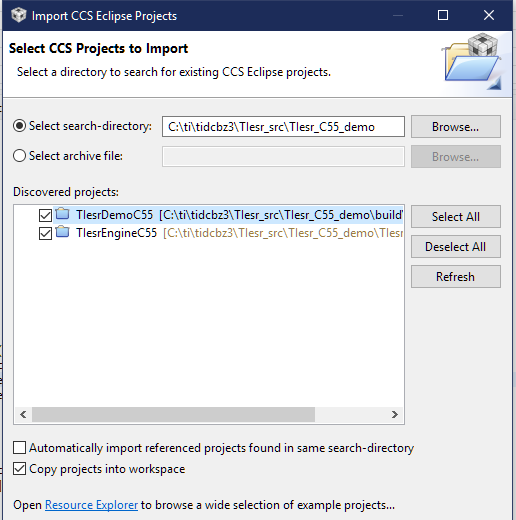

    The two CCS projects, TIesrDemoC55 and TIesrEngineC55, are located in TIesr_src/TIesr_C55_demo/ and can be imported to CCS.
    Sahin
    Is one of the projects this one:
    TIesr_src\TIesr_C55_demo\TIesrEngineC55\ccsv5\.ccsproject    ?
    There is no similar set of files for TIesrDemoC55. Please advise.

  • In CCS, go to File > Import > Code Composer Studio > CCS Projects > Next > browse to the "TIesr_C55_demo" folder and click OK. You should be able to import the projects as shown in my screenshot below.

    Thank you for your help! The project showed up exactly as you described. When I tried to build I got these messages:
    **** Clean-only build of configuration Debug for project TIesrDemoC55 ****
    "C:\\ti\\ccsv6\\utils\\bin\\gmake" -k clean
    DEL /F  "TIesrDemoC55cfg.h" "TIesrDemoC55cfg.h??"  "TIesrDemoC55.cdb"  "TIesrDemoC55.out"  "TIesrDemoC55cfg.cmd" "TIesrDemoC55cfg.s??" "TIesrDemoC55cfg_c.c"  "TIesrDemoC55.hex"
    DEL /F "TIesrDemoC55cfg_c.pp" "audio_data_collection.pp" "codec_aic3254.pp" "gd_config.pp" "gd_dim.pp" "gd_gconst.pp" "gd_hmm.pp" "gd_mixture.pp" "gd_mu.pp" "gd_net.pp" "gd_pdf.pp" "gd_tran.pp" "gd_var.pp" "gd_word.pp" "gpio_control.pp" "lcd_osd.pp" "pll_control.pp" "recognizer.pp" "sys_init.pp" "user_interface.pp"
    DEL /F "TIesrDemoC55cfg.pp"
    Could Not Find C:\tiworkspace_v6_1\TIesrDemoC55\Debug\TIesrDemoC55cfg.pp
    DEL /F "TIesrDemoC55cfg.obj" "TIesrDemoC55cfg_c.obj" "audio_data_collection.obj" "codec_aic3254.obj" "gd_config.obj" "gd_dim.obj" "gd_gconst.obj" "gd_hmm.obj" "gd_mixture.obj" "gd_mu.obj" "gd_net.obj" "gd_pdf.obj" "gd_tran.obj" "gd_var.obj" "gd_word.obj" "gpio_control.obj" "lcd_osd.obj" "pll_control.obj" "recognizer.obj" "sys_init.obj" "user_interface.obj"
    Could Not Find C:\tiworkspace_v6_1\TIesrDemoC55\Debug\TIesrDemoC55cfg.obj
    'Finished clean'
    **** Build Finished ****
    Buildfile generation error occurred..
    Referenced project 'cslVC5505' does not exist in the workspace. Project 'TIesrDemoC55' may not build as expected.
    Build stopped..

    Sorry for these verbosity, but I think it does build correctly
    Here are the messages for the TIesrDemoC55 project:
    Could Not Find C:\tidcbz3\TIesr_src\TIesr_C55_demo\build\ccsv5\Debug\TIesrDemoC55cfg.h
    Could Not Find C:\tidcbz3\TIesr_src\TIesr_C55_demo\build\ccsv5\Debug\TIesrDemoC55cfg_c.pp
    Could Not Find C:\tidcbz3\TIesr_src\TIesr_C55_demo\build\ccsv5\Debug\TIesrDemoC55cfg.pp
    Could Not Find C:\tidcbz3\TIesr_src\TIesr_C55_demo\build\ccsv5\Debug\TIesrDemoC55cfg.obj
    'Finished clean'
    Cannot build project. Referenced project 'TIesrEngineC55' contains build-errors.
    Build stopped..

    Lots of header files that can't be found, including standard one, like std.h
  • Hello again,
    It appears that many include directories were wrong. I hope(looking at siinit.c source) that std.h is coming from the bios includes. Fixing that and an additional level of indirection in CSL made the compilation of both C55CSL_LP and TIesrEngineC55 possible, with a few warning for variables being declared but not being used, which I assume is OK, hopefully, happens all the time.
    I also fixed the CSL and BIOS includes for the TIesrDemoC55, but there still remain unresoved things, which I do not know where to look for. Please advise.
    Vladimir
    Here are the messages from the compilation of TIesrDemoC55 project:

    'Invoking: C5500 Compiler'
    "C:/ti/ccsv6/tools/compiler/c5500_4.4.1/bin/cl55" -v5515 --memory_model=huge -g --include_path="C:/ti/ccsv6/tools/compiler/c5500_4.4.1/include" --include_path="C:/tidcbz3/TIesr_src/TIesr_C55_demo/build/ccsv5/Debug" --include_path="C:/ti/bios_5_42_02_10/packages/ti/bios/include" --include_path="C:/ti/bios_5_42_02_10/packages/ti/rtdx/include/c5500" --include_path="C:/c55xx_csl_3.00/c55_csl_3.08/inc" --include_path="C:/tidcbz3/TIesr_src/TIesr_C55_demo/inc" --include_path="C:/tidcbz3/TIesr_src/TIesr_C55_demo/C55/TIesrEngine/src" --define=c5515 --define=C55x --define=PF_C5535_EZDSP --undefine=PF_C5515_EVM --display_error_number --diag_warning=225 --gen_func_subsections=on --ptrdiff_size=32 --algebraic --preproc_with_compile --preproc_dependency="user_interface.pp"  "C:/tidcbz3/TIesr_src/TIesr_C55_demo/src/user_interface.c"
    'Finished building: C:/tidcbz3/TIesr_src/TIesr_C55_demo/src/user_interface.c'
    gmake: Target `all' not remade because of errors.

    Vladimir
    Finally I got it to build an .out file. I would like to test now, so as per the instructions, I created a configuration file. When clicking on View and then Target Configuration, then expand User Defined, I do not see my configuration just created. I try a connection test then from the middle pane of CCS, and get this:

  • Well, seems the pain is still there. Don't use the small USB connector with a cable, but the direct one. Fine, I did. Reopened the CCS. Connectivity with the kit is there, but, TIesrEngineC55 project showed some errors, compilation, don't know why, since nothing had changed since last time it worked, fixed it. TIesrDemoC55 also showed errors, fixed some path and it did compile. But... this time didn't produce an out file. Here are the errors in linking:

    I don't know if this is the right BIOS version, but this is the one that was suggested when I started the project a couple of days ago. And nothing had prevented the link a few hours ago.
    Vladimir
    It even works: T I voice trigger :)
    I wish tools were a bit more intuitive.
