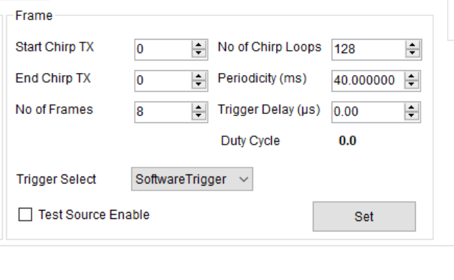

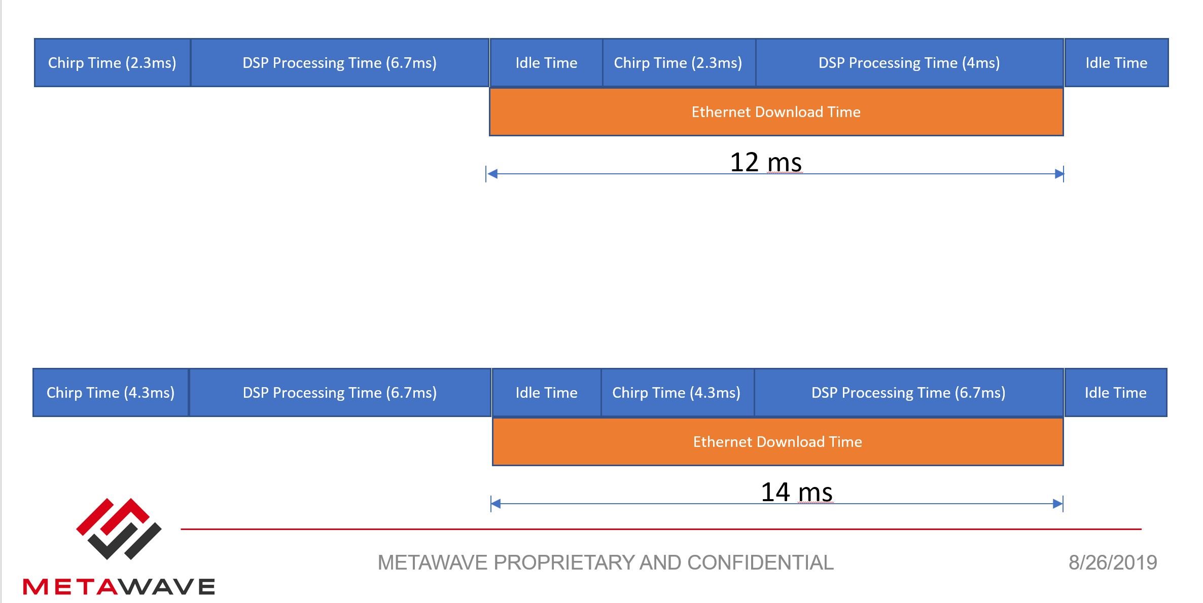

Hi Piyali/Stanley,
I am re-opening this issue which I worked with both of you 4 months ago regarding frame rate seen at Ethernet output. Back then, we got to a point where I am happy with what I've seen and closed the case. I used to have a single profile at that time and am able to get the frame rate very much followed that of the frameperiodicity specified in the rlFrameCfg_t data structure. Today, we now have 4 profiles and allow dynamically switch between them from network control on a Host. Attached is our AWR config c file that defines the 4 chirp configurations.

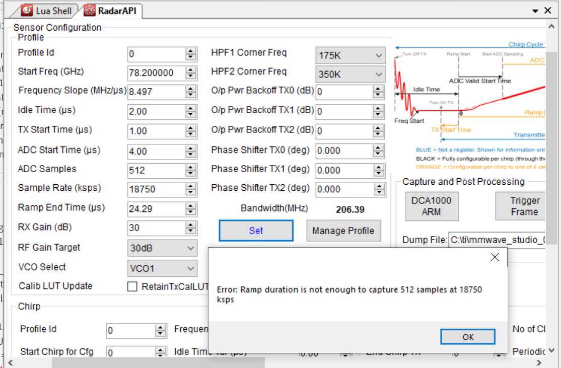

As you can see, I have 4 rlFrameCfg_t objects for the 4 corresponding profiles. FramePeriodicity is selected for each rlFrameCfg_t object after I thought I completely understood how much time it takes to acquire + processing + Ethernet download time based on experiments. The 4RX RDM size of 128x256 + PkDetect data would require FramePeriodicity = 14ms while 4 128x128 RDMs + PkDetect data would take 12ms. Please see attached Timing Diagram.
However, when running doing performance measurement from a Linux Host PC using the network monitoring tool, I observed that only profile 0 yields the accurate frame rate per the defined FramePerdiocity of 14ms or 71 fr/s. Profile 1-2, I got Ethernet frame rate 43 fr/s, Profile 3, I got 36 fr/s. I expect the Profile 1-2 to do even better at 83 fr/s and Profile 3 should be the same as Profile 0.
I then twiddle with the rampEndTime parameter in rlProfileCfg_t by setting rampEndTime in all Profiles to have the same value as Profile 0 (30.87). To my surprise, all Profile's frame rates are now running based on the defined FramePerdiocity for each profile. What does FramePerdiocity have to do with rampEndTime ? Why does rampEndTime also dictate the output frame rate?
--Khai

  • Hi Piyali,
    Thanks for taking my inquiry. If you open the attached c file chains_common_LRR_ar12xx_config.c, you will notice that I have 4 rlFrameCfg_t instances from gAr1243FrmArgs_RadarMode1,2,4,5. These are my radar modes with different chirp specs. The framePeriodicity was defined for each mode. Mode1 has 14ms, Mode2 has 12ms, Mode4 has 12ms and Mode5 has 14ms.
    So in the timing diagram, I have 4.3ms allocated for chirp ramp in Mode1 and Mode5 while 2.3ms allocated for chirp ramp in Mode2 and Mode4. Notice that Mode1 and Mode5 chirp ramp doesn't require a whole 4.3ms based on the formula you indicated. But it doesn't hurt.
    The reason I have 12ms and 14ms Ethernet download time is because that's how long it takes to download in 4 RX cube size. This download timing also includes PkDetect target list.
    --Khai

  •  Hi
    I checked the profile config with mmWave Studio.
    It does not seem to be valid. See attached snapshot
    Thank you
    Cesar
  • HI Cesar,
    numAdcSamples         = (rlUInt16_t) AR1243_RADAR_WIDTH_256
    not 512.
    --Khai
