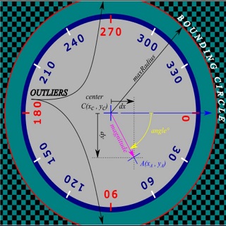

Hi Garnet,
The spec file is from the lens vendor for specifying the lens distortion curve.
The first column is for the angle between incoming light ray and optical axis and the second column is for the height of the image point in the imaging plane.
