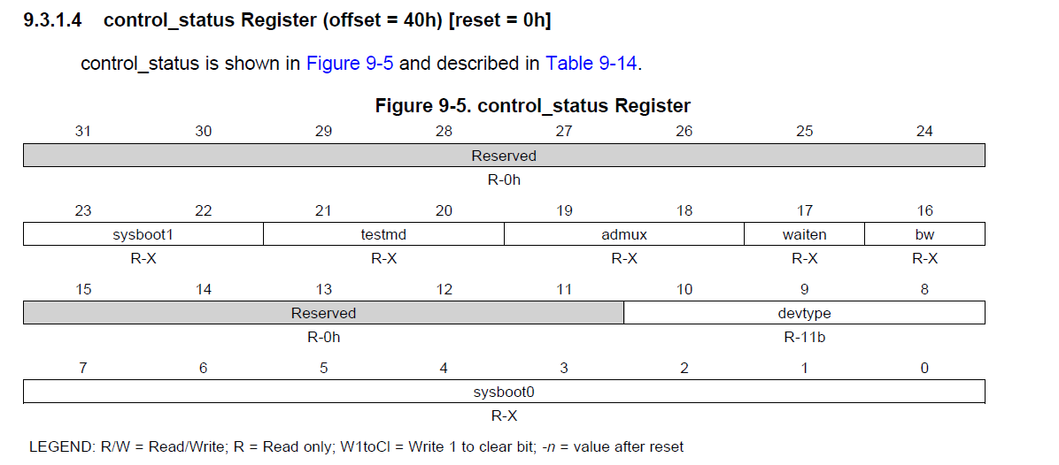

    3. If the board does not boot, please connect to CCS and share the value of the control status register:

    Watchdog is enabled in the ROM code but disabled very early in the SPL stage. After the board fails to boot, please connect the CortexA8 processor using CCS (no gel files) and read the Program Counter (Registers Window). The SPL is executed in RAM and the start address for RAM is 0x402F_0400. Also, you should be seeing the warm reset signal toggle when the WD times out (ROM code).
