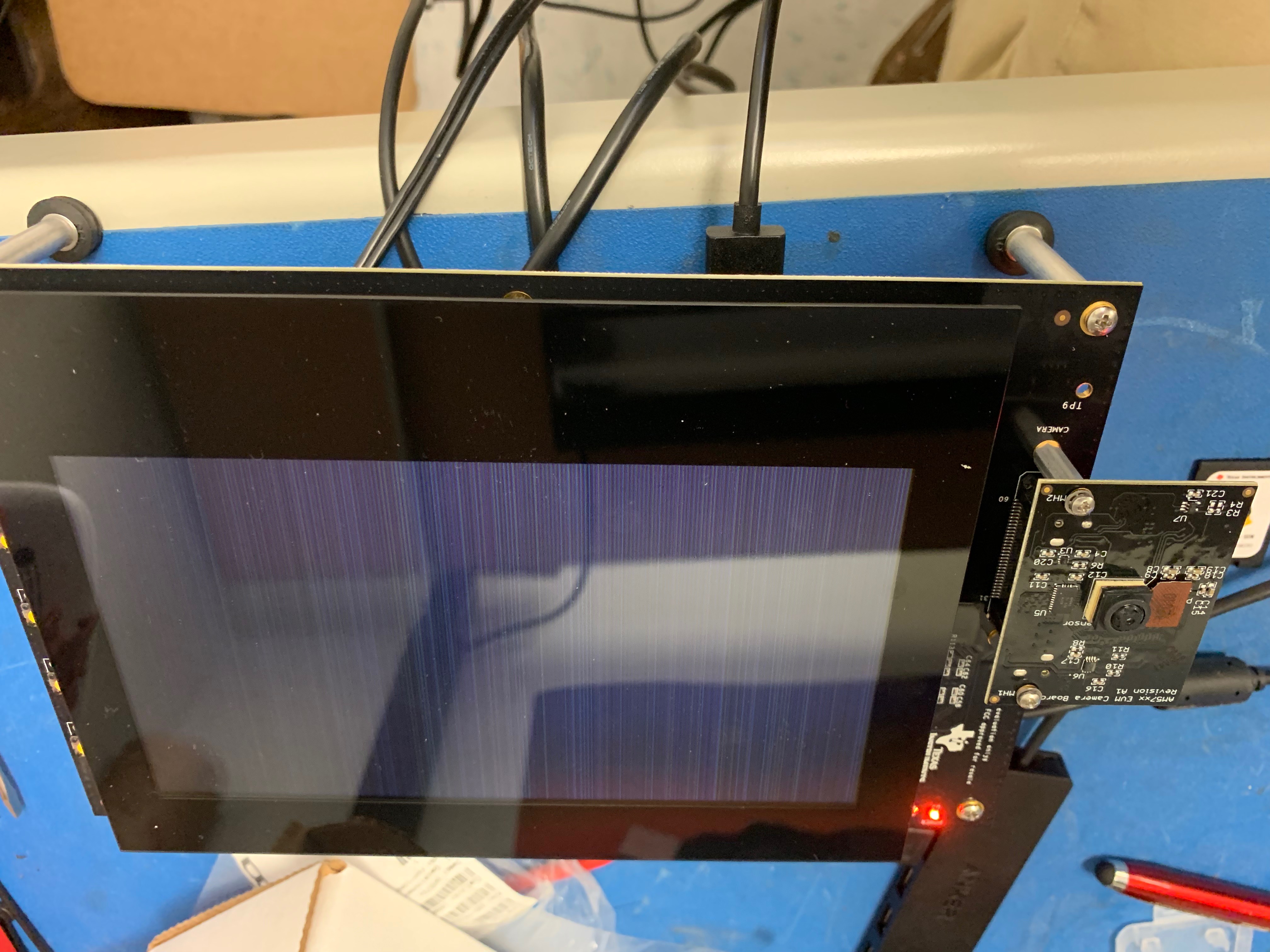

I am attempting to get the TMDSCM572X Revision A1 camera module running with my AM572x eval module.  However am running across the same issue as a lot of folks on this forum where ' video1' does not show up in devices.
The output of the troubleshooting commands:
root@am57xx-evm:~# dmesg | grep mt9t
[    3.872454] mt9t11x 4-003c: input-clock-freq: 32000000
[    3.872459] mt9t11x 4-003c: pixel-clock-freq: 96000000
[    3.872463] mt9t11x 4-003c: GPIO lookup for consumer reset
[    3.872467] mt9t11x 4-003c: using device tree for GPIO lookup
[    3.872513] of_get_named_gpiod_flags: parsed 'reset-gpios' property of node '/ocp/i2c@4807c000/mt9t11x@3C[0]' - status (0)
[    3.872555] mt9t11x 4-003c: GPIO lookup for consumer powerdown
[    3.872558] mt9t11x 4-003c: using device tree for GPIO lookup
[    3.872574] of_get_named_gpiod_flags: parsed 'powerdown-gpios' property of node '/ocp/i2c@4807c000/mt9t11x@3C[0]' - status (0)
[    3.872589] mt9t11x 4-003c: GPIO lookup for consumer oscen
[    3.872592] mt9t11x 4-003c: using device tree for GPIO lookup
[    3.872606] of_get_named_gpiod_flags: parsed 'oscen-gpios' property of node '/ocp/i2c@4807c000/mt9t11x@3C[0]' - status (0)
[    3.872615] mt9t11x 4-003c: GPIO lookup for consumer bufen
[    3.872618] mt9t11x 4-003c: using device tree for GPIO lookup
[    3.872631] of_get_named_gpiod_flags: parsed 'bufen-gpios' property of node '/ocp/i2c@4807c000/mt9t11x@3C[0]' - status (0)
[    3.872640] mt9t11x 4-003c: GPIO lookup for consumer camen
[    3.872642] mt9t11x 4-003c: using device tree for GPIO lookup
[    3.872656] of_get_named_gpiod_flags: parsed 'camen-gpios' property of node '/ocp/i2c@4807c000/mt9t11x@3C[0]' - status (0)
[    4.018829] mt9t11x 4-003c: Product ID error ffffff87
root@am57xx-evm:~# v4l2-ctl --list-devices omapwb-m2m (platform:omapwb-m2m): /dev/video10 vpe (platform:vpe): /dev/video0
I am using the 6.00.00.07 SDK. I've tried to copy over the am57xx-evm-cam-mt9t111.dtb and then modify the uEnv.txt in the boot partition to below:

fdtfile=am57xx-evm-cam-mt9t111.dtb
However when I do this I get lines on the screen a shown in the picture. Is this a software issue or a hardware issue? If it's hardware is it the camera board or the eval board?
    Once you modified the dtb file, were you able to see "video1" showing  up when you ran <v4l2-ctl --list-devices> cmd? If yes, then the lines on the display suggest that display panel is having loose connection with main board. Can you please check that.
    Manisha
  • Unfortunately I have never seen "video1" show up regardless of what .dtb file I use...  Assuming the camera board is bad, how do I order a non-Rev A.1 board to make sure I get a working camera?

  • Hi Bill
    Thanks for the workaround. I was dealing with this problem for more than a month and this workaround solved it. Although it really bothered my eyes! I applied it on my 2 TMDSCM572X modules. The other one was dead for more than a year and  suggested to buy a new one.
    I have posted photos of my module here:
  • I finally got a Rev. C. Camera and after changing the .dtb file to the rev C version it finally worked.  Nothing else worked for me, however I did not try adding a wire to the circuitry as another thread suggested.
    Thanks for the help.
