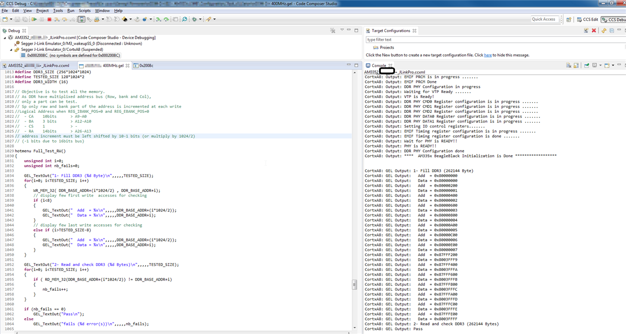

In fact I've updated the xlsx file to match my memory PN ISSI IS43TR16128C-15HBLI.
Anyway, I've tryed the value from the orignal xlsx you sent me.
I attach you a screen shot CCS with gel, log and memory dump at test#2 step. I've simplfied the log message to make it more clear to provide this screen shot and display the memories content at 0x8000_0000, 0x4030_0000, 0x4030_0800 and , 0x8000_0800
We can see @ 0x8000 0000 the pattern written in DDR3 during test 2 then the content of internal memory at 0x0403 0000 after DMA transfert
> After this DMA transfert we should get the same as DDR3 in internal RAM. What I get in internal RAM is the pattern of TEST 1!
We can see @ 0x0403 0800 the pattern written in internal memory during test 2 then the content of DDR3 at 0x8000 0800 after DMA transfert
> This DMA transfert is OK
I get the same for test 3 to 8. I don't show to make the screen shot more clear and make the test iteration faster.
I don't understand why DMA transfert from DDR to internal does work on test 2 to 8 while it work on test 1 and while I don't get any issue with DMA transfert from internal RAM to DDR.
Sebastien

what's your point of view about it?
Sébastien
Sebastien, I'm still not sure why you are having trouble with the DMA. What you are doing should be possible.
Can you check to see if you are having some addressing issue by doing the following: Write a unique value to each location of DDR (for example, write 0x80000000 to address 0x80000000, write 0x80000004 to address 0x80000004, etc). You should be able to write a quick GEL script for this. This will check to make sure you don't have any addressing issues or aliasing going on.
I tried your same test case GEL functions on my EVM, and it passed. So you may want to expand the test to different addresses to maybe see a pattern.
James
Dear James,
I did the test you ask me but it is a long too long test (256MB ram size). So I used the Row / Col addressing mode of the memory to reduce the test time by 1024 (because my memory as 10 bit col address).
So my test loop test only the 14+3 bits (Row addess + bank) shifting the incremented valeur by 10 bits according to the REG_IBANK_POS value and the REG_EBANK_POS value
The result is pass.
May it possible to share the GEL file you use on you EVM? Here I don't have other board having a JTAG connector. So I cannot try with other plateform?
Sébastien
Hi James,
I've tested your attached GEL. It also Fails.
So I updated my CCS version and my segger Jlink Driver. It also fails.
I replace the Segger Probe by the spectrum Digital XDS200 Jtage prod. Now it PASSES!
I loop the EDMA test the full night and all tests have passed.
The issue is solved with the XDS200 JTAG probe. I will not spend time in investigate why Segger Probe make EDMA test Fail.
Thank's a lot for your great support.
