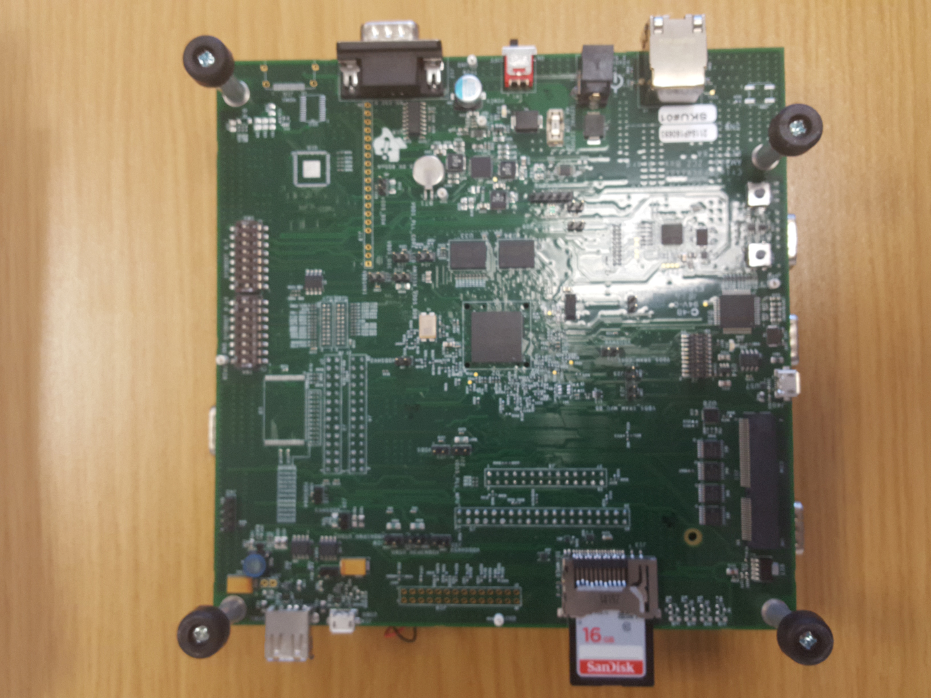

    Which AM335x EVM do you have? There are several. You can post a photo if unsure.
    here are some photos.
  • OK, this is the AM335x GP EVM. Here is the User Guide for it: http://processors.wiki.ti.com/index.php/AM335x_General_Purpose_EVM_HW_User_Guide
    read especially section 4 and 6. You will notice that there is a CPLD on this board, and you can select different profiles. This table http://processors.wiki.ti.com/images/f/f0/Am335x_gpevm_pinuse.zip will
