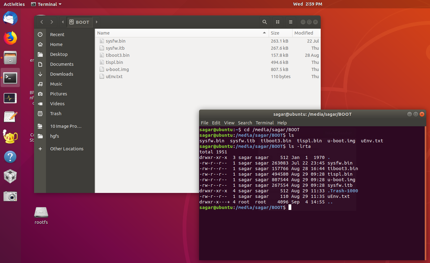

  • Can you do a "ls" in the boot partition ? I want to see the files copied in your boot partition.
    Have you configured the UART for 115200 baud rate, 8 data bits, no parity, 1 stop bit ?
    Based on your USB setup you should see output on USB2
    regards
    Kedar
  • Hello Kedar,
    The image below shows the contents of our boot partition:
    Yes, we configured the UART with these settings (115200-8-N-1).
    Please advise further.
    Thank you.
