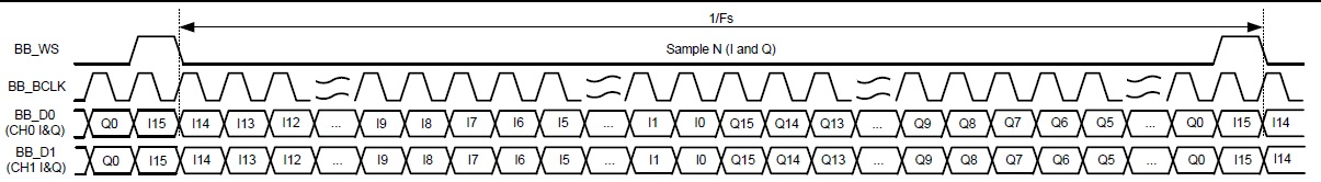

  • Do you have any diagram showing the audio frame sent by the tuner? Of interest are: frame size, slot size, bit clock polarity, frame sync duration and polarity.
    Is I data sent on the first slot and Q data on the second slot?
    Also if possible, please send the output of "omapconf show mcaspN" and "omapconf dump mcaspN" during the test.
    In case you haven't used omapconf before, please download from here.
  • Thank you for the reply Cruz!
    Please find the attached tuner data format diagram.

  • Below configuration doesn't seem right:
    | Receive Format Unit  |                  |
    |   Slot Size          | 32 bits          |
    |   Right-Rotation     | 16 bit positions |
    The slot size should be 16-bits and no rotation should be required.
    Your current McASP settings are valid for a 64-bit frame with 2 x 32-bit slots, but the tuner is configured for a 32-bit frame with 2 x 16-bit slots. This mismatch causes below error:
    |   Status            | Unexpected frame sync       |
    Which means that McASP is getting the frame sync earlier than expected.
  • Thank you Cruz!
    As per your suggestion, from my application I configured 'snd_pcm_hw_params_set_format' as S16_LE instead of S32_LE. so, slot size is configured for 16bit. And I modifed rx_rotate as 0.
    After this I have not observed the 'unexpected frame sync' in omapconf show mcasp2 command. But still I'm not getting the slot 1 data. Please find the register dump as below.

    # ./omapconf dump mcasp2
    OMAPCONF (rev 1.73-nogit built Fri Aug 30 11:12:40 IST 2019)
    HW Platform:
      Generic DRA74X (Flattened Device Tree)
      DRA75X ES1.1 GP Device (STANDARD performance (1.5GHz))
      TPS659038  ES2.0
    SW Build Details:
      Build:
        Version:  _____                    _____           _         _
      Kernel:
        Version: 3.14.63-00015-g7d1141e-dirty
        Author: jasminuser@Elakkiyapriya
        Toolchain: gcc version 4.7.3 20130226 (prerelease) (crosstool-NG linaro-1.13.1-4.7-2013.03-20130313 - Linaro GCC 2013.03)
        Type: #46 SMP PREEMPT
        Date: Wed Sep 4 10:14:03 IST 2019
    | Reg. Name        | Reg. Addr  | Reg. Val.  |
    | MCASP_PID        | 0x48464000 | 0x44307B02 |
    | PWRIDLESYSCONFIG | 0x48464004 | 0x00000001 |
    | MCASP_PFUNC      | 0x48464010 | 0x00000000 |
    | MCASP_PDIR       | 0x48464014 | 0x00000000 |
    | MCASP_PDOUT      | 0x48464018 | 0x00000000 |
    | MCASP_PDIN       | 0x4846401C | 0x48000030 |
    | MCASP_PDCLR      | 0x48464020 | 0x00000000 |
    | MCASP_GBLCTL     | 0x48464044 | 0x0000001F |
    | MCASP_AMUTE      | 0x48464048 | 0x00000000 |
    | MCASP_LBCTL      | 0x4846404C | 0x00000000 |
    | MCASP_TXDITCTL   | 0x48464050 | 0x00000000 |
    | MCASP_GBLCTLR    | 0x48464060 | 0x0000001F |
    | MCASP_RXMASK     | 0x48464064 | 0x0000FFFF |
    | MCASP_RXFMT      | 0x48464068 | 0x00018070 |
    | MCASP_RXFMCTL    | 0x4846406C | 0x00000100 |
    | MCASP_ACLKRCTL   | 0x48464070 | 0x00000000 |
    | MCASP_AHCLKRCTL  | 0x48464074 | 0x00008000 |
    | MCASP_RXTDM      | 0x48464078 | 0x00000003 |
    | MCASP_EVTCTLR    | 0x4846407C | 0x00000001 |
    | MCASP_RXSTAT     | 0x48464080 | 0x00000154 |
    | MCASP_RXTDMSLOT  | 0x48464084 | 0x00000000 |
    | MCASP_RXCLKCHK   | 0x48464088 | 0x14000000 |
    | MCASP_REVTCTL    | 0x4846408C | 0x00000000 |
    | MCASP_GBLCTLX    | 0x484640A0 | 0x0000001F |
    | MCASP_TXMASK     | 0x484640A4 | 0x0000FFFF |
    | MCASP_TXFMT      | 0x484640A8 | 0x00018074 |
    | MCASP_TXFMCTL    | 0x484640AC | 0x00000100 |
    | MCASP_ACLKXCTL   | 0x484640B0 | 0x00180000 |
    | MCASP_AHCLKXCTL  | 0x484640B4 | 0x00188000 |
    | MCASP_TXTDM      | 0x484640B8 | 0x00000003 |
    | MCASP_EVTCTLX    | 0x484640BC | 0x00000000 |
    | MCASP_TXSTAT     | 0x484640C0 | 0x0000010C |
    | MCASP_TXTDMSLOT  | 0x484640C4 | 0x0000017F |
    | MCASP_TXCLKCHK   | 0x484640C8 | 0x00000000 |
    | MCASP_XEVTCTL    | 0x484640CC | 0x00000000 |
    | MCASP_CLKADJEN   | 0x484640D0 | 0x00000000 |
    | MCASP_XRSRCTL0   | 0x48464180 | 0x00000022 |
    | MCASP_XRSRCTL1   | 0x48464184 | 0x00000000 |
    | MCASP_XRSRCTL2   | 0x48464188 | 0x00000000 |
    | MCASP_XRSRCTL3   | 0x4846418C | 0x00000000 |
    | MCASP_XRSRCTL4   | 0x48464190 | 0x00000000 |
    | MCASP_XRSRCTL5   | 0x48464194 | 0x00000000 |
    | MCASP_XRSRCTL6   | 0x48464198 | 0x00000000 |
    | MCASP_XRSRCTL7   | 0x4846419C | 0x00000000 |
    | MCASP_XRSRCTL8   | 0x484641A0 | 0x00000000 |
    | MCASP_XRSRCTL9   | 0x484641A4 | 0x00000000 |
    | MCASP_XRSRCTL10  | 0x484641A8 | 0x00000000 |
    | MCASP_XRSRCTL11  | 0x484641AC | 0x00000000 |
    | MCASP_XRSRCTL12  | 0x484641B0 | 0x00000000 |
    | MCASP_XRSRCTL13  | 0x484641B4 | 0x00000000 |
    | MCASP_XRSRCTL14  | 0x484641B8 | 0x00000000 |
    | MCASP_XRSRCTL15  | 0x484641BC | 0x00000000 |
    | MCASP_WFIFOCTL   | 0x48465000 | 0x00001004 |
    | MCASP_WFIFOSTS   | 0x48465004 | 0x00000000 |
    | MCASP_RFIFOCTL   | 0x48465008 | 0x00012001 |
    | MCASP_RFIFOSTS   | 0x4846500C | 0x00000011 |
    Please help us.
  • Please check if slot-1 data is correct after changing the data delay to 0-bit. Currently, it's set to 1, but that doesn't match tuner's data format.
    |   Data Delay        | 1-bit                       |
  • Rajee,
    Is data on slot 1 correct after setting McASP data delay to 0-bit?
  • I haven't heard back from you, I'm assuming you were able to resolve your issue. If not, please post a reply below (or create a new thread if the thread has locked due to time-out).
