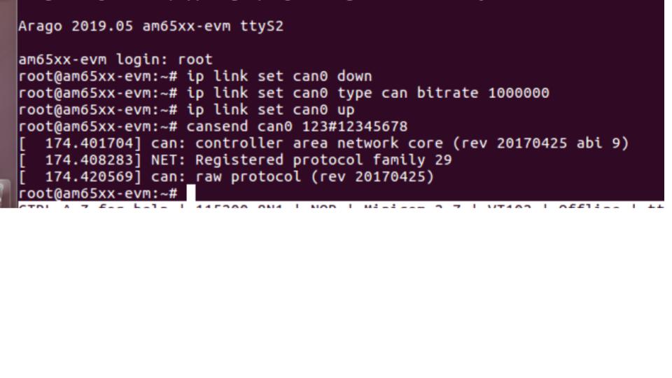

    Yes we have tried the prebuilt images also. can0. We got the following response when we tried to send a message using cansend, we got the following response(Screenshot attached). Does this response confirm that the CAN is working properly? As we are not able to see any response on the other end so we are unable to conclude the same.
    We are getting the same response for the configuration we did.

    Could please post the results of "ip -details link show can0"?

    Please find the command and the response below:
    ip -s -d link show can0
    3: can0: <NOARP,UP,LOWER_UP,ECHO> mtu 16 qdisc fq_codel state UNKNOWN mode DEFAULT group default qlen 10
        link/can  promiscuity 0 minmtu 0 maxmtu 0
        can <LOOPBACK> state ERROR-ACTIVE (berr-counter tx 0 rx 0) restart-ms 0
              bitrate 500000 sample-point 0.875
              tq 12 prop-seg 69 phase-seg1 70 phase-seg2 20 sjw 1
              m_can: tseg1 2..256 tseg2 1..128 sjw 1..128 brp 1..512 brp-inc 1
              m_can: dtseg1 1..32 dtseg2 1..16 dsjw 1..16 dbrp 1..32 dbrp-inc 1
              clock 80000000
              re-started bus-errors arbit-lost error-warn error-pass bus-off
              0          0          0          0          0          0         numtxqueues 1 numrxqueues 1 gso_max_size 65536 gso_max_segs 65535
        RX: bytes  packets  errors  dropped overrun mcast
        601179     104539   0       0       0       0
        TX: bytes  packets  errors  dropped carrier collsns
        105        104539   0       0       0       0
    The output from the show command does not indicate the interface is seeing any errors. Do you have a CAN bus analyzer? What is connected to the other end? Could you attach a picture of how you are connecting the CAN cables?
