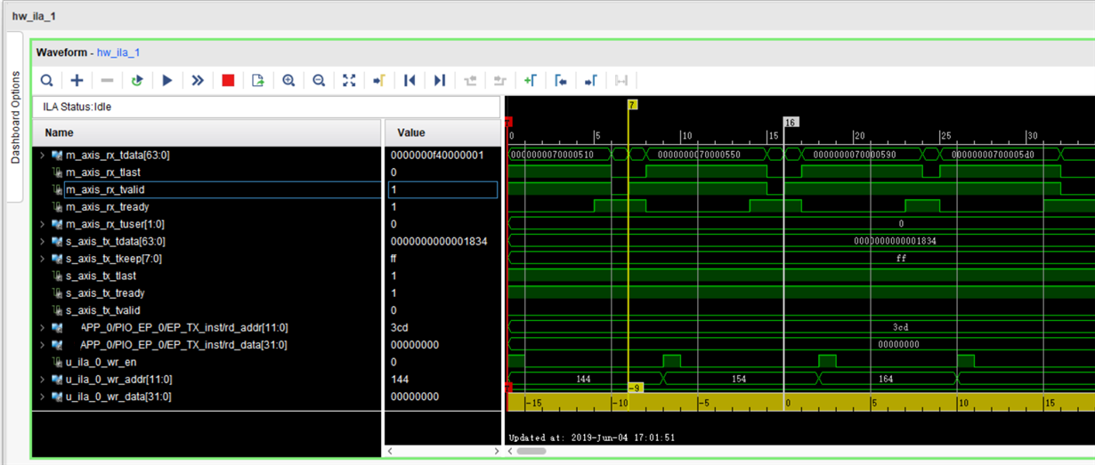

2、 DSP continuity write BAR window:
test like: *(int *)0x21000100=0x1234;
                 *(int *)0x21000104=0x4567;
TLP time :
M_axis_rx_xxx are DSP send TLP signal,S_axis_tx_xxx are FPGA reply TLP signal. From above,2 write TLP use 9  CLK time(9*8ns=72ns);

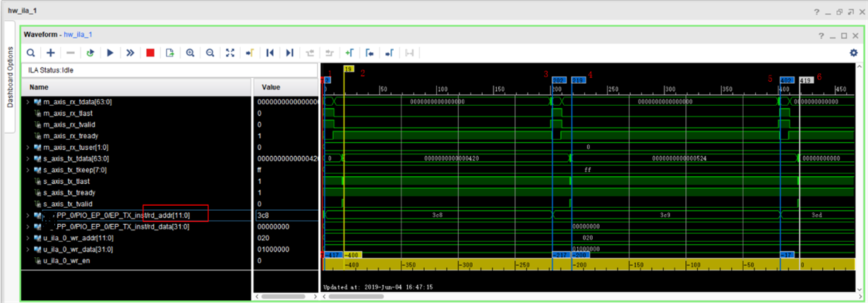

3、DSP continuity read BAR window:
test like : int A=*(int *)0x21000100;
                  int B=*(int *)0x21000104;
TLP time:
M_axis_rx_xxx are DSP send TLP signal,S_axis_tx_xxx are FPGA reply  TLP signal,Red number 1,3,5 are DSP continuity read 3 times BAR window send TLP timestamp,Red number 2,4,6 are FPGA reply DSP TLP timestamp;
From abve,1st DSP read,FPGA reply in  19-2=17 CLK(17*8=136ns),but between 2 DSP reading TLP the time used(Red number 1,3)202-2=200 clk,that's 1.6us

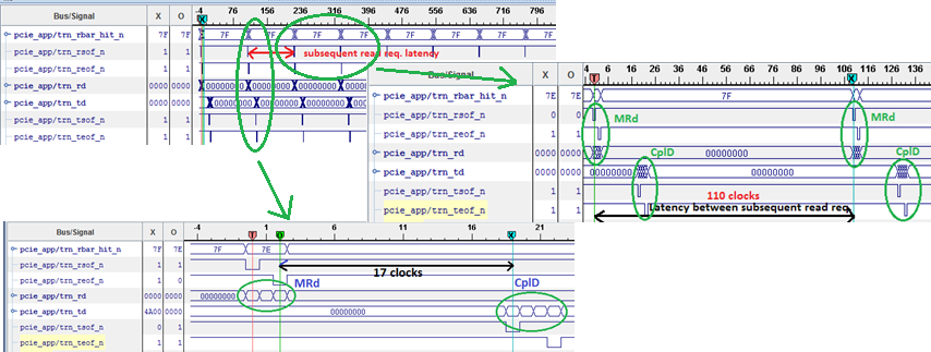

  • Hello!
    For your initial question about latency between subsequent MRd's, I found a picture in my records, showing that there is 110 clocks delay (@62.5MHz) between them, although actual completer is sent by FPGA in 17 clocks plus 3 more for TLP itself. This is on C6670. So similar to you we see actual completer is served pretty quickly, but next read request comes with large delay, see figure:
    I have no idea, why it happens, but similar to your case it takes 1.76us between subsequent read requests. My wild guess is that whole serial machinery has about that much latency, and processor cannot issue another PIO read request white current one was not yet serviced.
    Great to know you're happy with DMA of FPGA side. In our case our handmade machine was too far from perfect, so we finally rewrote it to be slave responder, capable to handle multidword TLPs, and run DMA by EDMA3 on DSP side. We lost some performance, but gained multichannel, multiple controller, and quick programming at DSP side.
    Back to your issue, if you are comfortable with FPGA operation, you may try to let FPGA write pointers addresses directly to DSP's dedicated memory locations and signal MSI afterwards, so DSP would look in its own memory and make no read requests to FPGA. On the other hand, FPGA will make posted writes, which should be simple to make and efficient to transfer.
    Hope this helps.

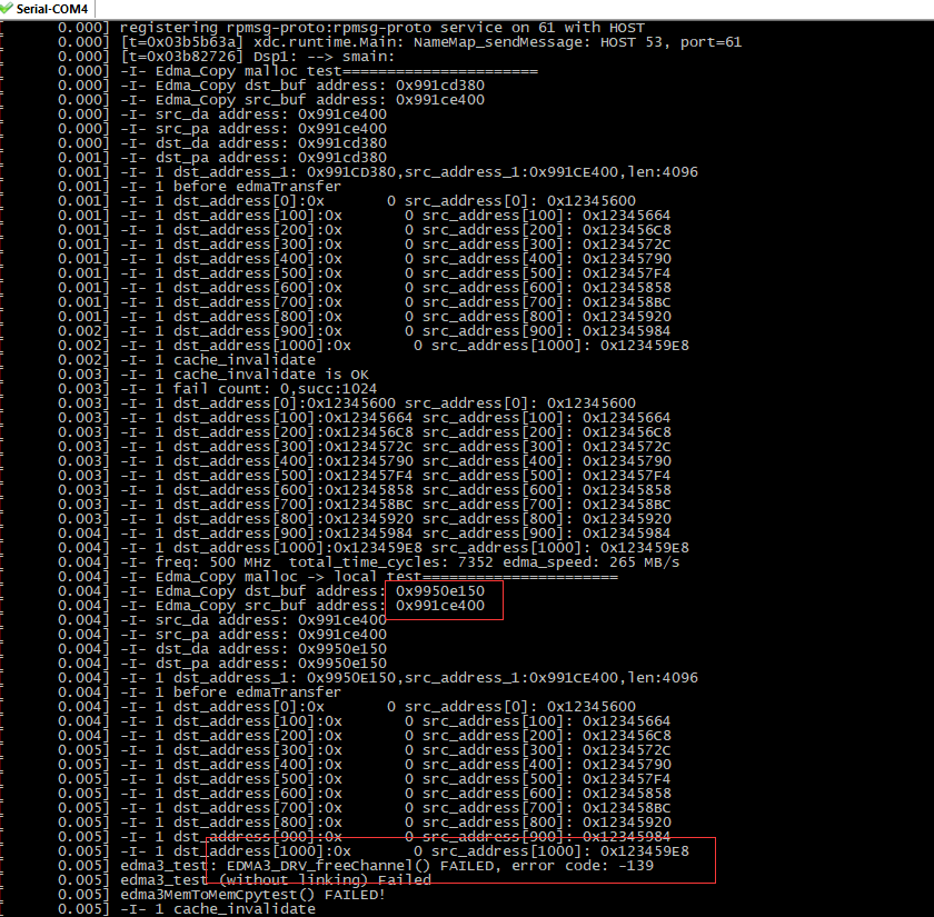

    I had tested eDMA moving datas from RAM to RAM. But it does work property when srcAddr or dstAddr not aligned 128bytes.Is that my using wrong?

    Second, to my knowledge (E/Q)DMA is not strict in alignment, PCIE spec allows non-aligned load through Byte Enable field, but I am not sure whether non-aligned access is permitted by PCIESS of DSP.
    When using DMA, if the source addressing mode and destination addressing mode is incremental, there is no alignment restriction. If they are constant addressing mode, you must program the address to be aligned to a 256-bit aligned address.
    For the DSP and PCIESS side, non-aligned access is allowed.
    Regards, Eric

    I try it ,when not aligned address used it can't run.
    EDMATestCode.zip
    I looked at your source code, you did local DDR to DDR memory copy with aligned/non-aligned address. Probably you will extend this between DDR and PCIE memory space. I knew in many of our drivers, like URAT, MMCSD we used EDMA to move data, and the address is not aligned and still worked. The edma3_test() should set the OPT parameter in source and destination address in incremental mode, so the code looks right.
    I need some time to create a CCS project and test your code, and I will travel next week so expect delay for this. Given you found that unaligned access is not working, are you able to make the source and destination on AM572x EDMA aligned? Or you can move a few or dozens additional data with aligned address, but just discard the un-used. Will you see using EDMA is more efficient to exchange small/un-aligned data with FPGA vs use CPU read reading a few bytes?

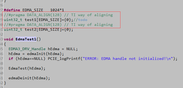

    The alignment code is:
    #ifdef EDMA
    /* This is the data that will be used as a temporary space holder
    * for the data being transfered using DMA.
    * This is done since EDMA cannot send a specific value or token
    * but instead it can send blocks of data.
    #ifdef _TMS320C6X
    #pragma DATA_SECTION(dataContainer, ".testData")
    #pragma DATA_ALIGN(dataContainer, PCIE_EXAMPLE_LINE_SIZE)
    #endif
    UInt32 dataContainer[PCIE_EXAMPLE_LINE_SIZE]
    #ifdef __ARM_ARCH_7A__
    __attribute__((aligned(256))) // GCC way of aligning
    #endif
    ; // for dstBuf
    #endif
    Considering possible cache operation, typically we used at least cache line size alignment (you may check if it is 64 or 128 bytes). So using 4/8/16/... for address alignment is not a good choice.
    Regards, Eric
    You can see  edma3_test() the same as < pdk_am57xx_1_0_xx\packages\ti\drv\pcie\example\sample\src\pcie_sample.c> in funcion PcieExampleEdmaEP() or PcieExampleEdmaRC().
