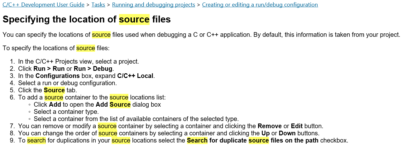

  • Hello Rahul,
    it looks like it would work at least with the libraries. E.g. an attempt is made to jump into the function "SPI_transfer (spi, & spiTransaction)".
    Unfortunately I get the output: "Can not find a source file at" src / SPI_drv.c "
    I thought the resource path was known by CCS (C: \ ti \ pdk_am335x_1_0_13 \ packages \ ti \ drv \ spi).
    Do I have to re-announce all paths to the CCS Is there an elegant way to define these paths (in a kind of cfg-file)?
    best regards
    Thomas
  • Thomas,
    You just need to point to one source file and the CCS Editor will then locate all paths relative to that file. For the SPI_drv.c, just browse to the folder
    pdk_am335x_1_0_xx\packages\ti\drv\spi\src\SPI_drv.c
    Once you do that it should be able to locate all the files in PDK. You may need to do that also if you want to debug inside the BIOS kernel. This is required because when the project is built in CCS it knows the location of the source of the application files but since the linked libraries are not built in CCS, it is not aware of the paths.
    Hope this clarifies the CCS setup for debugging driver library code.
    Rahul

    Question: can I use the the CCS information "Build Configuration" to switch between debug and release version (can the app.cfg file access this information in a way)?
    2) as you metioned before
    CCS remembers this decision somewhere - where is this information (path) stored? Can I set this manually in advance in CCS?
