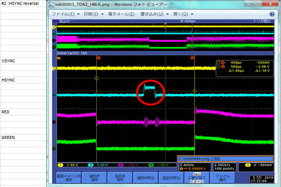

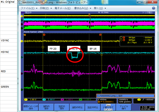

Hi Expert,
I am using Processor SDK Vision 3.7 (PSDKV 3.7) and trying to connect HDMI output to DLP5531 (DLPC230 used) with some modification in PSDKV 3.7.
Resolution changing to 1152x576 was successful, since I conformed that 1152x576 output image was seen on HDMI monitor without any errors.
However, sync error in DLP is now being faced when connecting TDA2 to DLP5531.
As a result of deep investigation, it seems that HSYNC on TDA2 HDMI output needs resersal of polarity.
Please see below analog waveform for HDMI output.
#1: HSYNC original :
#2: HSYNC reversal:
Could you please tell me which source code in PSDKV 3.7 should be modified for HSYNC reversal (#2) ?
