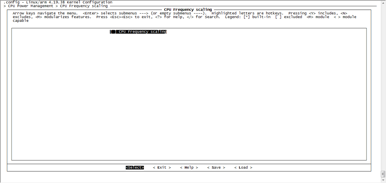

AM3354 MAX cpu frequency:800MHZ
The customer used latest RT-linux SDK, and he used default kernel configuration. What's the default cpufreq. Where is the configuration code?
The option cpu frequency scaling haven't been selected in default menuconfig.

    CPUFreq is enabled by default in PSDK Linux, and NOT enabled by default in PSDK Linux-RT. You can compare below files:
    ti-processor-sdk-linux-am335x-evm-06.00.00.07/board-support/linux-4.19.38/arch/arm/configs/tisdk_am335x-evm_defconfig
    ti-processor-sdk-linux-rt-am335x-evm-06.00.00.07/board-support/linux-rt-4.19.38/arch/arm/configs/tisdk_am335x-evm-rt_defconfig
    To enable CPUFreq in linux-rt, follow the below user guide steps:
    Dynamic Voltage and Frequency Scaling(MPU aka CPUFREQ)
    Kernel Configuration Options

    Thank you! So we have to enable CPUFreq firstly? I am wondering what's the default cpufreq if not enable?
    If you need to use DVFS dynamic power management technique in userspace, then you have to enable cpufreq in kernel.
    The Cortex-A8 CPU frequency is setup in u-boot code base. It is set to the MAX frequency it can support. Refer to the below u-boot files:
    u-boot-2019.01/arch/arm/mach-omap2/am33xx/clock.c  : setup_dplls() ->  do_setup_dpll(&dpll_mpu_regs, params);
    u-boot-2019.01/board/ti/am335x/board.c : get_dpll_mpu_params()
