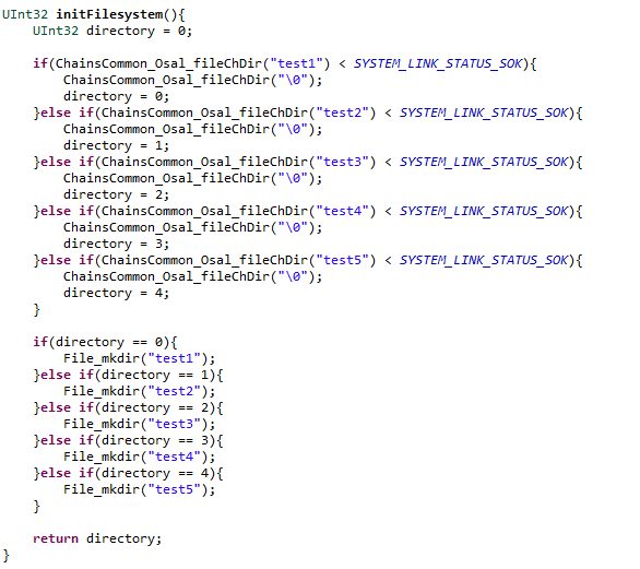

  • Sorry forgot to insert my code.
    Here it is:
    (only the part where I check for existing directories and create new ones)

  • Hi Nicolas,
    I had a look at your code and I am a little bit concerned about if it will work as expected. Here is what I think will happen:
     - on first call we try to enter "test1", it fails so we proceed and create it.
     - on second call first we try to enter "test1" - it is successful, so we go on to the following "eles if" where we try to enter "test2", but note that we are already in "test1" directory so actually try to enter "/test1/test2" - it fails so we go to the root dir and create "test2"
     (now we have "test1" and "test2" in the root dir as we wanted)
     - on third and consecutive calls the flow will be the same as second - we enter "test1" successfully, try to enter "test2" from within it, fail, go to the root and try to create "test2" which already exists.
    Can you check if my findings are correct or I miss something.
    Note that calling mkdir with existing directory ideally should just return some error and not cause the problems with the other files, but let's first try to check if the function logic works as expected.
    Yordan
  • Hi Nicolas,
    Please ignore my previous post - I had a look at ChainsCommon_Osal_fileChDir() implementation and it seems to add "/" to the dirname so it always try to enter a subdirectory of the root dir, and your function should work as expected.
    I will ping VisionSDK experts to look at this, they will respond here soon.
    Yordan

    Your code seems ok.
    What is the issue are you facing with this.
    Till test 5 it will be able to create and should work fine.
    Anuj

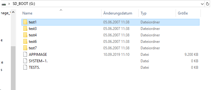

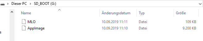

  • Hi Anuj,
    there is a issue if we boot from SD card and run some tests.
    The MLO (opp_plus) and Appimage files are destroyed after this.
    If we run the software with debugger and in debug mode there is everything ok.
    See pictures:
    Before:
    After:
    Alex
    In your code you are creating directories only till test5 folder.
    Then how test7 folder is getting created in your sd card.
    Please add '\' with the folder name with File_mkdir().
    Can you try to create folder 1 by 1 and check after which folder this issue is observed.
    Try this multiple time and check whether its always at same time or its occurring randomly.
    Anuj
  • Hi Anuj,
    I modified the code a bit to get more then 5 test folders.
    Adding for example "\test1" in combination with File_mkdir() didn't create a folder.
    If I run one test turn of the hardware and check the sd card there is everything ok.
    But if I run more then one test in a row the folder creation fails and destroy the other files.
    Alex
