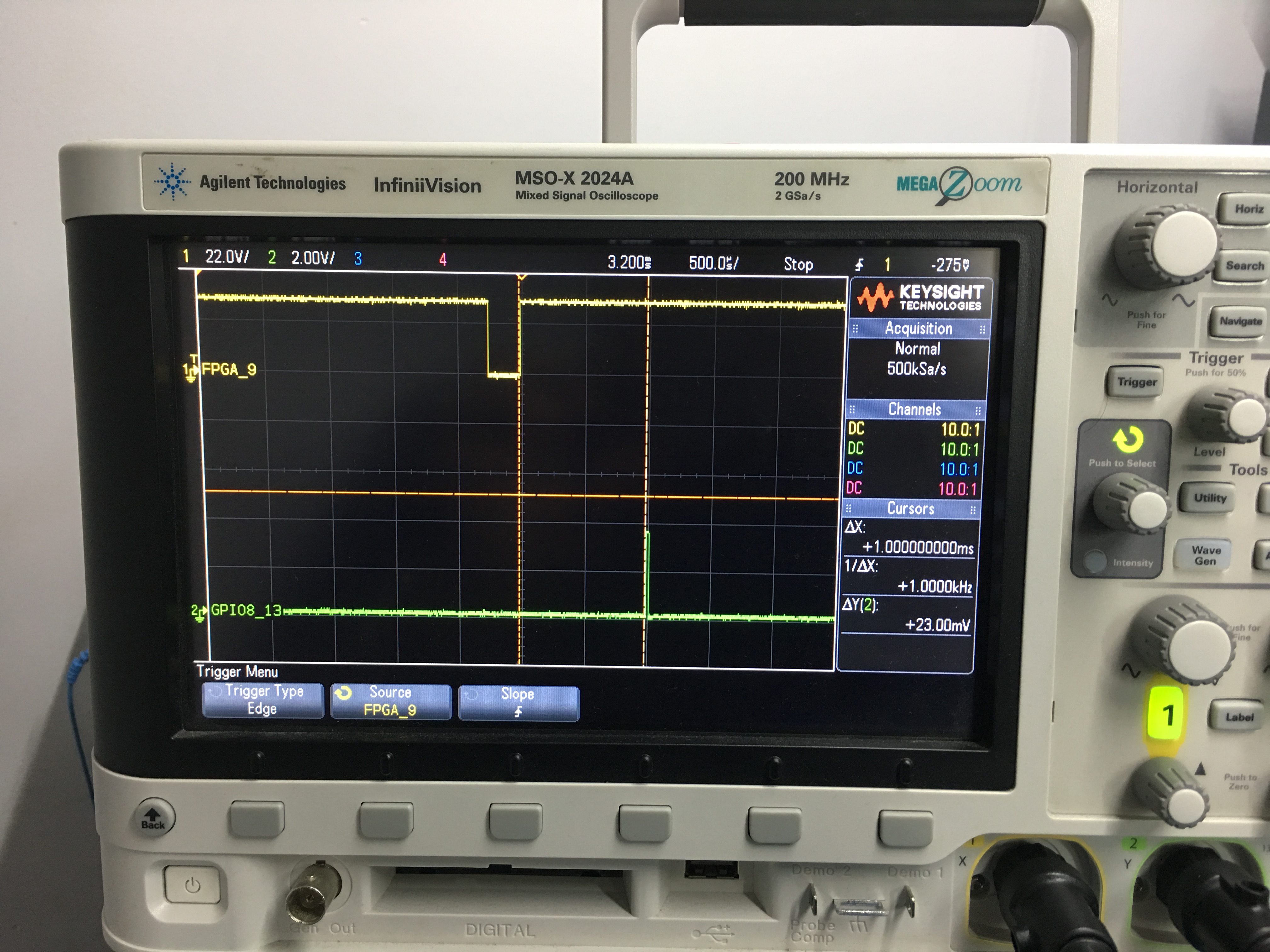

Can someone tell the place for finding event ids and interrupt numbers for creating HWI for GPIO 8-22.

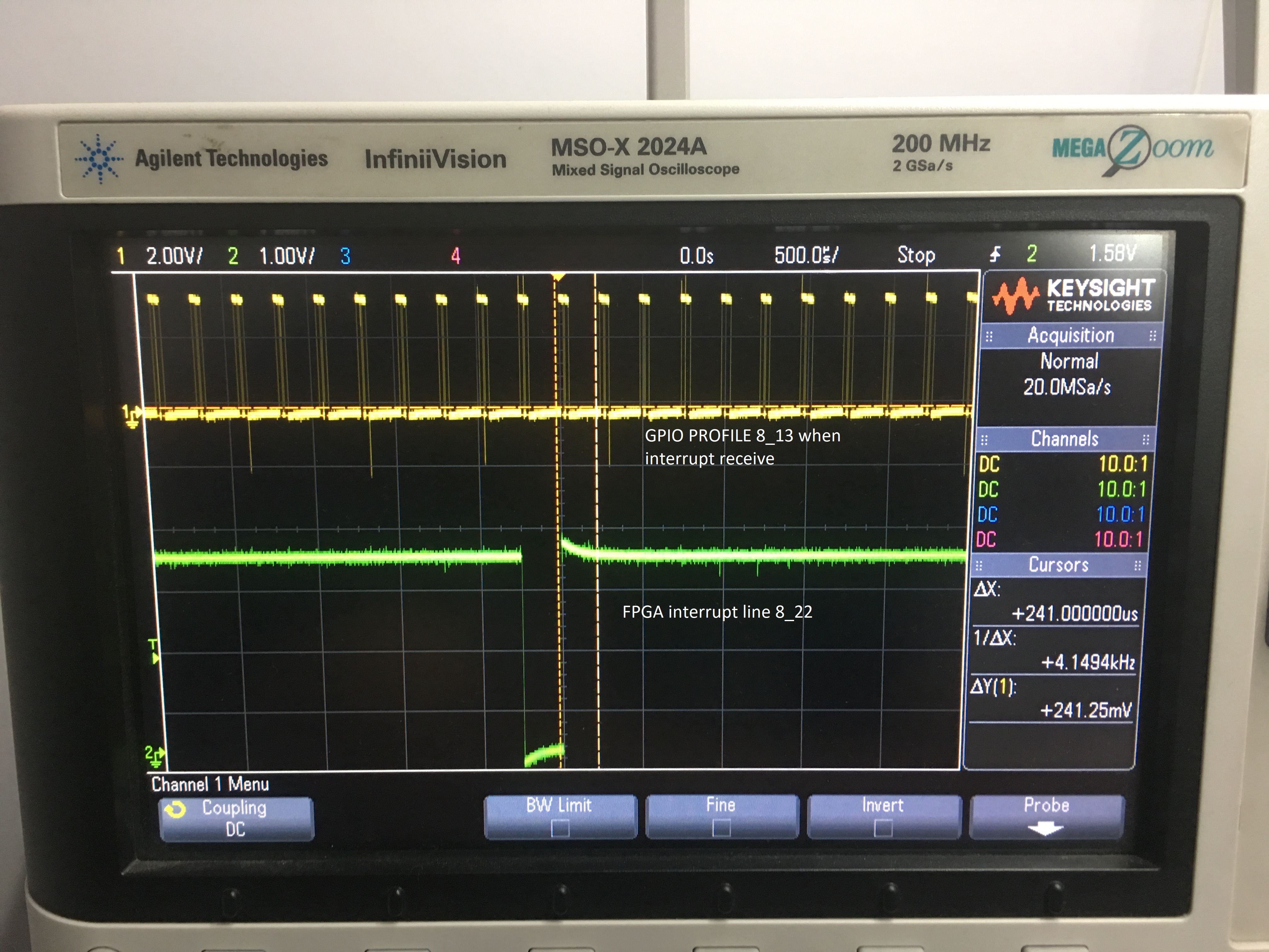

  • Hi ,
    please can you verify the following code for GPIO8-22 Hwi creation ?
    // GPIO 8-22
    #define GPIO_PORT_NUM 0x8
    #define GPIO_PIN_NUM 0x16
    GPIO_PinConfig gpioPinConfigs[] = {
    GPIO_DEVICE_CONFIG(GPIO_FPGA_INTR_PORT_NUM, GPIO_FPGA_INTR_PIN_NUM) |
    GPIO_CFG_INPUT | GPIO_CFG_IN_INT_RISING
    // Pinmux
    regVal = 0x5000E;
    ((CSL_padRegsOvly) CSL_MPU_CORE_PAD_IO_REGISTERS_REGS)->PAD_VOUT1_D22 = regVal; //gpio 8_22
    void intr_init() {
    /* TRM : Table 17-3 DSP1_INTC Default Interrupt Mapping
    * Default interrupt Mapping for GPIO8 is not there
    * trying with cross-bar reserved is possible ?
    Hwi_Handle gpio_int_h;
    Hwi_Params hwiInputParams;
    CSL_xbarIrqConfigure(CSL_XBAR_IRQ_CPU_ID_DSP1, CSL_XBAR_INST_DSP1_IRQ_62, CSL_XBAR_GPIO8_IRQ_1); // Correct ?
    Hwi_Params_init(&hwiInputParams);
    hwiInputParams.name = "GPIO_8_22";
    hwiInputParams.arg = 0;
    hwiInputParams.priority = 0;
    hwiInputParams.evtId = 116; // correct ?
    gpio_int_h = Hwi_create(11, (Hwi_Fxn)slot_intr_Handler, &hwiInputParams);
    if (gpio_int_h == NULL)
    Log_print0(Diags_USER1,"Error :- GPIO 8_22 Hwi not created ");
    ASSERTION((0), "Error:- GPIO8_22 Hwi not created");
    Dhruv

    based on example, If I used GPIO2-19, I am able to get the interrupt in DSP1 but same interrupt is used in ARM linux  (MPU) for other purpose. we can't use GPIO2 bank.
    here we tried with gpio 2-19,
    // GPIO 2-19
    #define GPIO_PORT_NUM 0x2
    #define GPIO_PIN_NUM 0x13
    GPIO_DEVICE_CONFIG(GPIO_PORT_NUM , GPIO_PIN_NUM ) |
    // Pinmux
    regVal = 0x5000E;
    ((CSL_padRegsOvly) CSL_MPU_CORE_PAD_IO_REGISTERS_REGS)->PAD_GPMC_CS0 = regVal;//gpio2_19
    void intr_init() {
    CSL_xbarIrqConfigure(CSL_XBAR_IRQ_CPU_ID_DSP1, CSL_XBAR_INST_DSP1_IRQ_56, CSL_XBAR_GPIO2_IRQ_1); // Correct ?
    hwiInputParams.name = "GPIO_2_19";
    hwiInputParams.evtId = 56; // correct ?
    Log_print0(Diags_USER1,"Error :- GPIO 2_19 Hwi not created ");
    ASSERTION((0), "Error:- GPIO2_19 Hwi not created");

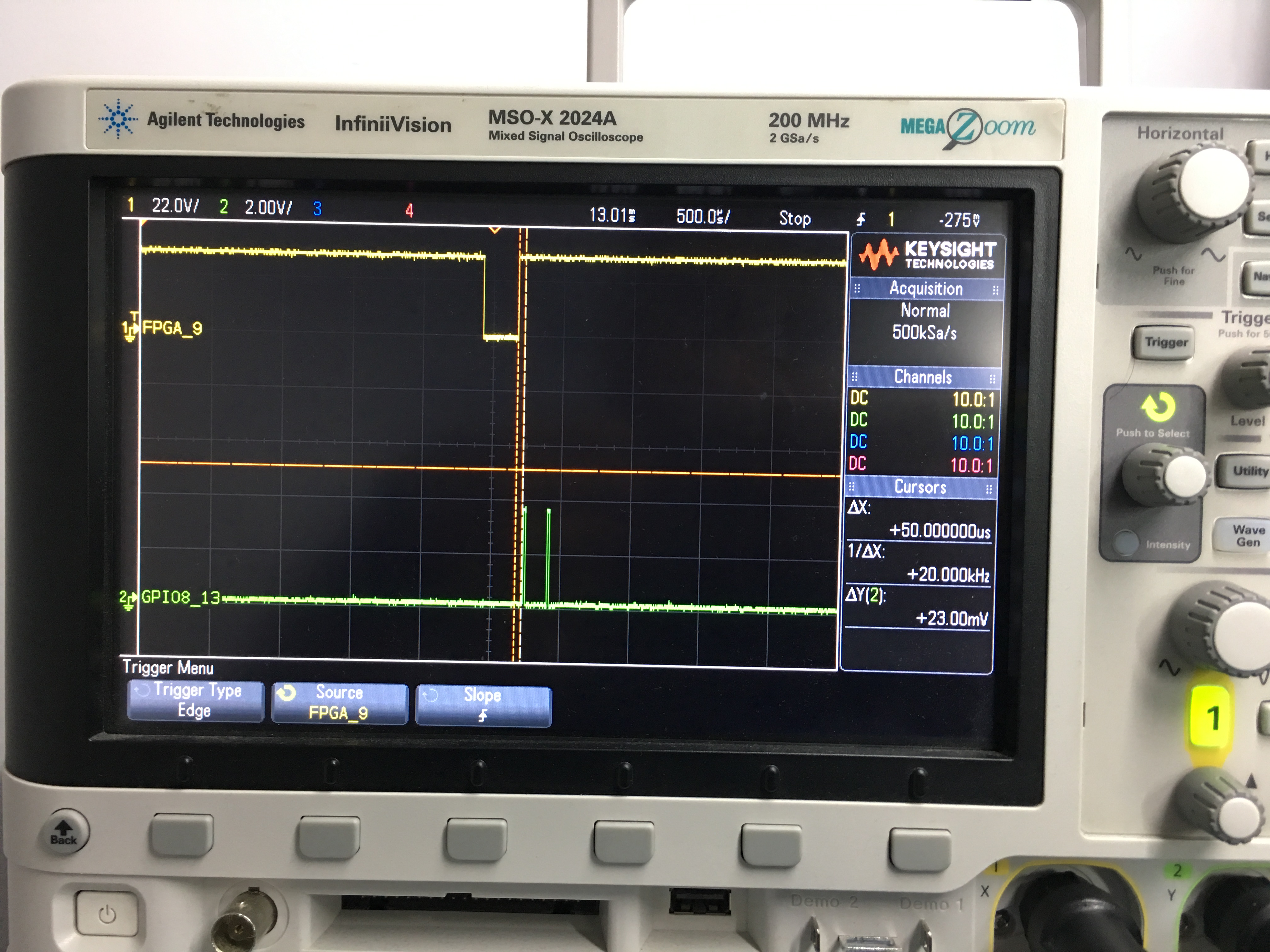

    but when we tried with GPIO 8-22 , interrupt handler is not called. it's look-like cross-bar irq configuration is not working properly. can you help me on that ?
    // Table 17-3. DSP1_INTC Default Interrupt Mapping
    // CSL_XBAR_INST_DSP1_IRQ_62 : Reserved by default but can be remapped to a valid interrupt source
    Dhruv
  • Dhruv,
    What is the value of CTRL_CORE_DSP1_IRQ_62_63[8:0] DSP1_IRQ_62? You need to have 116 (0x74) there.
    Pavel
  • Hi Pavel,
    // CSL_XBAR_GPIO8_IRQ_1 = 116;
    #define CSL_XBAR_INST_DSP1_IRQ_62           (31U)
    DSP1 we can use crossbar value from 1-64 only. TRM : Table 17-3. DSP1_INTC Default Interrupt Mapping, find the attachment.
    CSL_XBAR_INST_DSP1_IRQ_62 is reserved. we want to map GPIO8_IRQ_1 to DSP1_IRQ_62. is it possible?
    Yes, you can.
    [8:0] DSP1_IRQ_62 default values is 31 (0x1F), which is reserved. And you can write any value from 1 to 511 (0x1FF) in this register. To map GPIO8_IRQ_1, you need to write 116 (0x74) value in this register.
    Pavel

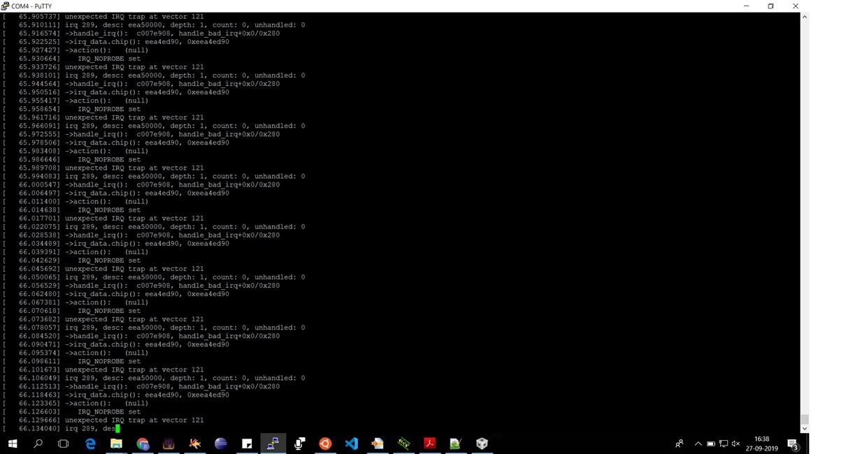

  • Hi Pavel,
    we tried with that but with that in DSP1 we are not able to received any interrupt. any other modification is required ?
    because in TRM GPIO8 interrupt not mention in DSP1 core. any extra things we have to take care ?
     ARM side GPIO bank 8 is  present. it will  not impact any thing correct?

    if we use GPIO8 interrupt 1 than ARM linux following error occurring after receiving 1st interrupt in DSP core.
    ************************************************ configure gpio 8_22 hwi interrupt  GPIO8_IRQ_1 DSP **********************************
    uint32_t gpio_base_address = SOC_GPIO8_BASE; //0x48053000U
    uint32_t gpio_pin = 0x16; //22
    GPIO_init();
    GPIOModuleReset(gpio_base_address);
    GPIOModuleEnable(gpio_base_address);
    GPIOIntTypeSet(gpio_base_address, gpio_pin, GPIO_INT_TYPE_RISE_EDGE);
    GPIODirModeSet(gpio_base_address, gpio_pin, GPIO_DIR_INPUT);
    GPIOPinIntDisable(gpio_base_address, GPIO_INT_LINE_1, gpio_pin);
    GPIOPinIntClear(gpio_base_address, GPIO_INT_LINE_1, gpio_pin);
    GPIOTriggerPinInt(gpio_base_address, GPIO_INT_LINE_1, gpio_pin);
    GPIOPinIntEnable(gpio_base_address, GPIO_INT_LINE_1, gpio_pin);
    GPIOPinIntWakeUpEnable(gpio_base_address,GPIO_INT_LINE_1,gpio_pin);
    hwiInputParams.evtId = 62
    ************************************* ARM Linux Error ****************************************************************
    root@am57xx-phycore-rdk:~# [ 102.046857] irq 289, desc: eea50000, depth: 1, count: 0, unhandled: 0
    [ 102.053334] ->handle_irq(): c007e908, handle_bad_irq+0x0/0x280
    [ 102.059296] ->irq_data.chip(): eea4ed90, 0xeea4ed90
    [ 102.064203] ->action(): (null)
    [ 102.067442] IRQ_NOPROBE set
    [ 102.070506] unexpected IRQ trap at vector 121
    if we use GPIO8 interrupt q than ARM linux error not happen with GPIOPinIntDisable(gpio_base_address, GPIO_INT_LINE_1, gpio_pin);. but we are receiving so unwanted interrupt in DSP core every 300 micro-seconds. we can use only gpio 8 interrupt 2, correct? because gpio 8 interrupt 1 is mapped to MPU (ARM linux)

    Now gpio interrupt configuration is only enable for gpio 8_22, why we receiving so  many interrupts, basically we should receive interrupt every 9th milliseconds only.
    please look at the logs,
    Please find the attached image. Green probe : FPGA 8-22 interrupt , yellow probe: GPIO_PROFILE 8_13 when we received interrupt.
    Dhruv

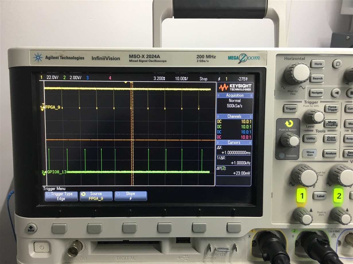

  • Hi Pavel,
    Now we are not getting so many interrupts, but we are getting sometime 2 interrupt call within 9th millisecond, and also gpio interrupt latency sometime is more than 1 millisecond.
    here is our change,
    ************************************************ configure gpio 8_22 hwi interrupt  GPIO8_IRQ_2 DSP **********************************
    CSL_xbarIrqConfigure(CSL_XBAR_IRQ_CPU_ID_DSP1, CSL_XBAR_INST_DSP1_IRQ_62, CSL_XBAR_GPIO8_IRQ_2);
    GPIO_init();
    GPIOPinIntDisable(gpio_base_address, GPIO_INT_LINE_2, gpio_pin);
    GPIOPinIntClear(gpio_base_address, GPIO_INT_LINE_2, gpio_pin);
    GPIOPinIntEnable(gpio_base_address, GPIO_INT_LINE_2, gpio_pin);
    void slot_intr_Handler (UINT32 * arg)
    static int count = 0,i=0;
    //GPIO_PROFILING : gpio 8_13
    GPIO_write(GPIO_PROFILING, GPIO_PIN_VAL_HIGH);
    for(i=0;i<1000;i++);
    GPIO_write(GPIO_PROFILING, GPIO_PIN_VAL_LOW);
    Log_print1(Diags_USER1, "***** fpga_gpio_interrupt_Handler count = %d ***** ",count++);

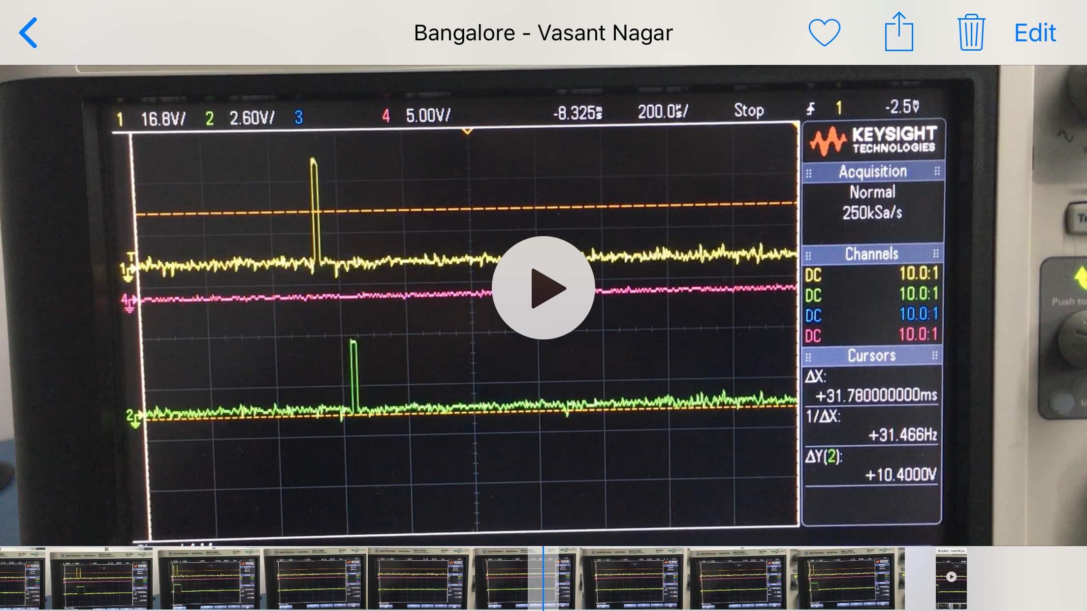

    1. Why our interrupt handler called by 2 times?
    2. why  so much latency we observed some time?
    Dhruv
    1.
    2. GPIO interrupt latency some time more than 1 millisecond.
    3. GPIO interrupt handler called 2 times.

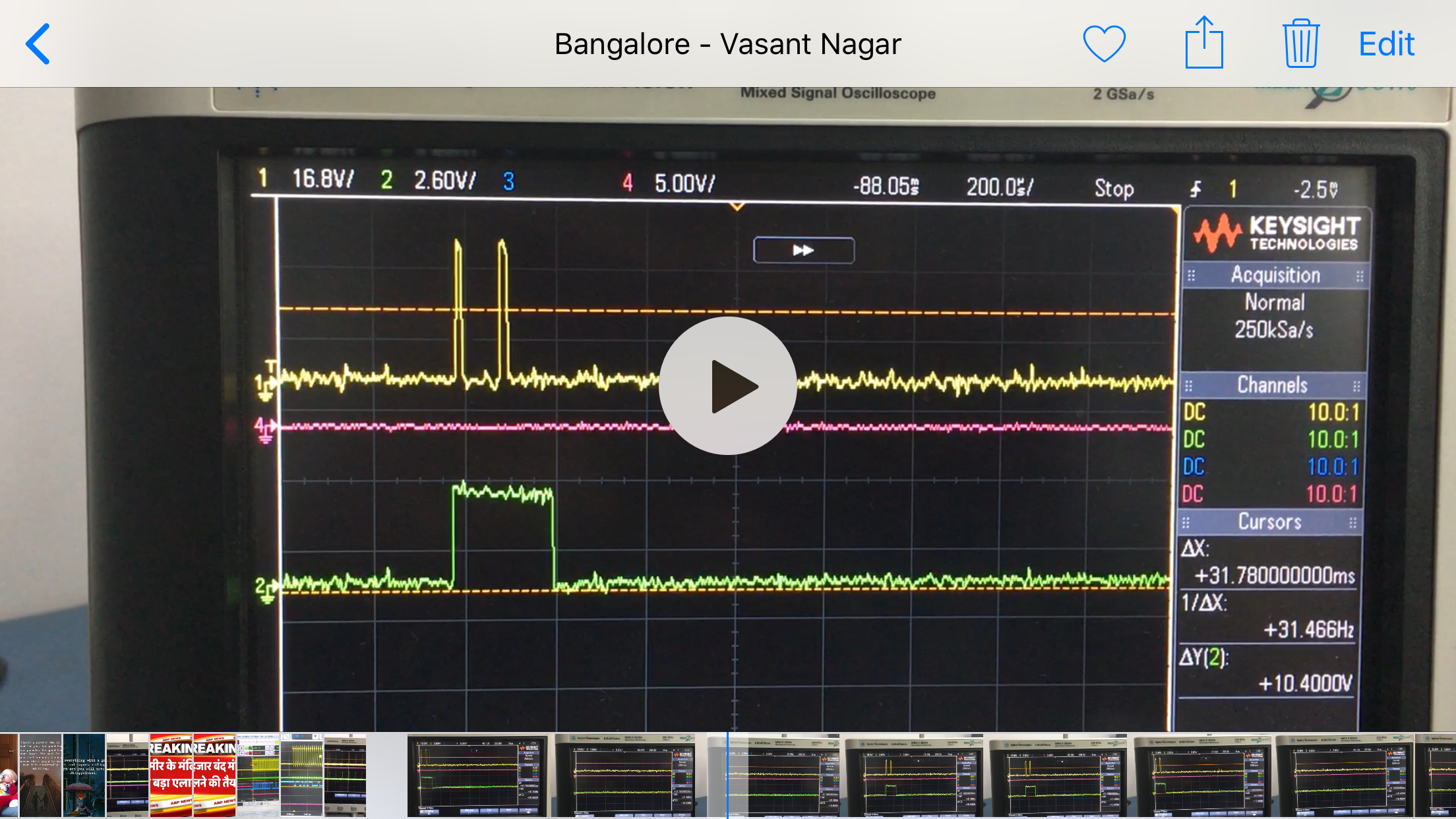

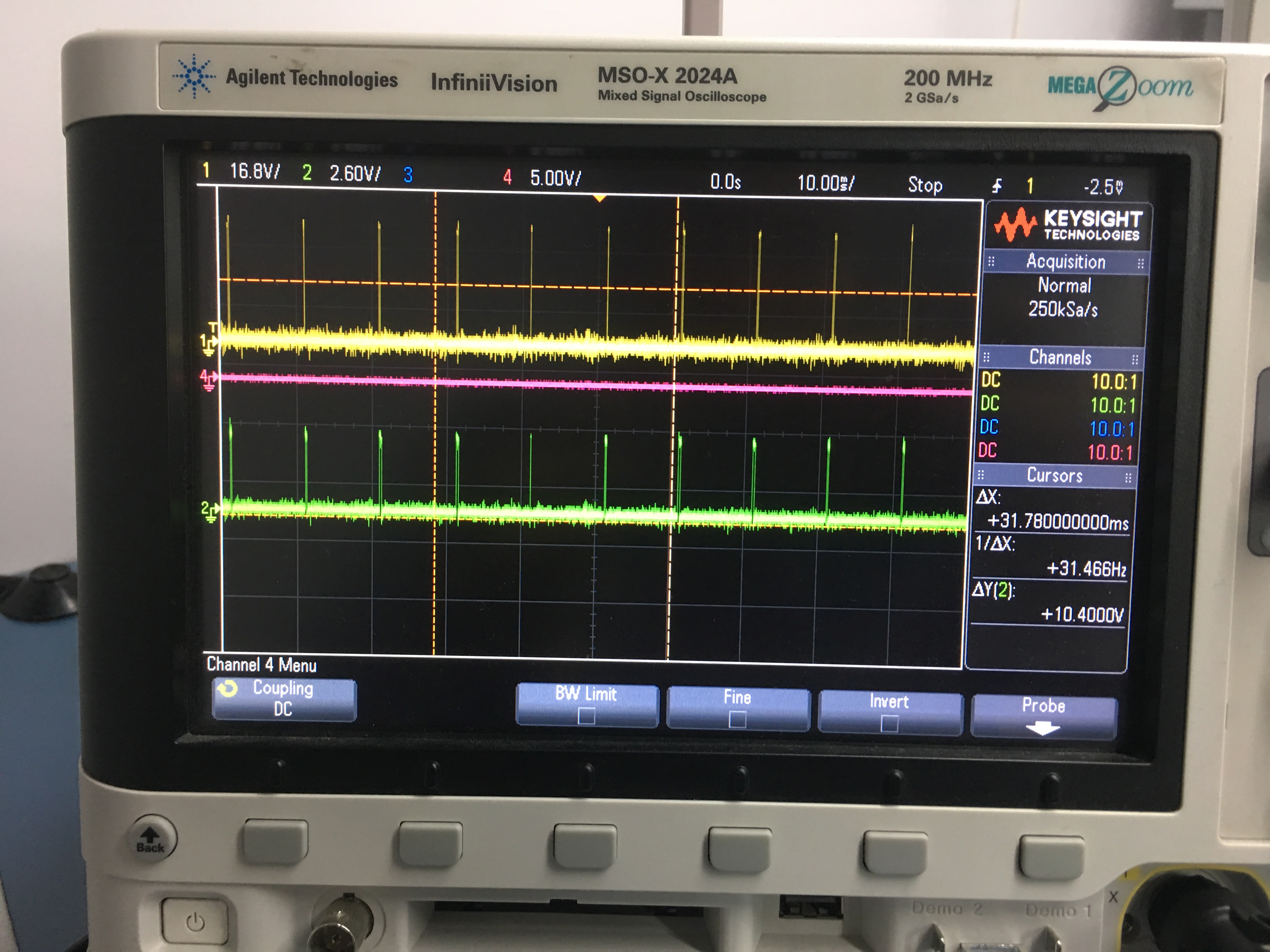

  • Hi Pavel,
    we got some more observation, actually we have registered 2 Hwi, one for PCI interface and one for GPIO 8-22, PCI interrupt handler was already present in project code base, but PIC Hwi has different EventId and Interrupt number,
    ***************************************** PCIE Hwi Configuration  *****************************************
    HwiP_Params hwiInputParams;
    uint32_t cpuEvent = 48;
    uint32_t xbarIndex = cpuEvent - 31;
    uint32_t vector = 12;
    CSL_xbarIrqConfigure (CSL_XBAR_IRQ_CPU_ID_DSP1, xbarIndex, CSL_XBAR_PCIe_SS1_IRQ_INT1);
    HwiP_Params_init (&hwiInputParams);
    hwiInputParams.name = "PCIEEP_MSI_AND_INTX";
    hwiInputParams.arg = (uintptr_t)ephandle;
    hwiInputParams.evtId = cpuEvent;
    ephandle->pcieHwi = HwiP_create(vector, PCIE_EP_Isr, &hwiInputParams);
    if (! ephandle->pcieHwi)
    PCIE_logPrintf("Hwi create failed\n");
    Its possible that both interrupt came as same time, how we can handle that ? we are not sure but it's look like when both interrupt came as same time we are getting 2 time interrupt handler called.
    Dhruv
    yello probe : GPIO8_22 interrupt handler gpio probe
    green probe : PCIE interrupt handler gpio probe
    1. Interrupt handler called once.
    2. interrupt handler called 2 times.
    3.
    waiting for your response.
    Dhruv

  • Hi Pavel,
    we are using pdk_am57xx_1_0_7.
    Do you have gpio8_22 irq towards DSP1 core working now?
    It's not working properly, gpio 8_22 ISR called 2 times, for receiving single interrupt from FPGA.
    your gpio8_22 interrupt handler (ISR) is called by both gpio8_22 irq event and PCIe event? And you need this handler to be called only by gpio8_22 irq event?
    Yes, PCI interrupt handler has different ISR function, gpio8_22 interrupt handler also have different event-id and interrupt number,
    GPIO8_22 interrupt handler, it shoyld call only one time, why it's called  2 times?

    gpio 8_22 ISR called 2 times, 2 times from GPIO8 module?
    Yes, It's look like from GPIO8 module only, we are doing configuration with CSL_xbarIrqConfigure(); only, we are not configuring statically with cfg script.
    Dhruv,
    Can you attach your main C file?
    When you receive the first interrupt, do you clear it in GPIO_IRQSTATUS register? Is it possible to receive second signal on that gpio line, which is triggering the second interrupt?
    Can you also put breakpoint at the beginning of your GPIO ISR and dump the GPIO registers?
    Pavel
  • Hi Pavel,
    We don't have stand-alone project for test. We tried to disable PCIE Driver , after disabling the driver we are not receiving 2 times interrupt. ISR handler also called 1 time. but ISR latency is too much, after disable PCIE driver, around max = 5.33 ms min = 400 us. we didn't have any clue why PCIE driver have conflict with GPIO8_22 ISR.
    we have result with disabling PCIE driver,
    /********************************************************************* Logs Start *********************************************************************************************/
    [ 53.811] [t=0x00000007:37832411] xdc.runtime.Main: ******************** Before clear ISR STATUS ***********************
    [ 53.811] [t=0x00000007:3784956f] xdc.runtime.Main: GPIO_IRQSTATUS_0 = 0x0
    [ 53.811] [t=0x00000007:378582b2] xdc.runtime.Main: GPIO_IRQSTATUS_1 = 0x400000
    [ 53.811] [t=0x00000007:378679f7] xdc.runtime.Main: ******************** After clear ISR STATUS ***********************
    [ 53.811] [t=0x00000007:3787ced6] xdc.runtime.Main: GPIO_IRQSTATUS_0 = 0x0
    [ 53.811] [t=0x00000007:3788bc2a] xdc.runtime.Main: GPIO_IRQSTATUS_1 = 0x0
    [ 53.811] [t=0x00000007:3789a6f7] xdc.runtime.Main: ******************** END ***********************
    [ 53.812] [t=0x00000007:378b2a93] xdc.runtime.Main: ***** fpga_gpio_interrupt_Handler TIME = 9560 micro sec arg = 50 *****
    [ 53.812] [t=0x00000007:378c9488] xdc.runtime.Main: ******************** Before clear ISR STATUS ***********************
    [ 53.812] [t=0x00000007:378dece5] xdc.runtime.Main: GPIO_IRQSTATUS_0 = 0x0
    [ 53.812] [t=0x00000007:378ed9ee] xdc.runtime.Main: GPIO_IRQSTATUS_1 = 0x0
    [ 53.812] [t=0x00000007:378fc4d3] xdc.runtime.Main: ******************** After clear ISR STATUS ***********************
    [ 53.812] [t=0x00000007:379117b0] xdc.runtime.Main: GPIO_IRQSTATUS_0 = 0x0
    [ 53.812] [t=0x00000007:379204e4] xdc.runtime.Main: GPIO_IRQSTATUS_1 = 0x0
    [ 53.812] [t=0x00000007:3792efab] xdc.runtime.Main: ******************** END ***********************
    [ 53.813] [t=0x00000007:379471d3] xdc.runtime.Main: ***** fpga_gpio_interrupt_Handler TIME = 1018 micro sec arg = 50 *****
    /********************************************************************* Logs End *********************************************************************************************/
    It's look-like when 2 time ISR handler called GPIO_IRQSTATUS_1 is already cleared.
    Dhruv
  • Dhruv,
    I can provide you below suggestions:
    1. Make sure you are not using gpio8_22 on Linux side also. Check below e2e threads for details:
    2. By default PCIe interrupts are mapped to DSP1_IRQ_48/38/39 in below files:
    pdk_am57xx_1_0_15/packages/ti/csl/example/pcie/write_loopback/rc/rc_write_loopback_app_main.c
    pdk_am57xx_1_0_15/packages/ti/csl/example/pcie/write_loopback/ep/ep_write_loopback_app_main.c
    pdk_am57xx_1_0_15/packages/ti/drv/pcie/example/sample/am57x/src/pcie_sample_board.c
    Make sure you are not changing PCIe driver to map PCIe irq to DSP1_IRQ_62
    3. You ISR slot_intr_Handler() looks very huge, but it should be as small/fast as possible. Please align it to main_led_blink.c ISR AppGpioCallbackFxn().
    Pavel
  • Hi Pavel ,
    - > we check in linux side, no one is using GPIO8_22.
    -> we didn't change anything in PCIE driver
    -> we changed the ISR function, we are only doing sempost from there, but still that 2 interrupt issue observed.
    Dhruv
    And do you make any changes for PCIe in your custom application?
    Two interrupts from GPIO8 module? Or 1 interrupt from GPIO8 and 1 interrupt from PCIe? What is the latest status? If 1 from PCIe, how do you define you have PCIe interrupt captured in your GPIO ISR?
    Can you please share the latest versions of your GPIO_setCallback(), GPIO_enableInt() and slot_intr_Handler() functions? What value you have in GPIO_IRQSTATUS_SET register?
    Pavel
