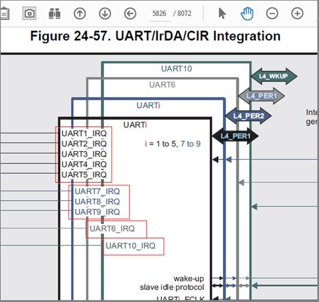

AM5728: About UAR Setting Issue
Part Number: AM5728
Hi Sir
We used AM5728 with latest SDK.
1. We would like to enable 10 UARTs at the same time
2. We found there are some issues
       in below table, it would have some problems if we open second UART port (ex: Uart1 and UART5) in the same block.
        if we change the second uart in different block, it can work.at the same time. And it can open max 4 uarts at the same time in below table.
if we want to open ten uart ports at the same time.
please advise how to do ?
if it cannot meet, what is the limitation ?
what is the suggestion how to use ten uart ports at the same time.
BR
Yimin

  • Hi SIr
    refer to above Figure 24-57. We did some experiment and found some phenomenons.
    We can enable second uart in the same block ( ex: uart1 and uart5). But we have to closed first uart and open the another uart.
    It seems we cannot enable them at the same time.
    BTW, error message is attached
    ==>>> UART 1, 5, 7, 10 open at the same time: NG
    ==>>> UART 1, 7, 9, 10 open at the same time: OK
