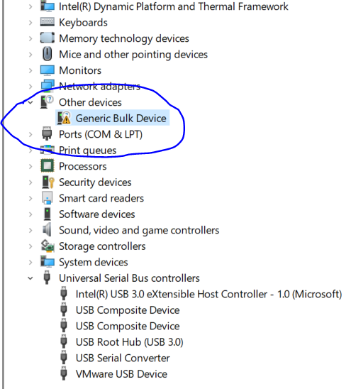

  • Hi Garrett,
         To use USB on A15 usb_arm_am572x_evm.cfg is being used and am able to perform USB bulk transfer, but on Linux host. Windows 10  showing some driver problem, see below attach pic for reference.
    In addition to this should be have cfg file for M4. as of now am taking usb_dra7xx.cfg as a reference, but not able to execute same thing on M4 core what am able to do on A15. Application stuck somewhere while detecting USB. Is there any USB related configuration need to be done in cfg file.
    Can I have some application note how to write own application specific cfg file on desired core .
    Geek13
    We don't have an application note to specifically explain the cfg file, but there are many examples in the PDK that you can refer to, for example, uart_m4_evmAM572x.cfg under packages\ti\drv\uart\test\am572x\m4\bios
    In order to enable USB to M4, it should not be just a update of cfg/makefile file, as I mentioned above, you might need dig into the driver code and try to identify as core or compiler specific implementations.
