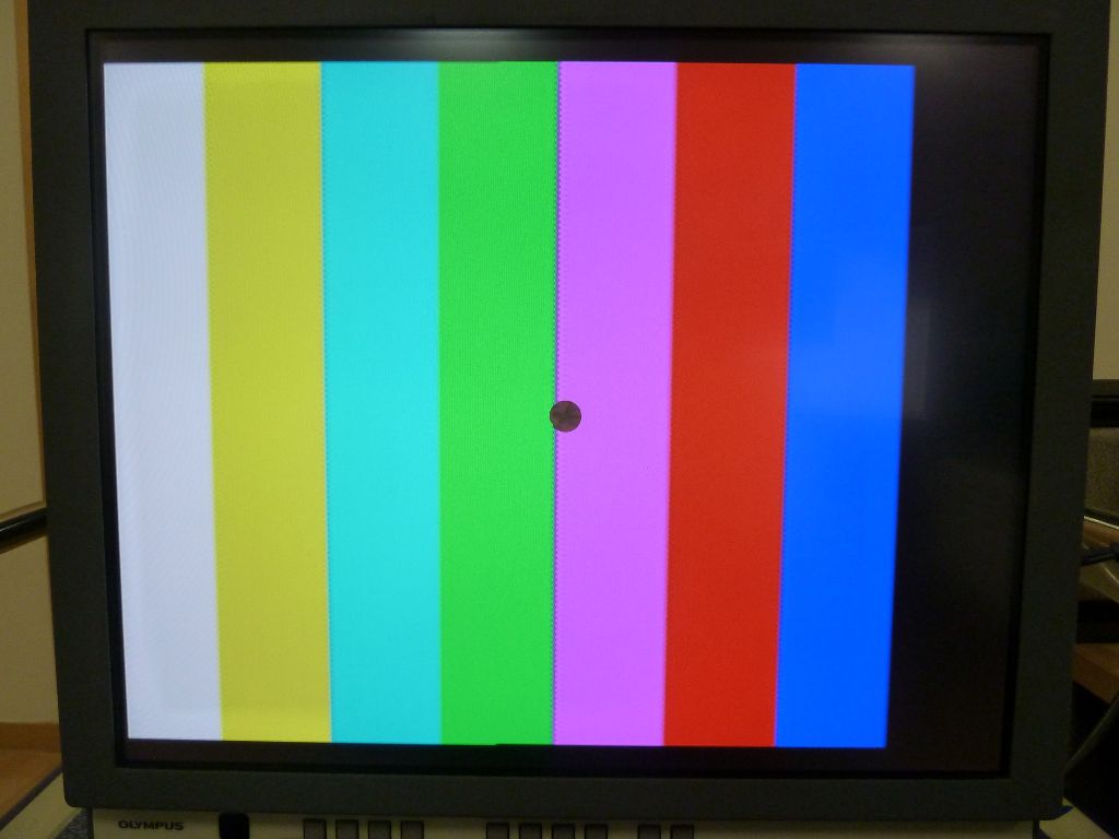

We have found the DM365 NTSC 480i Composite Video Output has 6 white lines in the bottom.
We are running v4l2 loopback mmap demo application under dvsdk 2.10/MVL5, input from composite NTSC 480i signal via tvp5146, output composite NTSC 480i signal to CVBS output. There is no processing between capture and display. Just loopback.
We figured out it's 6 lines using scope. Since it's interlaced video, it's actually 3 lines from odd field and 3 lines from even field so combined together it looks like 6 white line. The data value in these lines are replaced by 1 so they appear fully white.
Normal LCD TV will not show it due to the overscan feature built-in. However we use medical monitor with overscan disabled so they become visible.
Attached please see the original picture and dm365 output picture.
We have checked the drivers. The vpbe timing are all correct. It displays 720x480 without problem. The data are indeed 720x480. Just the pixel data in bottom lines are wiped out by white. There are no error message either. Everything looks normal. vpfe internally use YCBCR, UYVY format.
Currently has no clue about what is the problem? Anyone seems this before? I guess only Ti can help since we are probably the only one who use medical grade monitor without overscan.
  • Input CVBS NTSC 480i video signal, no white lines in bottom.
  • Loopback output of CVBS NTSC 480i video signal from DM365, white lines in bottom:

  • yes, i use red color 1 pixel border. it shows border on top, left, and right. bottom are the same white bar...

  • Thank you for your reply Marko.
    For below code, if I increase the upper_margin by 2 pixels, there is white line of 2 pixels on top, the bottom 6 pixels white line is reduced to 4 pixels.
    If I decrease the upper_margin by 2 pixels, the top looks ok but the bottom white line becomes 8 pixels.
    I have also checked the data capture from capture buffer, the data is correct, there is no white line in the bottom for the captured data. So it looks like the problem is still display or VPBE.

    basically the white bar problem has nothing to do with application. the white bar appears on black screen during kernel bootup, seems as soon as davincifb is loaded (but i am really not sure about this).
  • Does the red top line appear at the very top of the display?
    If so, then it looks like the image might be being cropped when it is sent to the display for some reason.
    I am not too familiar with the 365's display sub-system programming, so don't know exactly which registers to check to make sure that the driver is setting the heights correctly.
    Likewise, I don't know anything about the uimage code, so I will need to defer on that.
    I will see if I can find the correct registers to check for you.
    BR,
    Steve
  • yes the red top line appear at the very top of the display. it's indeed like image is cropped. i have checked top margin, left margin, specially enc.vvalid, vvalida..they are all set correct.
    i believe it's quite easy to reproduce on DVEVM. no need to run any application or connect any video input. just set bootargs to 720x480 for osd0, connect the composite video output from DVEVM to a TV (without overscan), during bootup, you will see the bottom white line on black screen.

  • after many experiments, the white lines are still there...
    in past few weeks, we have added support for DVI output. the hardware design is same as leopard dm365 DVI board, using TFP410 encoder. our encoder driver is similar as leopard DVI driver too. from the DVI 480P output, the picture is perfect. there is NO white lines.
    so the problem seems to be in the VPBE...

  • So, I turned on the internal color bars, and the white lines are NOT present...so, this verifies that (most) VENC settings are okay, and that timing is okay...It seems to point to either corrupted buffers, bug in OSD module (when disabled, etc.?)...or some mis-programmed register in OSD module.
    I know my data buffers are okay as when I send them output the IP interface all data is good..no white lines...

    WHY must we configure ANY offset??  We are losing information/data on our CVBS display...(which anyone will see when using a monitor capable of UNDERSCAN, which is common in surveillance applications)...
    So, basically, we capture 480 lines of information, however, we only get 480-16 on our display due to having to set this offset...if it is left at 0 we get a white bar at the TOP of the display, instead of at the bottom...so, VENC is only clocking our 480-16 lines...OSD_BASE_PY only determines where the WHITE lines are displayed...top/bottom, or half and half...
  • So, we are not losing any data...I put a one line colored bar at top and bottom of my buffers, and I can see both...the white bars are in the VBI area..
    If you configure the software to use  ROM_CLUT1, instead of ROM_CLUT0, the VBI area will be black, as expected.
